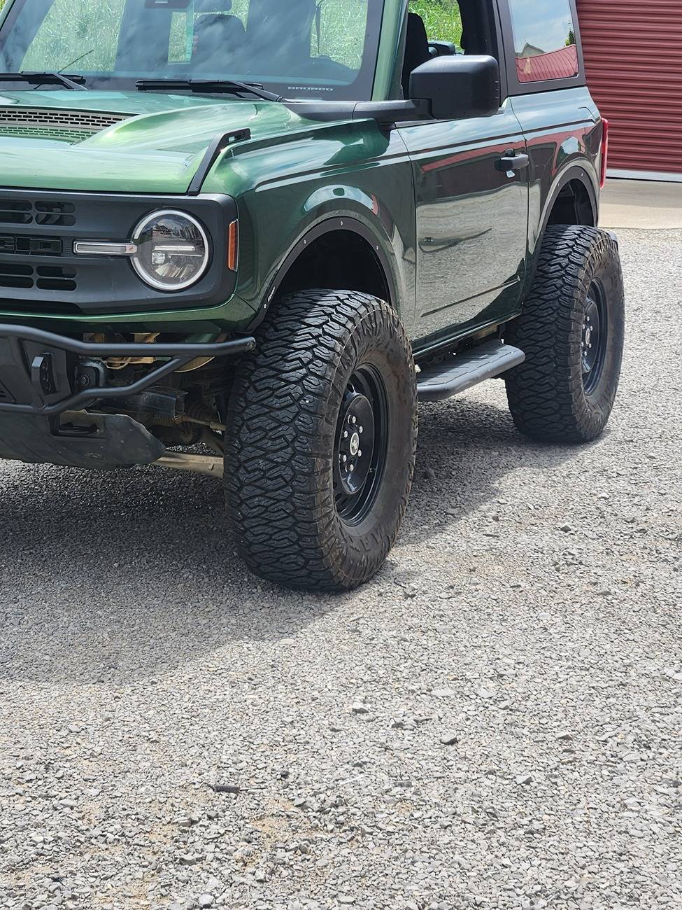

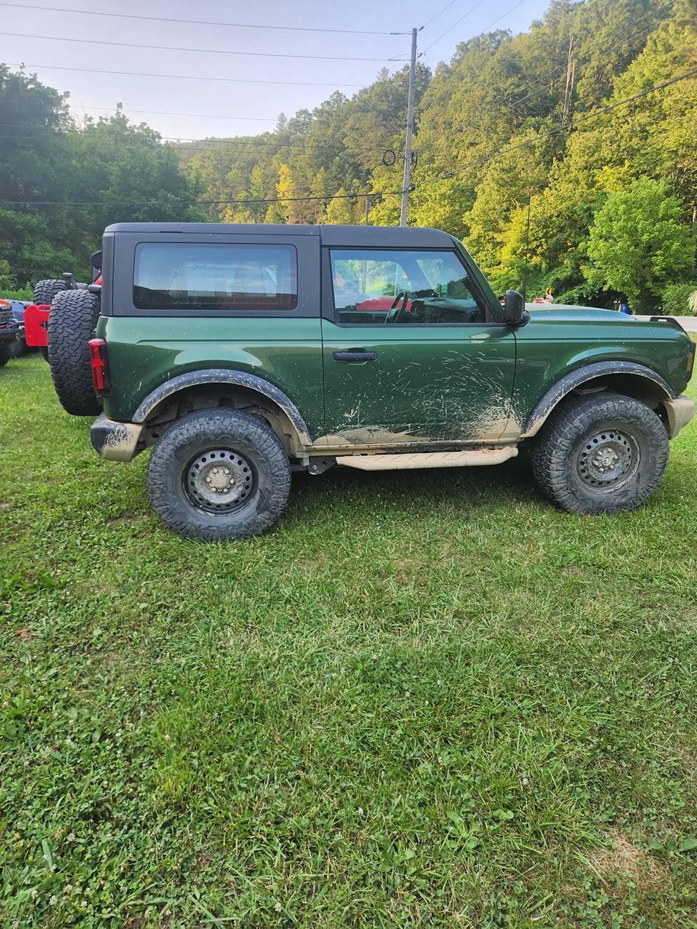

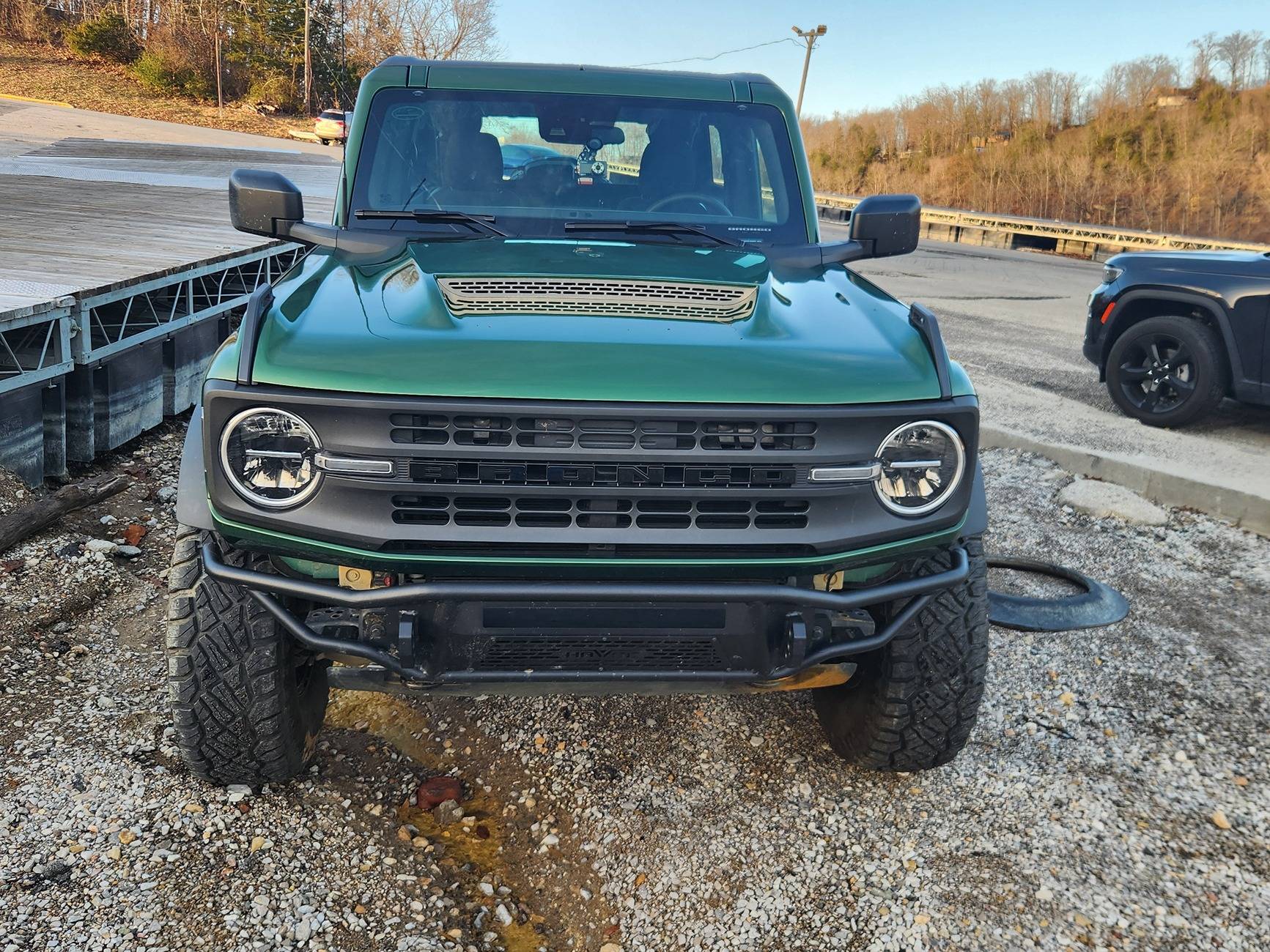

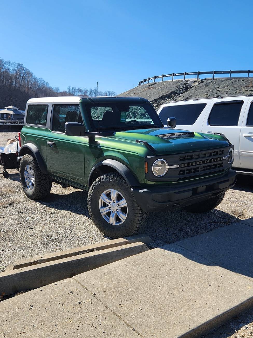

35 or 37 s 2 in lift the 37s are terramax rt this is my base7 speed . you can do a10.50 or a 11.50 on a steely.up a 37 37s you will need a 2 in lift and a 1.5 wheel spacer . you do not need a lift to run 35
Confirmed.
In my daily street driving , they never rub unless I am at full lock and hit the curb at the end of my driveway ... or the mall parking lot ....

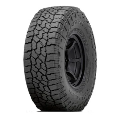

Apparently the 255/85-16's @ 33.1" are getting some love from the manufacturers because I NEVER had that size pop up at Tiresize.com , tirerack etc, when looking through everything they list. Nothing worth a dang anyways.
There are two Wildpeaks available now.
, a MT (E rated) and the new AT4 .... in a C Load Range !!!
HEAVY though ...
WildPeak A/T4W 255/85R16 Tire Specs
SizeDiameterWidthRim
Range
Measured
Rim
Tread
Depth
Load
Range
Max
Load
Max
psi
Max
Speed
WeightSidewall
Letters
Revs/Mile
LT255/85R16
112/109S C BSW
33.1"10.3"6.5-8"7"17/32"C - 6 ply2470/2270 lbs50 psi112 mph58.4 lbsBlack633

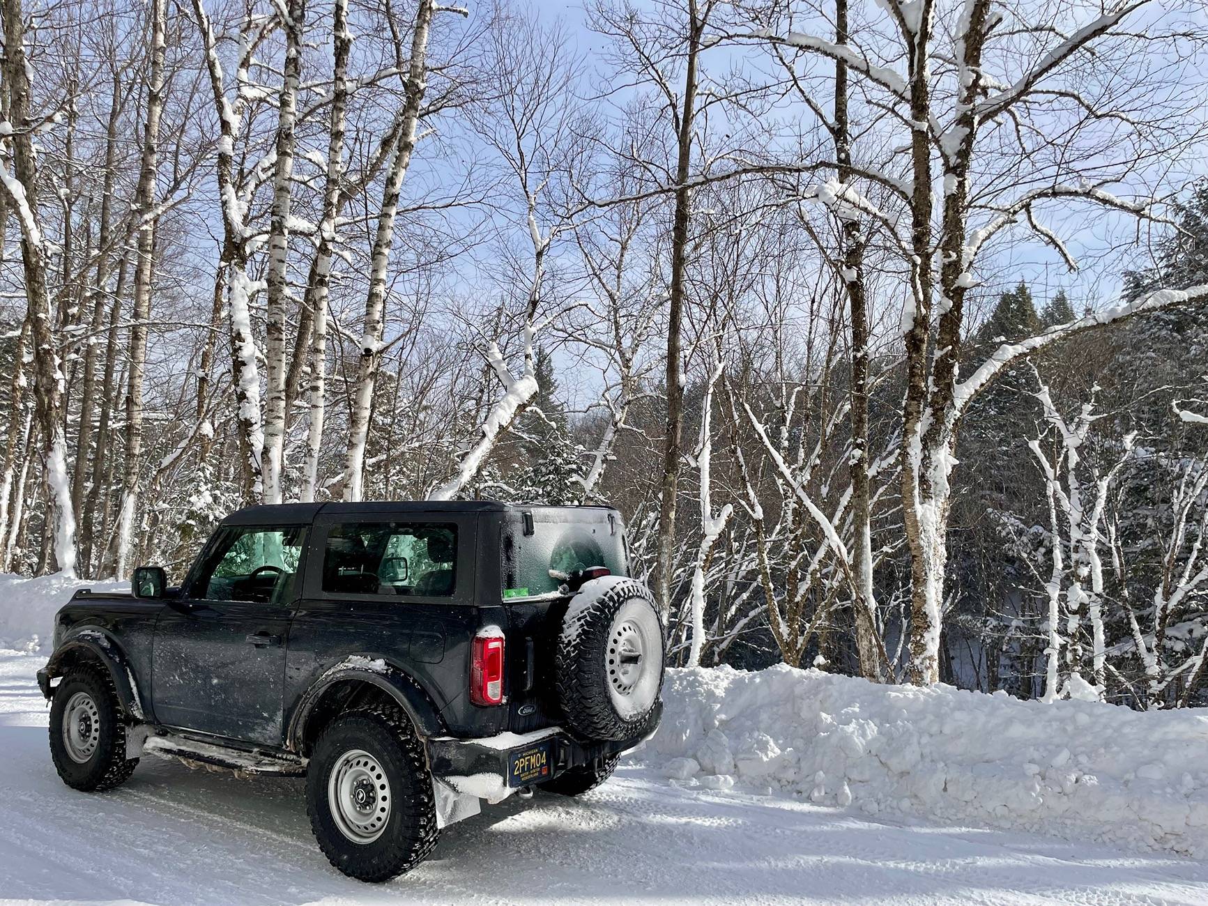

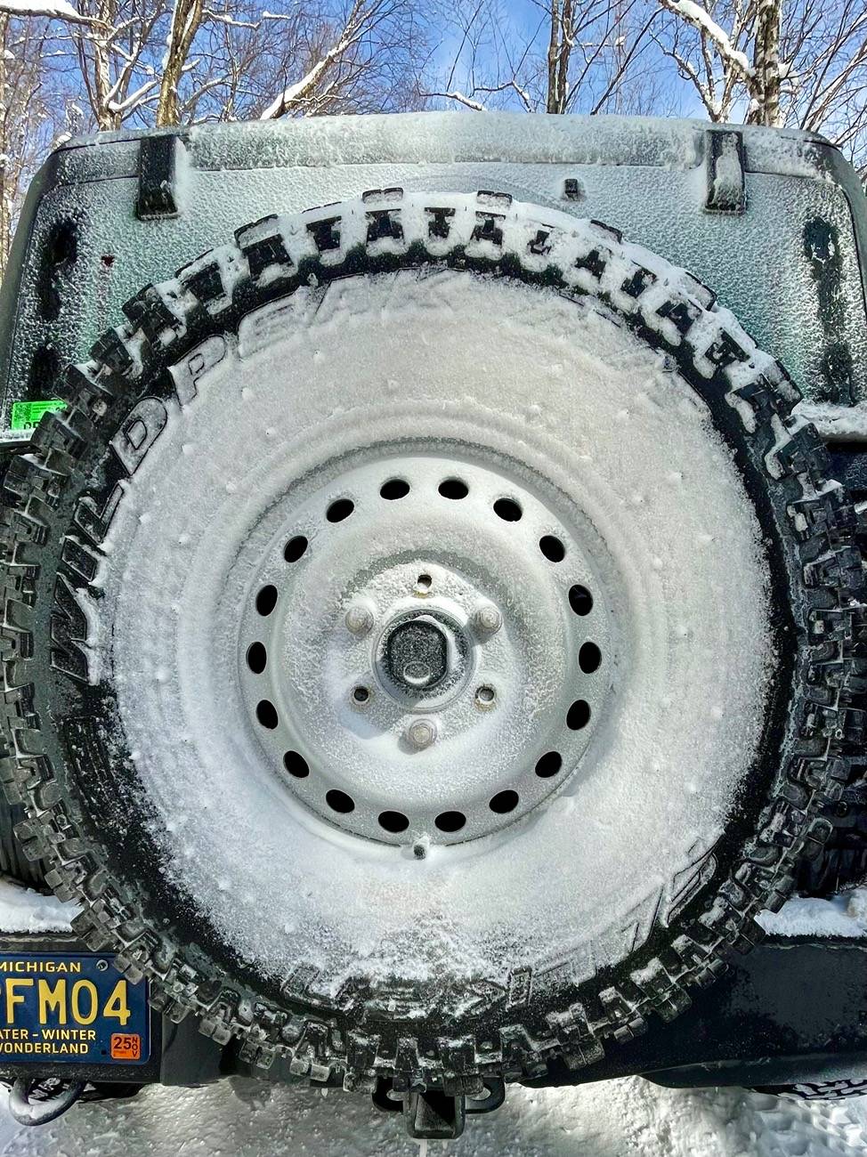

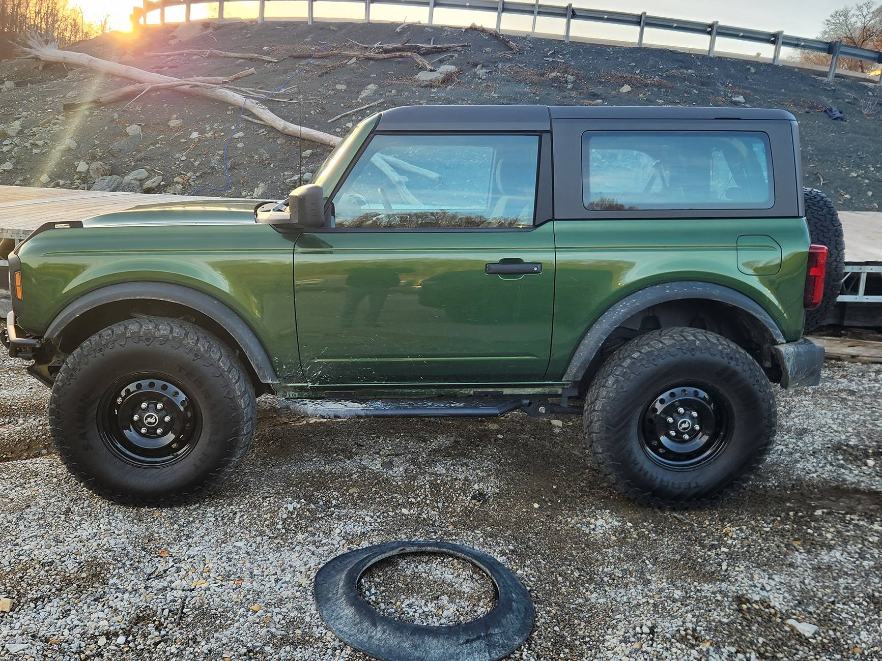

Just got back from a road trip with 20ish hours total driving on roads packed with snow and ice like white glass. Freeway, city, winding country roads…a real mix. Winter storms the whole way up and back from Detroit to Marquette. The Wildpeak M/T didn’t disappoint. At this point I’ll replace this set with the same thing in ~20k miles.

Nice looking rig with those larger tires on the steelies. Looks real nice.
