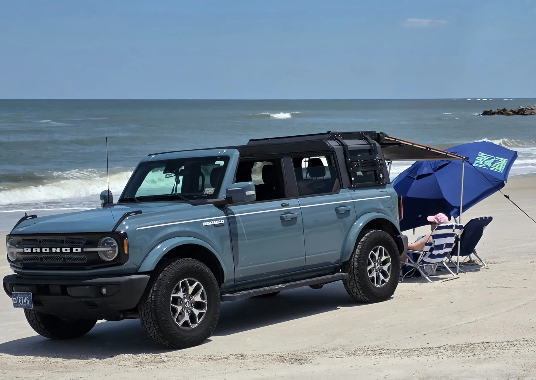

The nicest tire upsize without breaking the bank or needing modification is what I've had on my non-SAS OBX for 3 years: 17x8 Badlands Take-offs wheels with a 285/70R17 tire, "33's, which adds almost an inch of height. A nice road/trail tire is Nitto Nomad Grappler (i have, photo below) or perhaps Nitto's new G3.
My Nomad Grapplers are wearing out, so I'm going with Micky Thompson AT on some take-off Heritage Sasquatch wheels, 17x8.5. Then a mild coilover lift in my 5th year. The OEM Hitachi are getting rough, time for an upgrade. The advantage of the takeoffs is they fit as OEM wheels, and the price is right as Take-offs ($100-125 per wheel cash). I always go pickup in person, cash only.

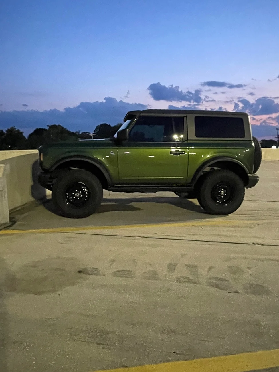

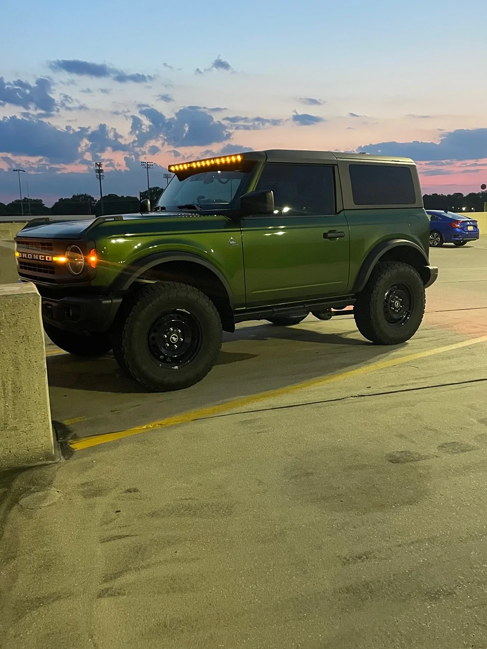

I can’t tell any difference on the ride and not much difference in noise either I did remove the crash bars before the tires. I have put a 2 inch spacer lift in front and 1 in the back looks better without the lift of your not doing much off roading I wouldn’t worry about any lift it will look good without it
That looks great. How's the ride quality and noise, especially on the highway?photos after the lift

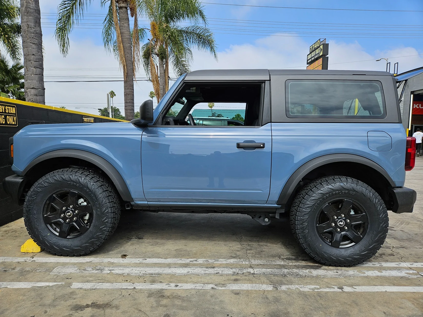

Well I finally decided--LT285/75/17 (load C) it is. Looks a lot better. Now I had stockish tires before and to be honest these LT tires do ride firmer and you can really feel the road with these tires, especially on rough pavement. Maybe too much. Not an uncomfortable ride but it is definitely firmer like a sports car. Better handling and less brake dive though which is good. Took it offroad hard pack dirt and ruts and it is rough. It may be the stock Hitachi shocks. but going slow I was dipping back and forth in the ruts and the hits were harder than before with the nonLT tires. Currently at 34psi cold.
Maybe that's just the way it is and if so then fine. Otherwise, not sure if it's a tire thing or maybe I need to change out the suspension or maybe I just need to get used to it. Looking for a smoother on road ride since daily driver 95%/offroad 5% use.
Any suggestions or advise especially those with the base suspension who switched to larger LT tires greatly appreciated. Thanks!

lol I missed this message lol looks great!!!!👍

Yeah and if you do washboard roads or hard surfaces air down to like 20 psi
