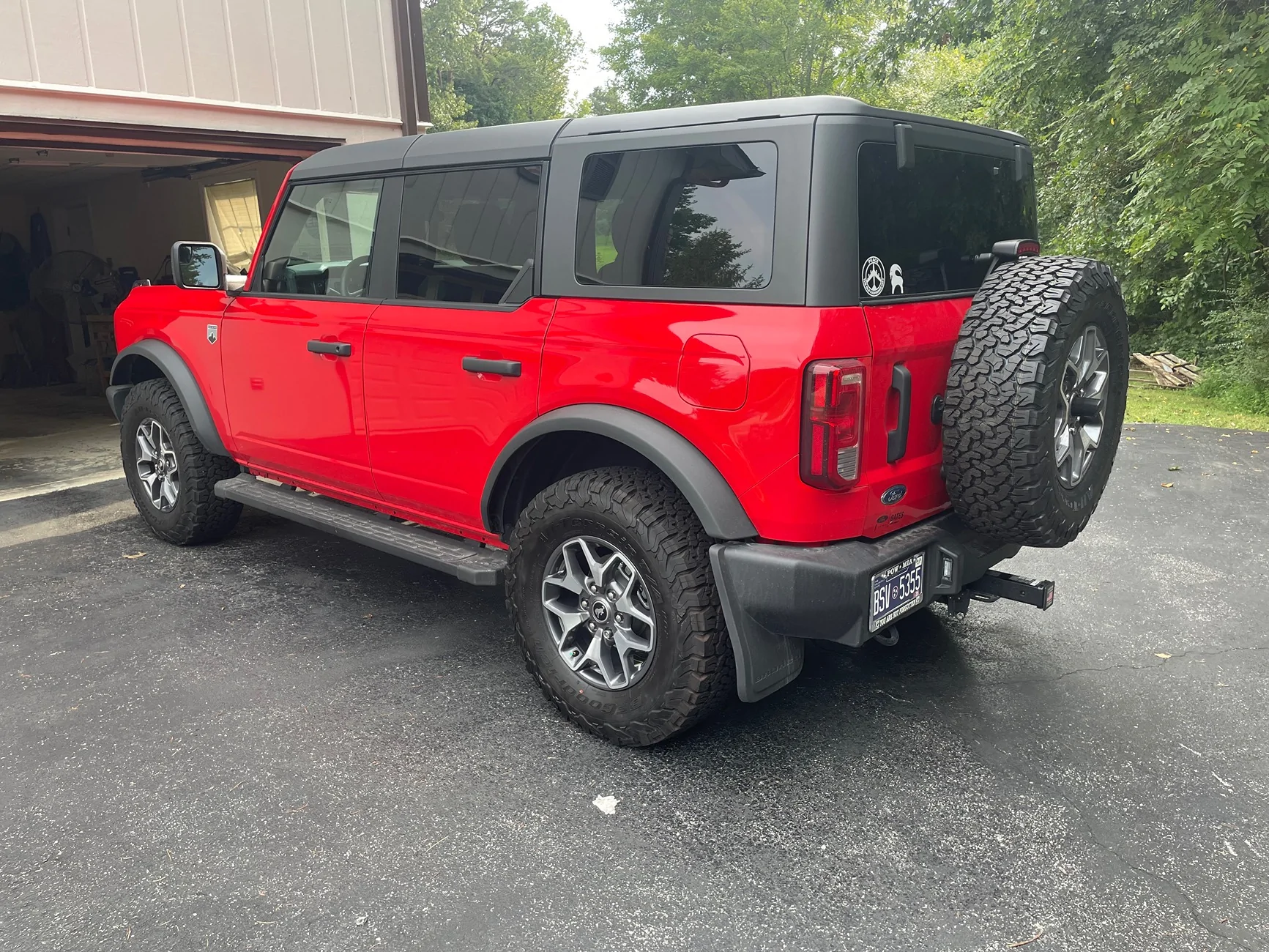

I just got these yesterday. They are 2025 Badlands takeoffs. K002 tires had 20 miles on them. Found on Facebook marketplace for a reasonable price for all5 with sensors included. I like the look and ride noise is good.
Ford Bronco 2025 Bronco OBX Tire Suggestions IMG_2317
Ford Bronco 2025 Bronco OBX Tire Suggestions IMG_2318
They are 285/70-17.

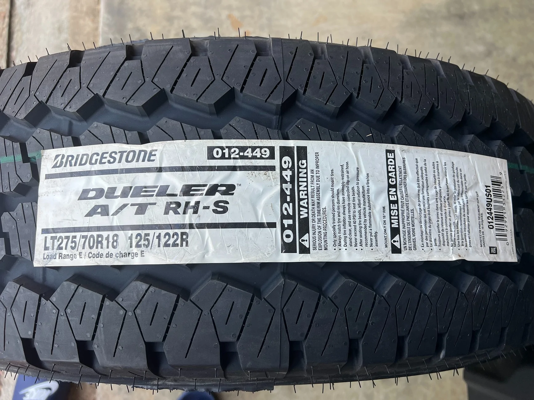

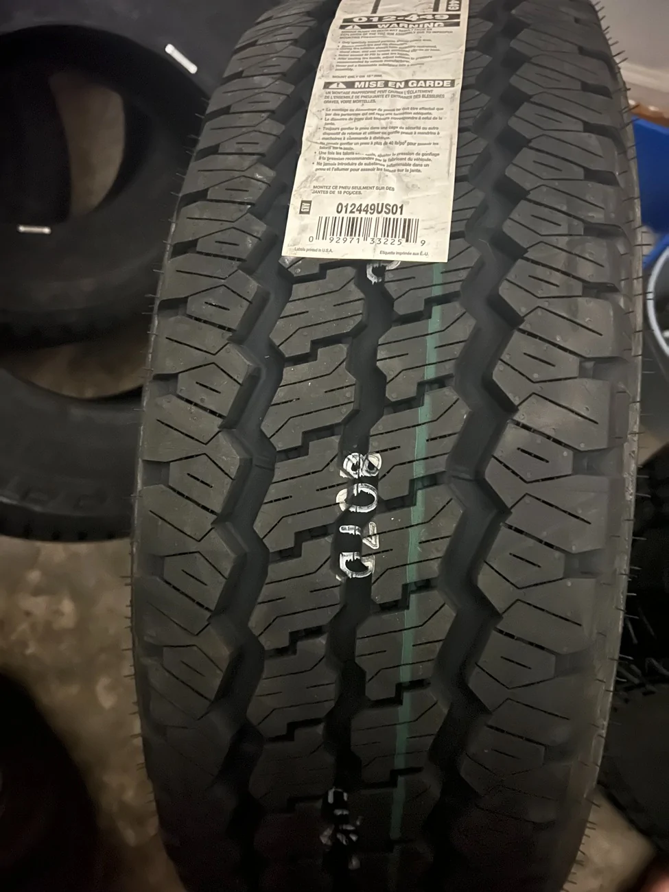

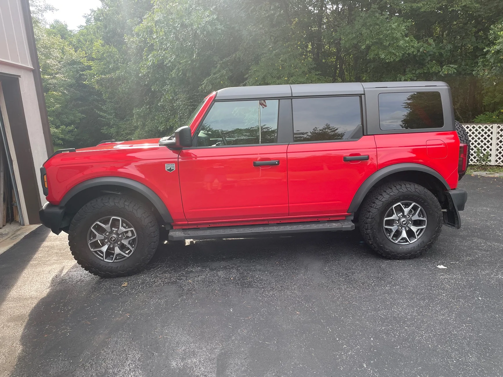

I was in the same situation. Mine is daily driver and I didn't want a super aggressive tread, but still capable. I did a ton of research and ended up with the 275/70r18 Bridgestone Dueler A/T-S. Oddly, it's the exact tire model of the factory 255 tires but the tread design is more open. I've got 10K miles on them and have been very happy. These are also the absolutely lightest load range E tires I could find in that size. 46lbs each. 33.2" tall.
Ford Bronco 2025 Bronco OBX Tire Suggestions IMG_1510
Ford Bronco 2025 Bronco OBX Tire Suggestions IMG_1502

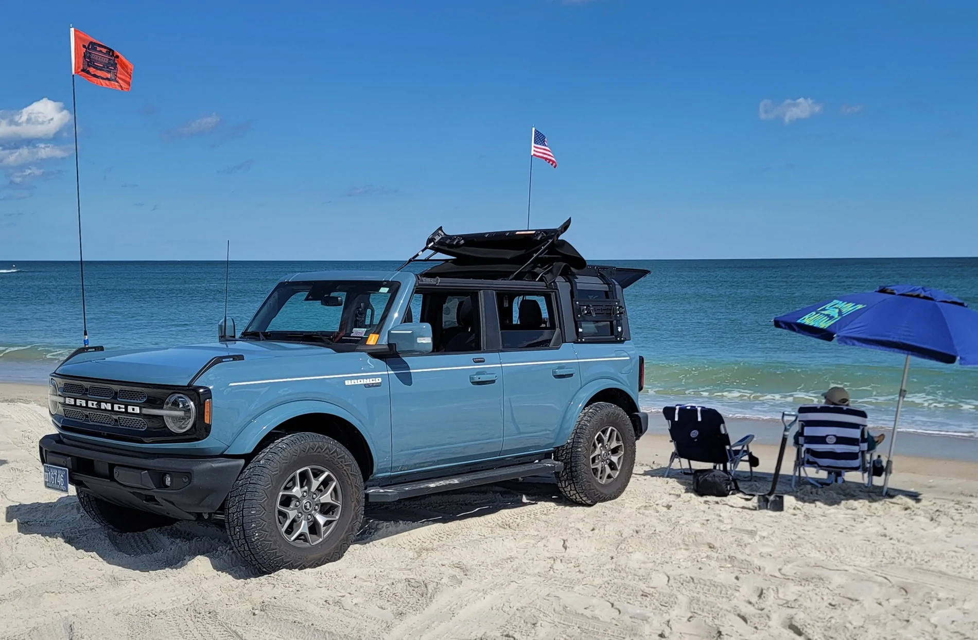

I now live in Coastal SC, and I bought a set of Badlands 8x17 wheels, with a set on 285/70R17 Nitto Nomad Grappler tires. Very quiet, taller & wider than stock, 33", no lift needed. Very nice for highway, road and beach. See photo. If you want something more aggressive, Mickey Thompson makes a set of these in "C" for lower weight or on "E" for greater durability. This 33" tire upgrade has been a great choice for me in comfortable driving.
Both the Nittos and MT are said to be good in snow, however, in the end, IME, it was always the ice that was the danger and the killer . . . And snow tread is not a help in ice. Compound rubber ice tires really do work, for 2-3 seasons, until you wear off the ice layer.
