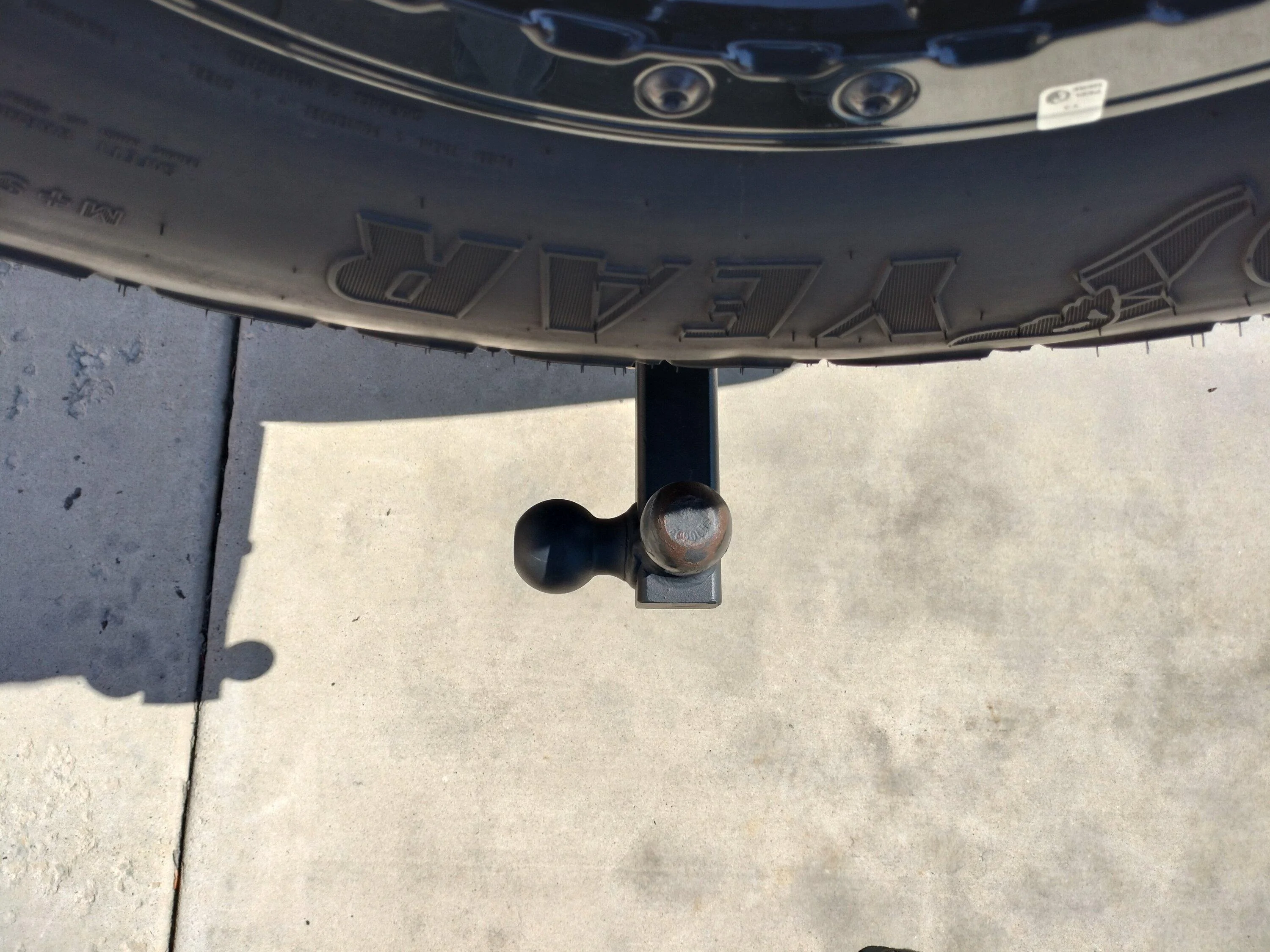

I have non-SAS Badlands with factory receiver hitch - bought a ball/receiver today and stuck it in and noticed how little clearance there is with my 33" KO2s. I'm upgrading to 35s. Is this a problem?
As you have seen by the responses ,You shouldn`t just buy a ball mount and hope for the best.
The proper way is to know how high the trailer that you are going to tow is in comparison to your hitch receiver and get a ball mount that will then have the trailer level when towing. And since you plan on bigger tires that will change it when you change them.

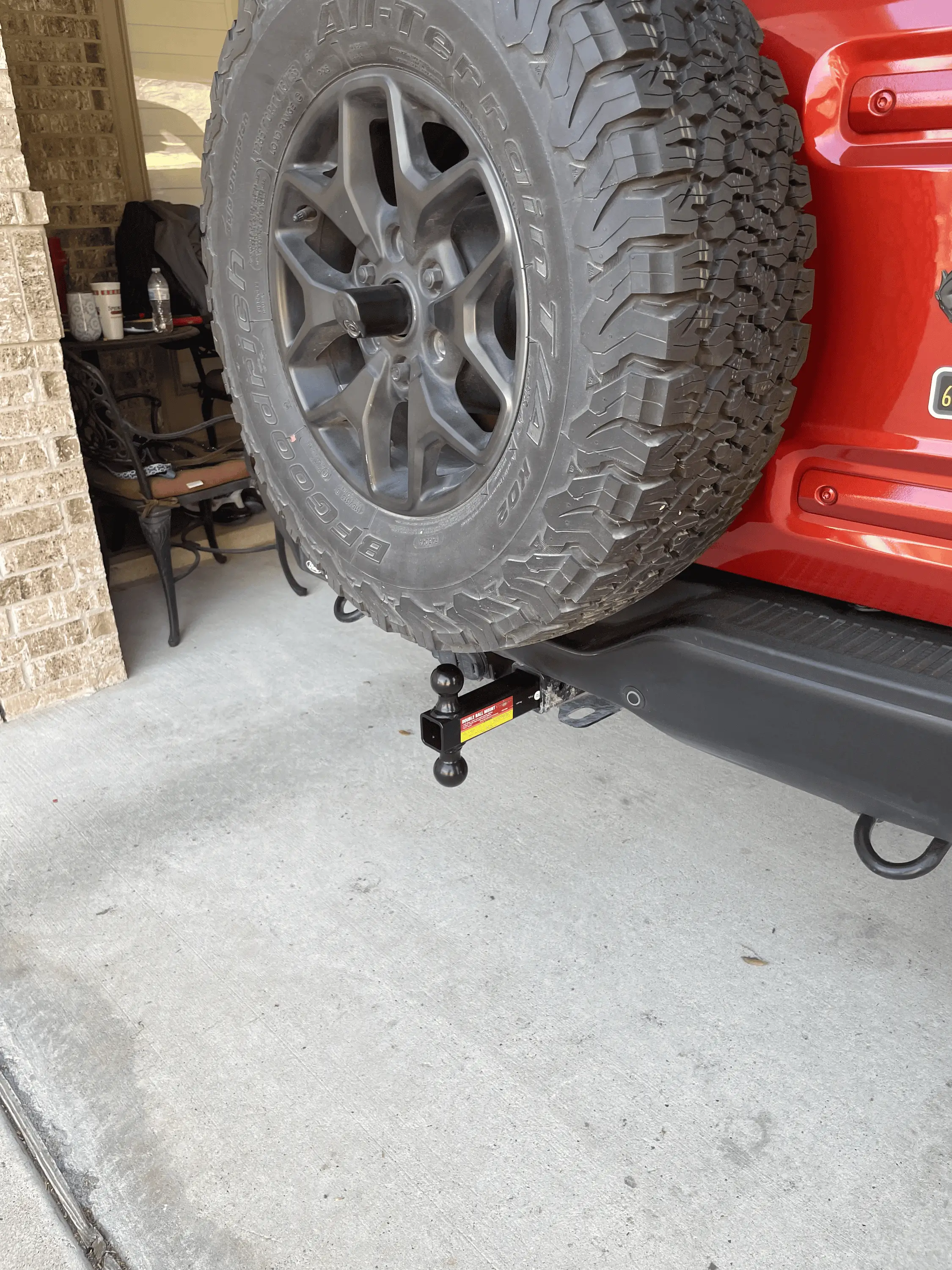

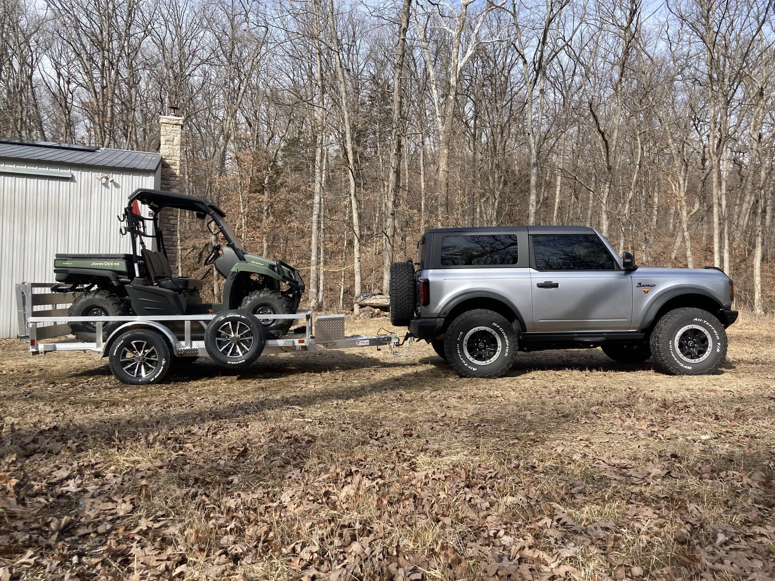

I bought a 4 1/2” drop and it works well. Those extensions put a lot more stress on the hitch.

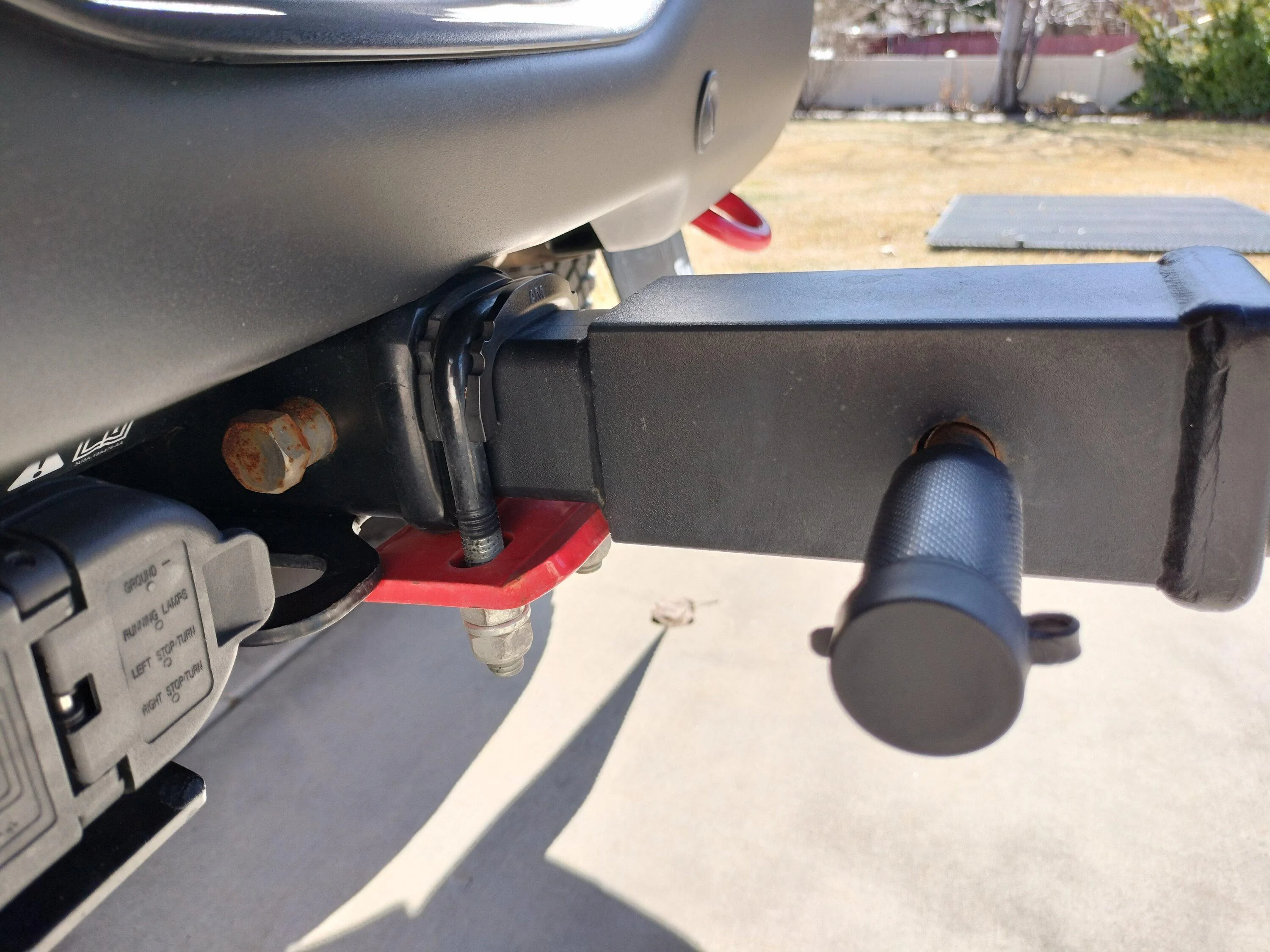

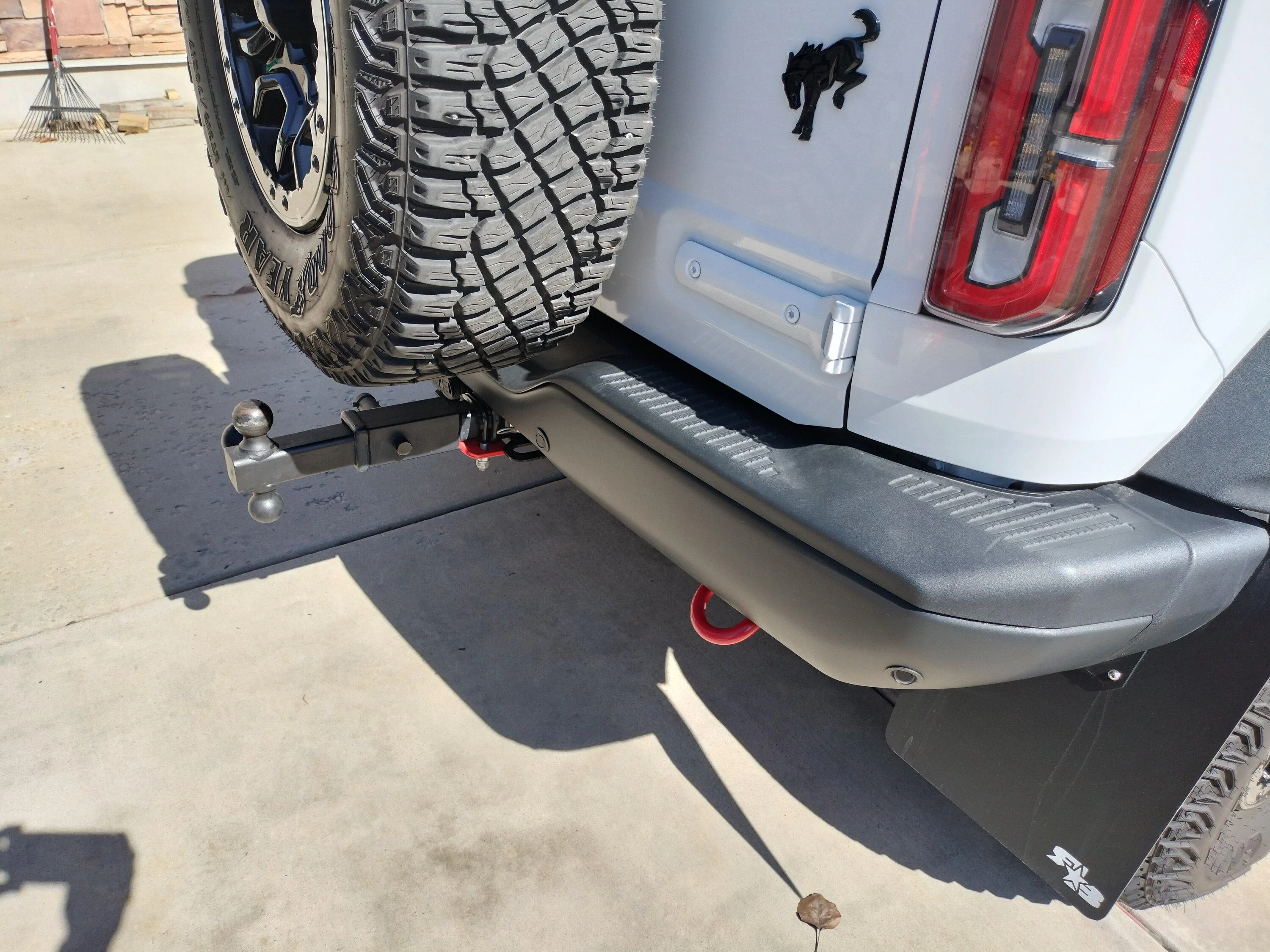

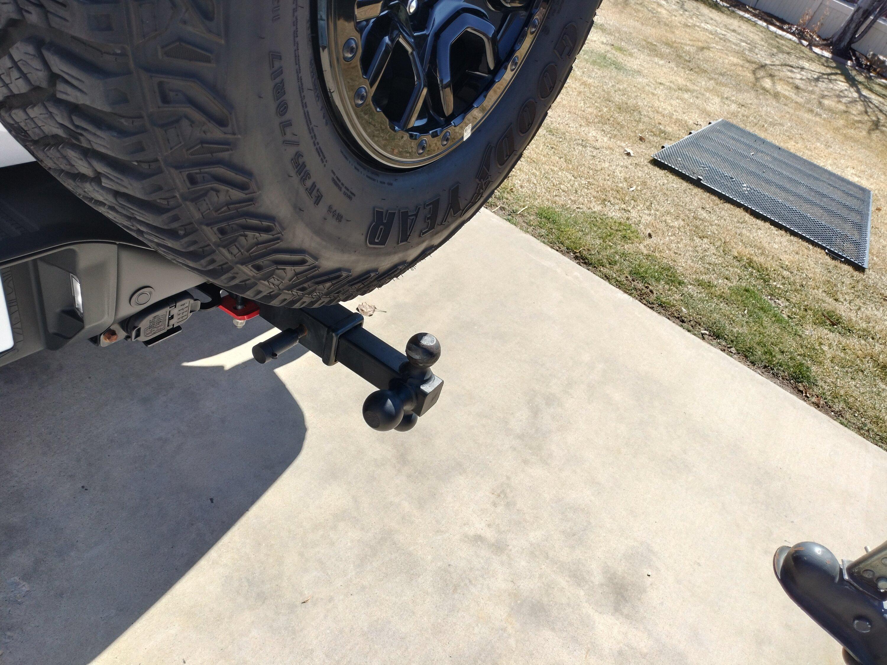

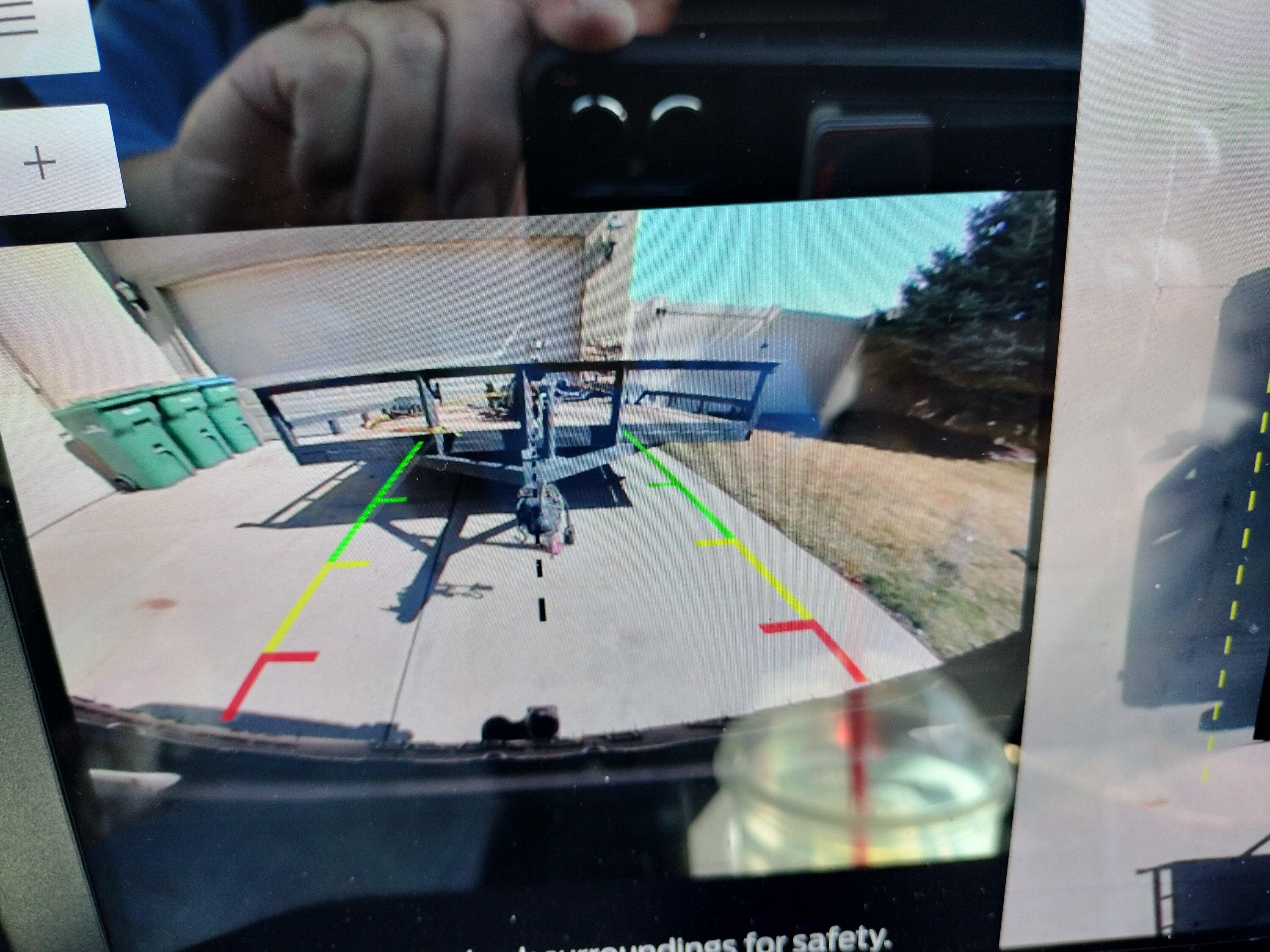

I had this same problem with 33's or 35's on. I purchased a 12" extension, it was too long. I returned it and went with a 8" extension. It is perfect. I will try and post a picture tomorrow. I also locked in the extension with a u-bolt plate lock. It sticks out just far enough for clearance to lock down the ball on the trailer. It also sticks out far enough that you can see the ball on your backup camera to line up with the tongue on the trailer. Doing this I did not have to do a drop. Which I did not want to have to do for regular clearance.
As a note when you do this you will have to remove them when you off-road for clearance on the back end.
