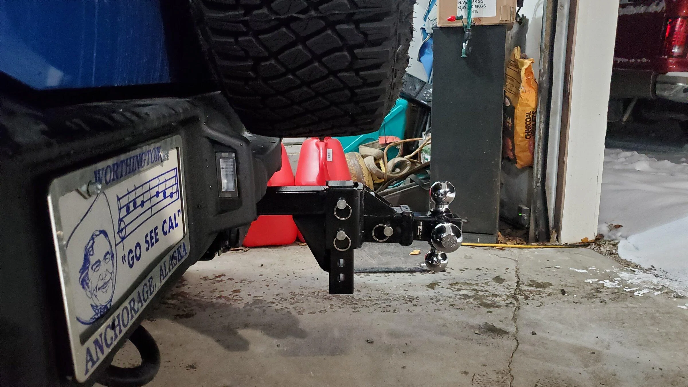

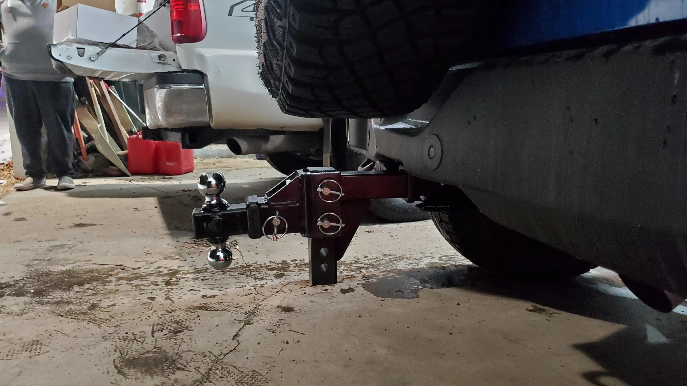

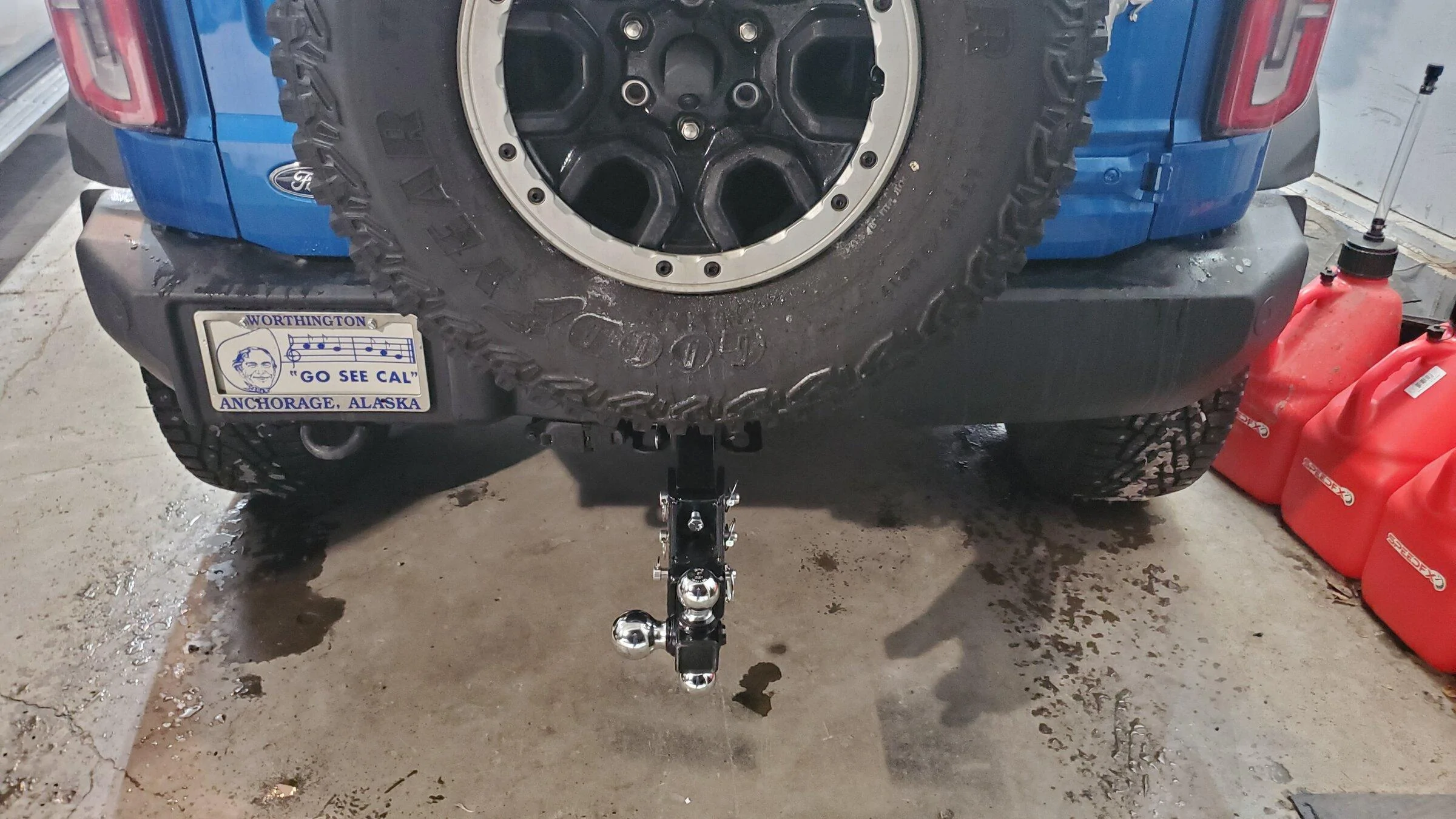

So I have a trucks that do most of my towing. But I'd like to haul my side by side with the Bronco. I knew some people had issues with clearance with the spare tire and this unit looked like it extended out a ways. I test fit it tonight and it cleared no problem on my Sasquatch 4dr.
Buyers part #
1802225
I'm not sure what retail would be on it, but I know it's much cheaper than the B&W I was looking at.

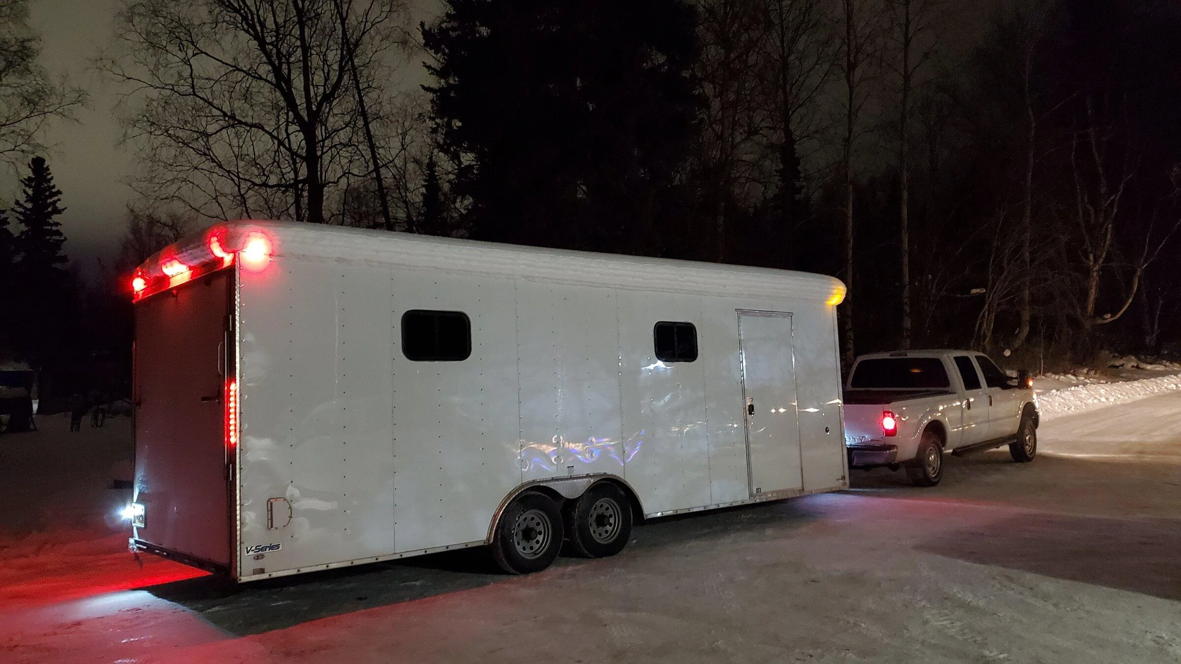

Finally tired it out with a trailer on the Bronco (I used it to haul a car trailer already) works great!

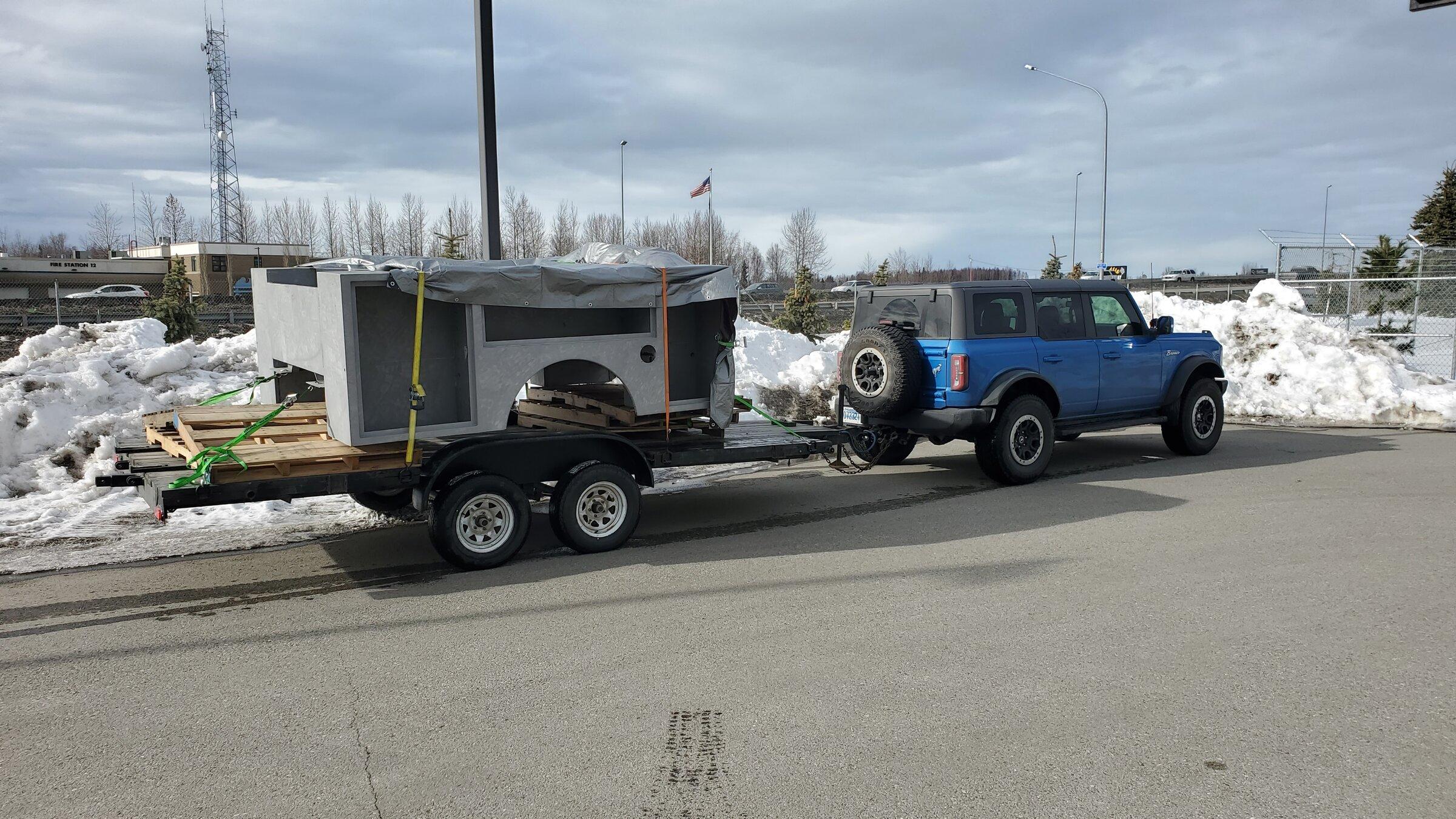

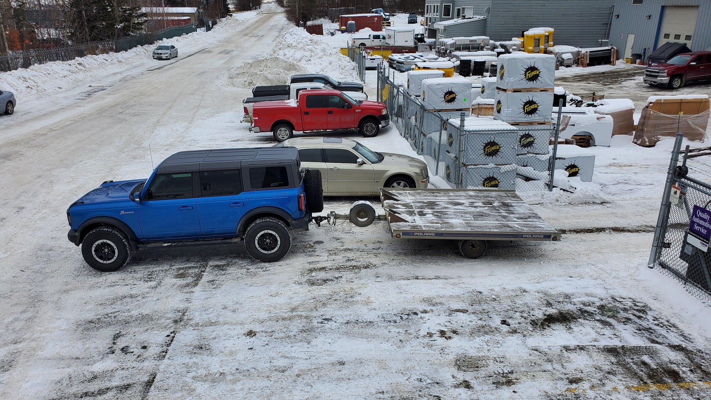

Hauled another trailer today, had to move a service body. Worked like a charm!

This hitch is rated at 10k lbs max, I towed my cargo trailer with a 4,500lbs car in it with this setup and it worked great for that also. I know people use much longer extensions with cab over campers and haul large boats, enclosed trailers..ect this length doesn't bother me. Especially considering the very light weight that will go behind the Bronco.
