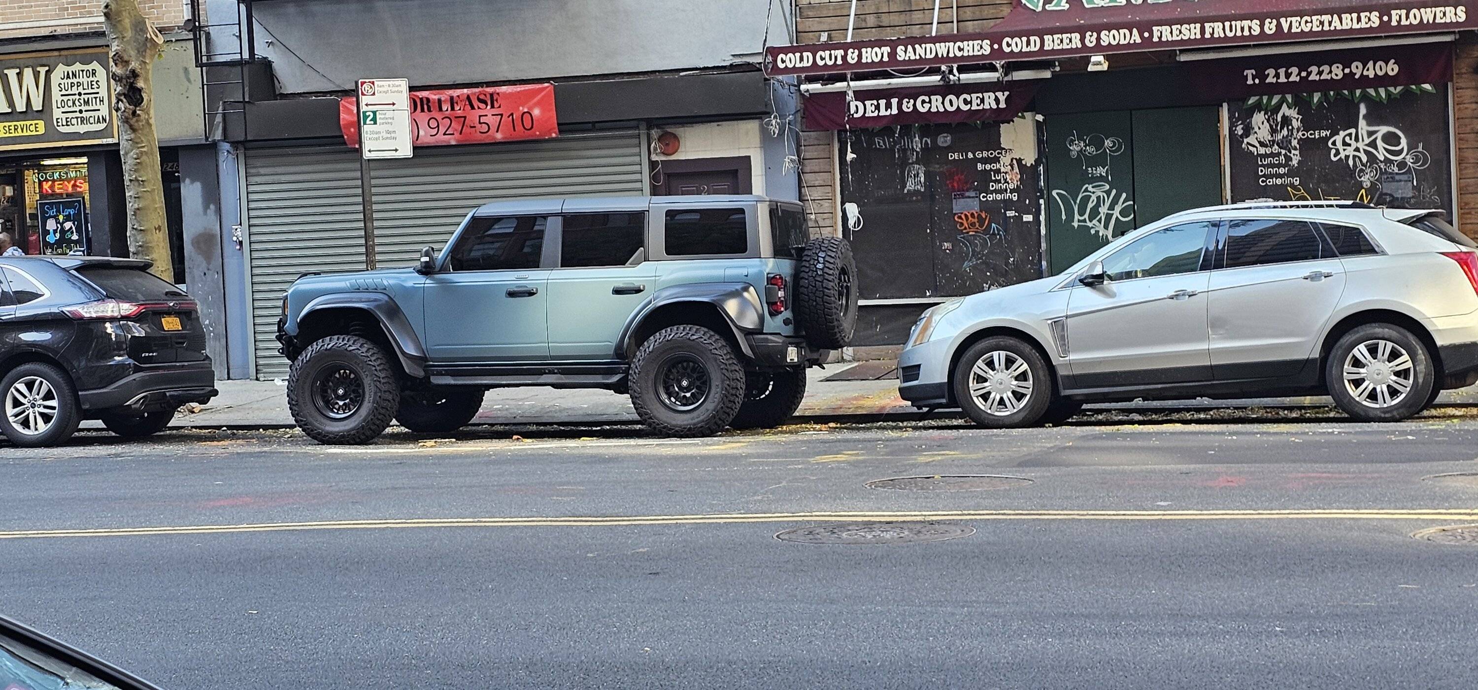

Bad squat with eibach springs
Bschurr
Jan 28, 2021
1,816
4,168
NY
This is the 2/2
Wasn't like this when initially installed a few months back! What can this be?
Do you have a lot of junk in you trunk?

Lets see pics from just after install......

Can't find the pics. But it was perfect level 3 months ago. In this past month my mpg dropped by 2mpg along with the squat.

Springs settle over time but it shouldn't be this much. What spring heights did you go with?

Have you reached out to Eibach?

Had this problem with ARB OME springs when I lifted my Rubicon. My suggestion is to reach out to Eibach. ARB sent me heavier springs no charge.
Question, do you have perch collars? Maybe the slipped in back?
