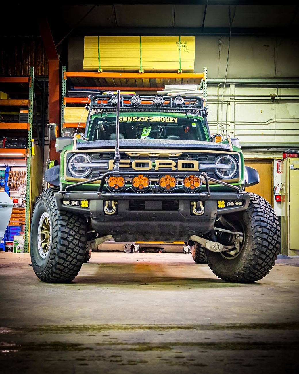

I have hyperco HDs at all four corners 2/2. Added the eclick system to control the Fox for towing.
Really happy with the results. Did 5k to KOH and back loaded and towing. No sag.

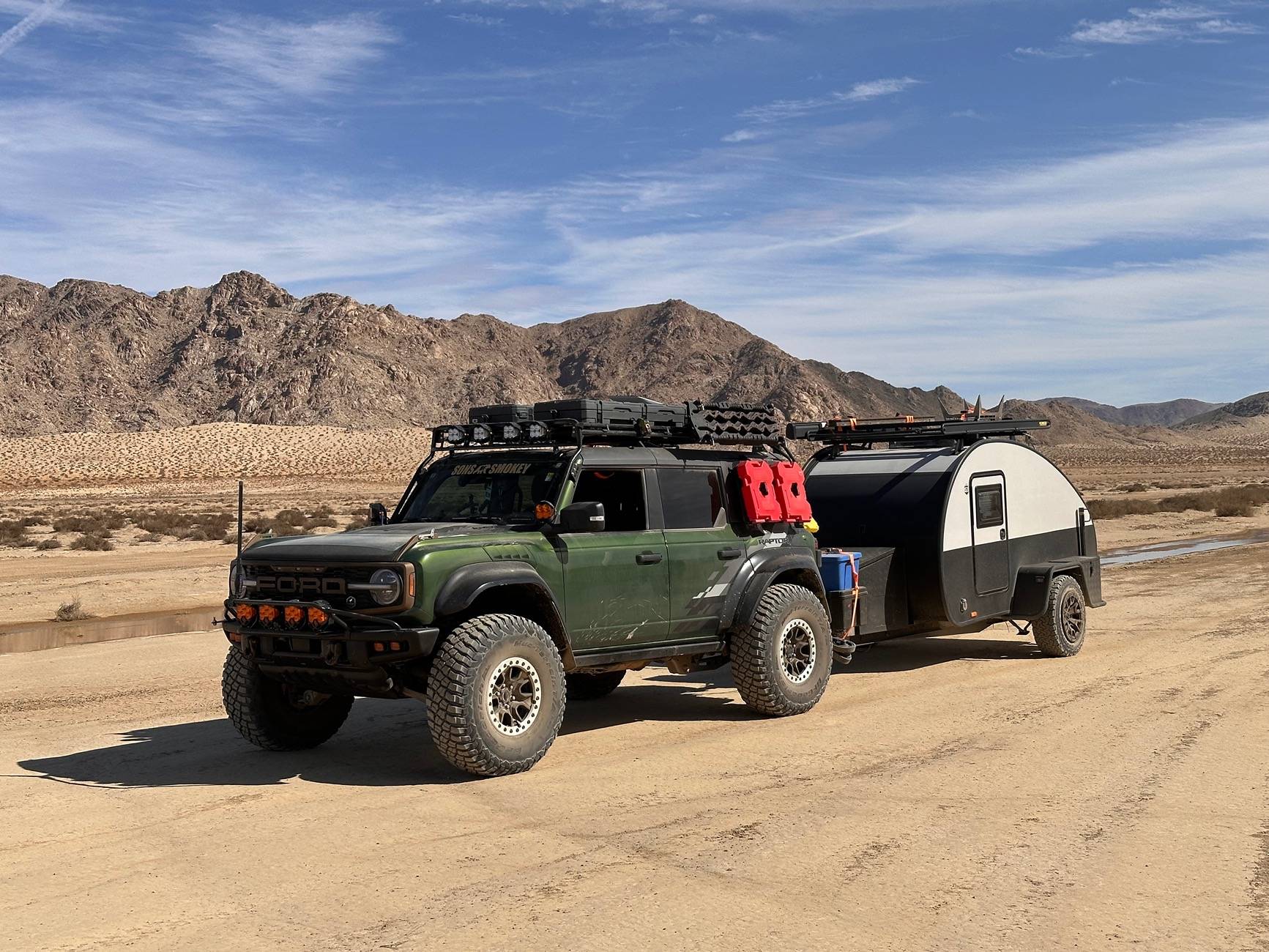

I have the hyperco HD 2’s all around. Couldnt be happier. Have 200+ lbs in the back zero sag on long trips. Sometimes even more weight when roam cases are loaded on my trailrax. Zero sag.
I plan to go to 38-39’s too so pretty stoked.

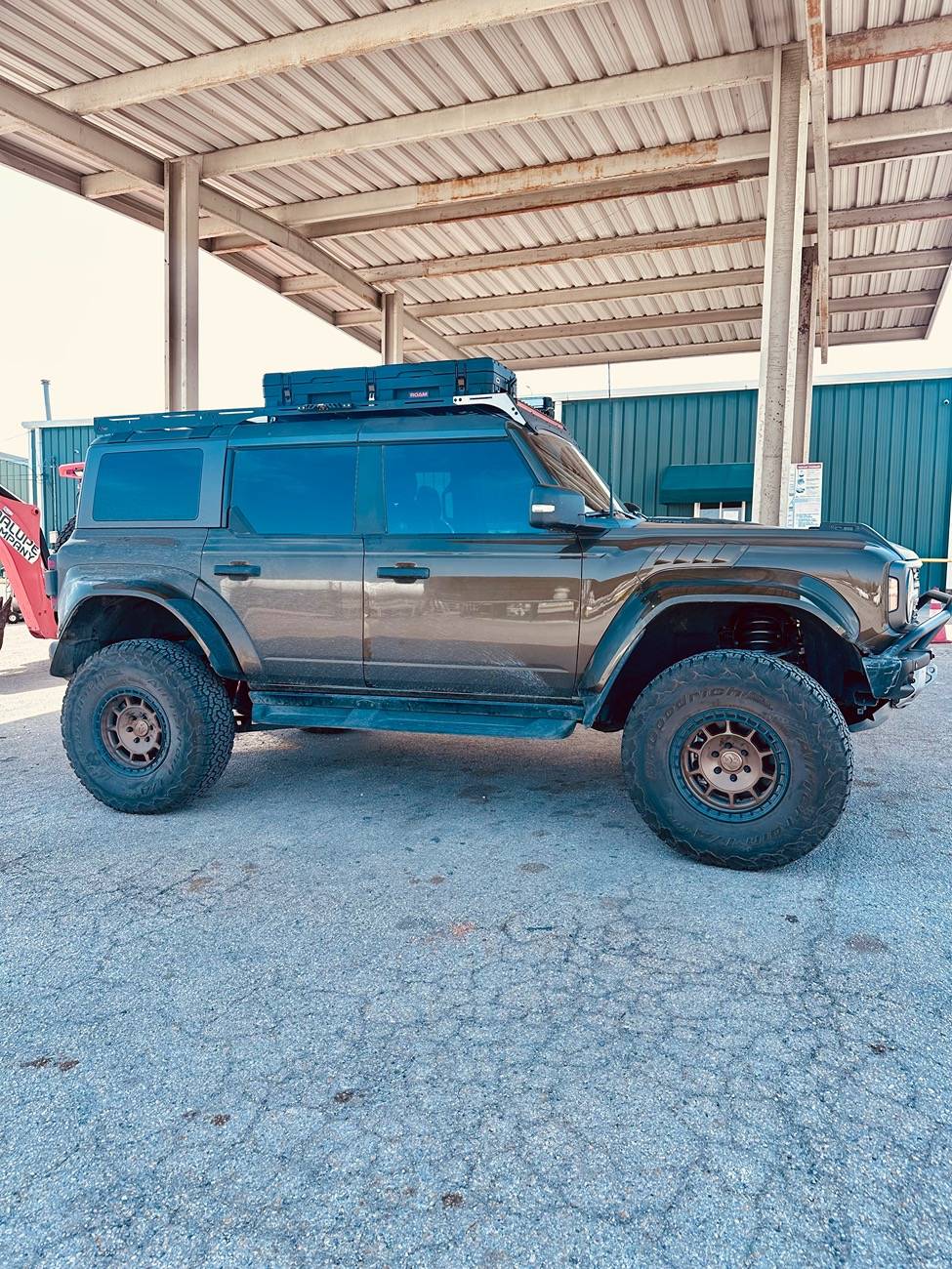

Even with a hitch extension, which you’ll need to clear the spare (unless you do a spare delete) you should have no problem hanging bikes off the back. I looked and the Super 73s aren’t heavy. With the extension, you probably have at least 225-275lbs weight you can hang off the back.
also, this is your stance on factory wheels with 1.5” spacers running 39” KM3s with 2” hypercos
Ford Bronco Help me with Hyperco Springs IMG_7141
