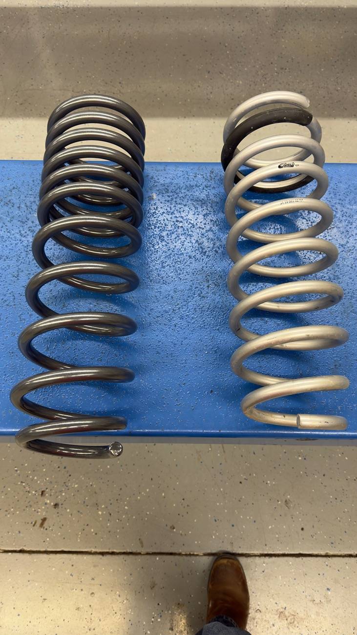

The problem is the Eicbachs are just way too soft in the rear. Any extra weight over stock will cause the rear to squat. I switched mine to the Hyperco HD and couldn’t be happier. Much better feel on and off road. Here’s a comparison of the two Hyperco on the left.
Ford Bronco Bad squat with eibach springs IMG_1070
Wouldn’t expect that from Eibach. The Hypers look really good.
Looks like the Hyperion are progressive while the Eibach are not…
