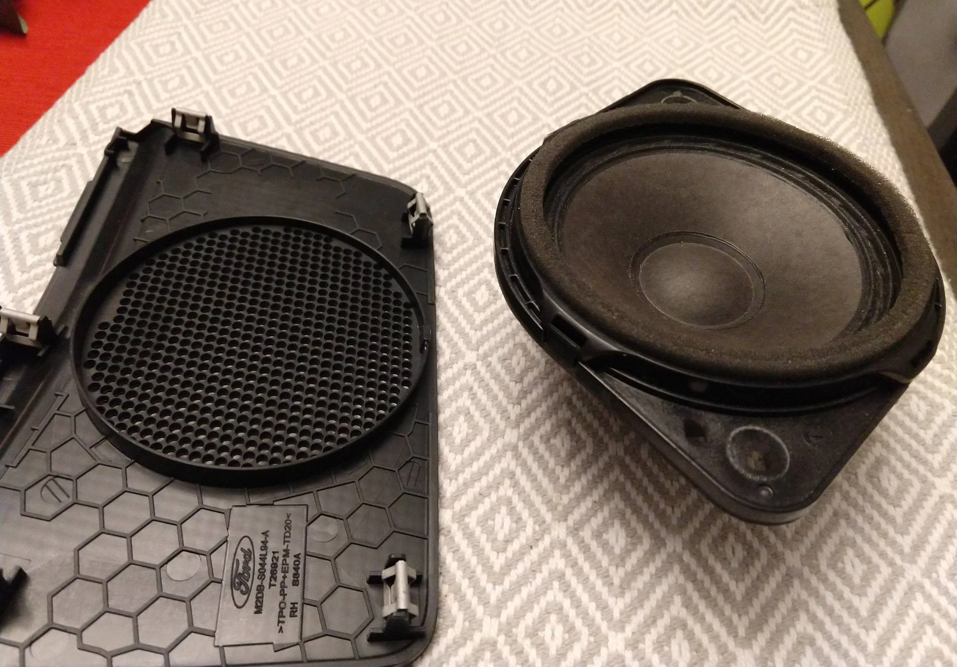

Not necessarily. If there was concern about rattling, Ford could have simply had a sufficient gap between speaker and grill, as occurs when some aftermarket speakers are installed. Are people having rattling issues with those?
Instead Ford added a downward protruding ridge to the grill and used a speaker with lip and foam to mate up. I think Ford was trying to contain the back sound waves as much as possible given the dash limitations, while directing the desired sound waves outward.
Nah. It's for rattling 100%. Plenty of manufacturers use foam around speakers that are mounted close enough to the grill that vibrations can be transferred under low frequecies. Foam is not used to conduct or direct sound waves as it can actually absorb them.

We'll have to disagree. Foam is in fact used to help seal speaker surfaces, including to help prevent back waves from mixing with front waves, and that's likely what Ford did with their design of the dash grills. In particular, it's why Ford added a ridge to the grill that protrudes down from the grill, mating with the speaker surround housing, using foam to seal that interface.
The stock speaker averages around 1/2" or so distance from the dash grills, so there is little danger of contacting the grill and causing vibration. Furthermore if dash grill vibration simply from sound waves was an issue, a lot of folks around here would currently be having grill vibration issues, as their aftermarket speakers no longer make contact with the grill via a foam surround.
Yeah we will definitely agree to disagree here.
