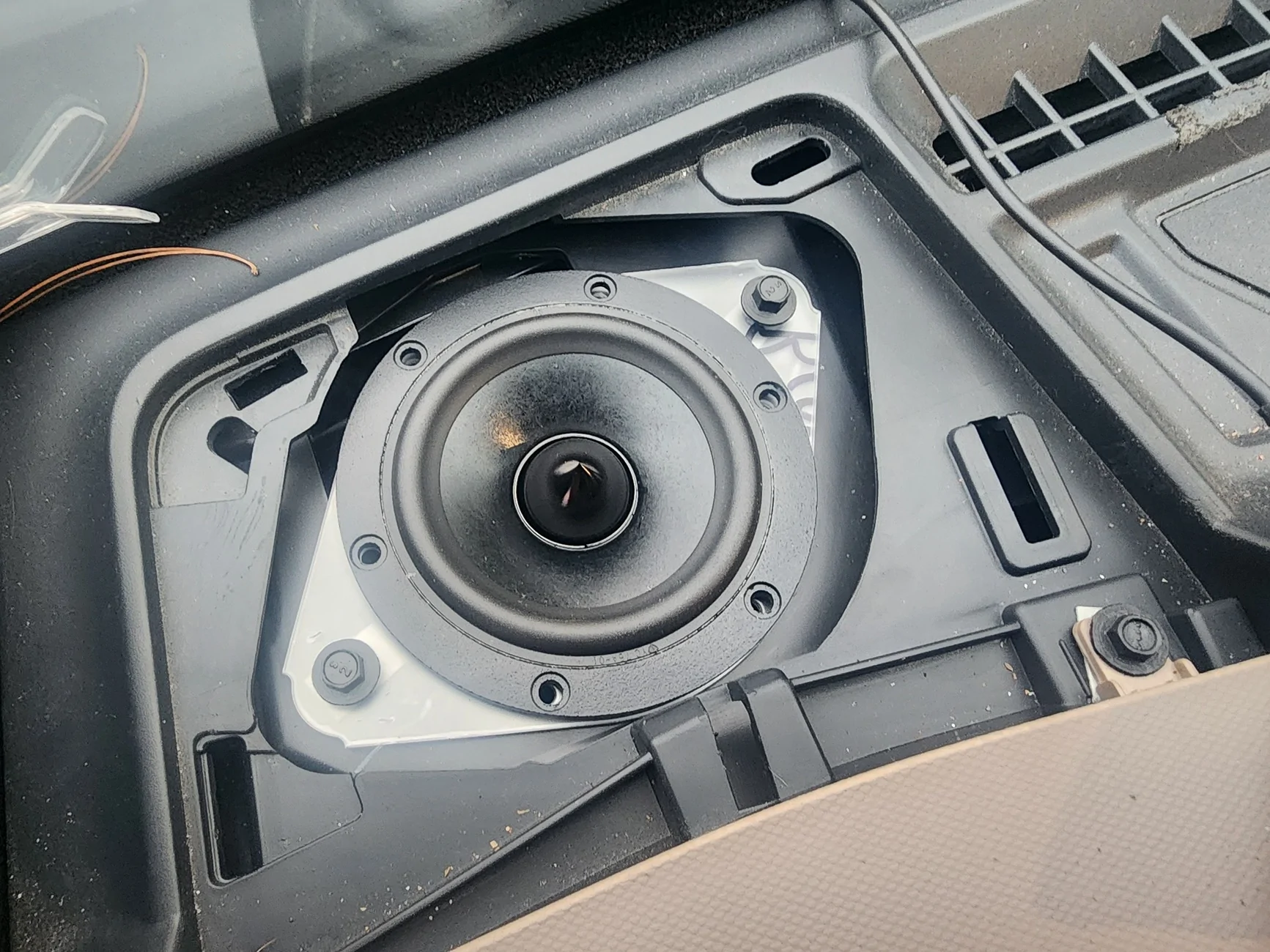

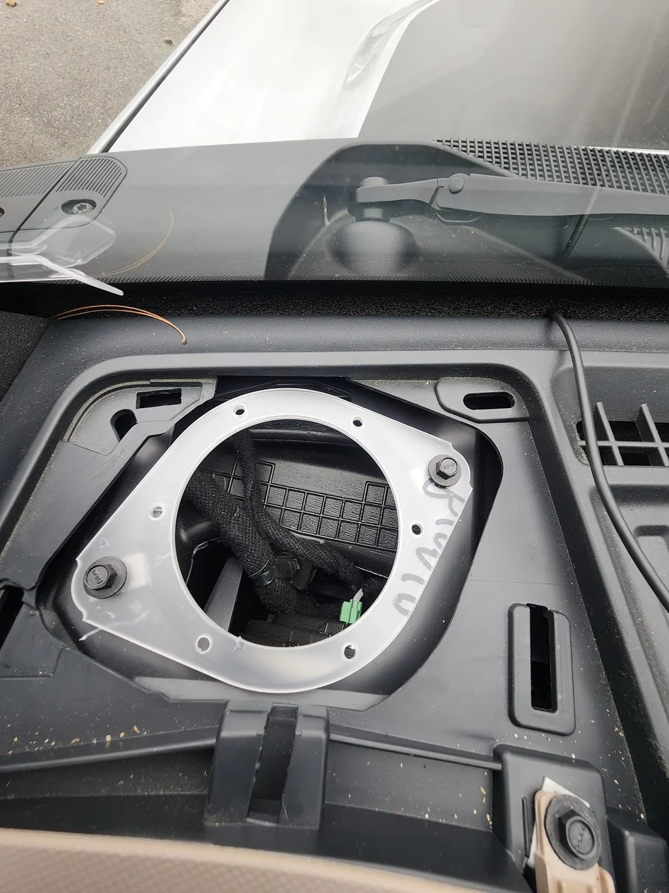

Update: I decided to go hard mode on myself last night and just measure using calipers and recreate the B&O dash speaker bracket manually in Adobe Illustrator. And I did it and confirmed the fitment to be good! Worked perfectly! I even routed out the holes for my new midrange speakers. Attached are PDFs of both a blank template and the template I used for my speakers! I cut these out of .030" 8010 Polycarbonate, but if I find that these are too flimsy, I'll end up routing it out of .060" 8010 polycarb.
The speakers I went with are Dayton Audio RS100P-4 4" Reference Paper Woofer 4 Ohm

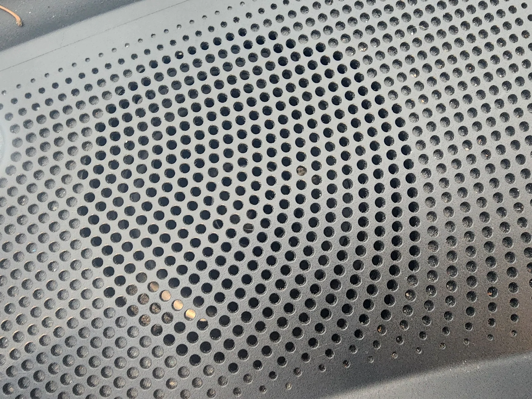

You can just barely see in the second pic that it's also perfectly centered with the circle in the speaker grille. :)

Since my job involves measuring customer chassis and creating vector files to create labels that fit on recessed parts of tools and things, I put my knowledge to use with the front dash speakers. I've attached a template I just made, using calipers to measure the factory speaker and Adobe Illustrator, that includes the shape and screw hole locations of the factory dash tweeters of the 2022 B&O system (not sure if it's the same for the 6 speaker system). I'm going to CNC route that template out with the right size hole for my 4" dash speakers that I got (Also attached). I couldn't find any templates that were just a flat cutout path, so I made my own! Feel free to use it and distribute as you please.
Before images of the dash speaker:
Here's my bracket with no speaker:
Here's the fit of it cut out with the speaker sitting in the plastic (dry-fit without bolts). I CNC cut the templates out of .030" 8010 polycarbonate. If I find that they're too flimsy, I'll route it out of .060" polycarb. (Using polycarb because it's readily available at work lol)
Hard to see, but it is indeed perfectly centered with the circle in the grille! And best part is, no trimming required of the bronco other than snapping off the two little alignment tabs where the screw holes are. Just a drop-in speaker replacement now. Aside from the wiring of course.
