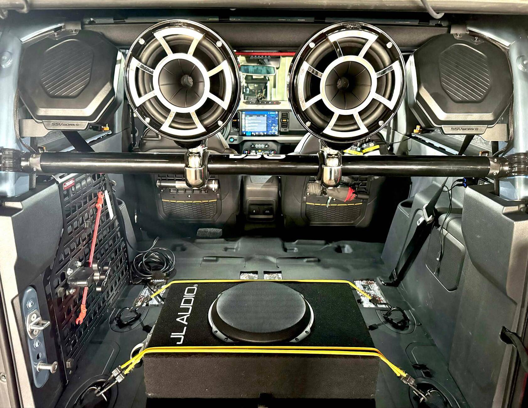

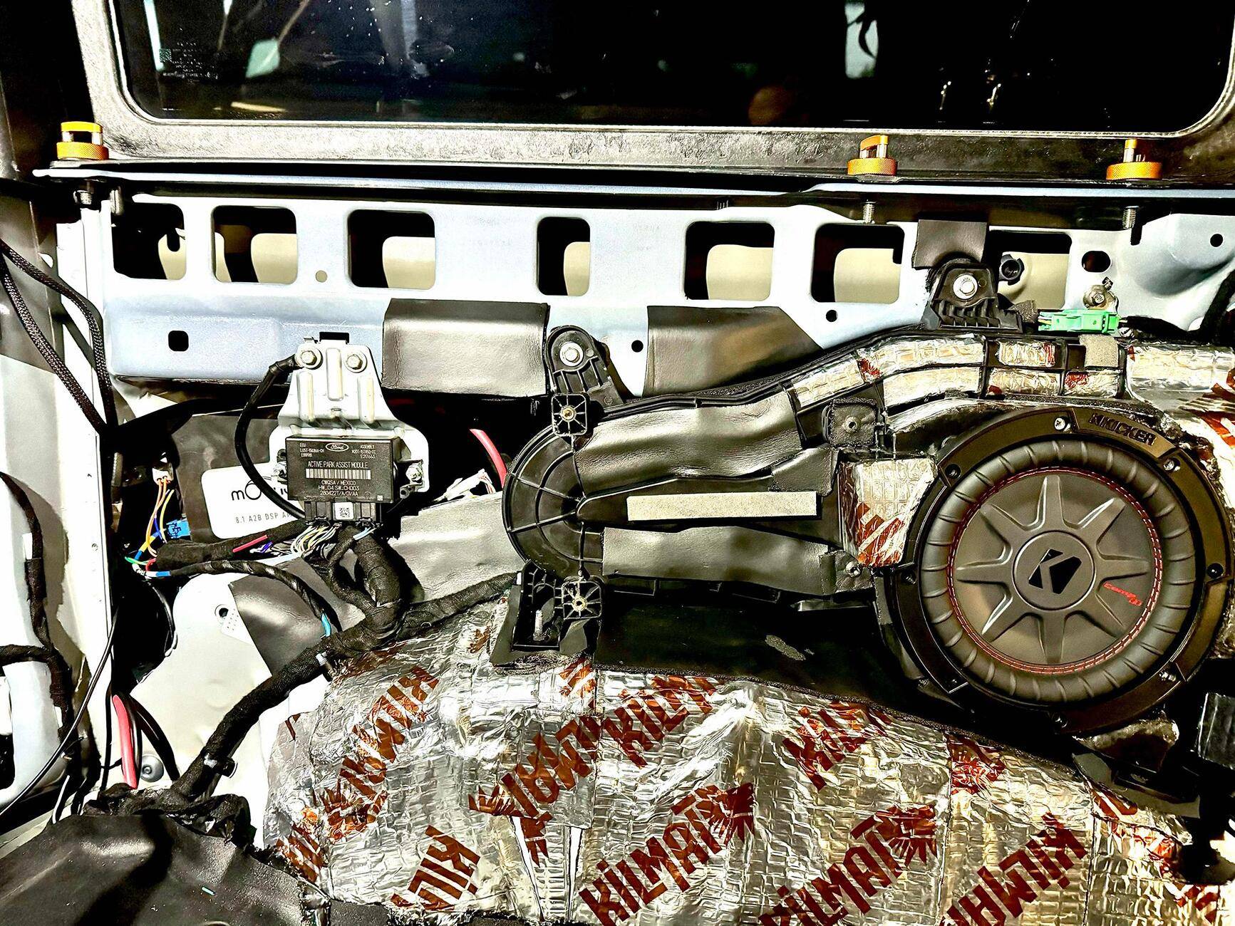

I started with replacing the dash with Focals and the kickers with JL, replaced the factory sub with an 8'' kicker .....but it just wasn't enough and finally bit the bullet and re-replaced everything with Morels and the Mobridge DSP and upgraded to larger 6.5'' pods in the back.
Also decided since I was being insane to add a few high powered 8'' wakeboarding cans (Wetsounds) to the mix as well.
Ford Bronco B&O Audio system "Scientific" incremental upgrade - what really improved things 1732541838146-2w
Added a secondary JL 500.1 amp (it fits almost perfectly in the rear driver's tailight area) and 12'' JL sub to the back.
(I have a 2D - so had to shoehorn some stuff in to make it work)

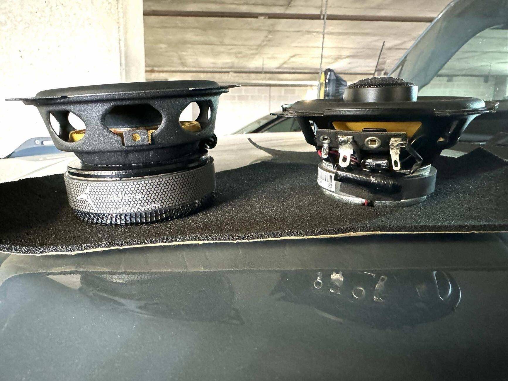

The difference in the magnet sizes between the JLs and the Morels was pretty significant (they have higher RMS and peak wattage as well)

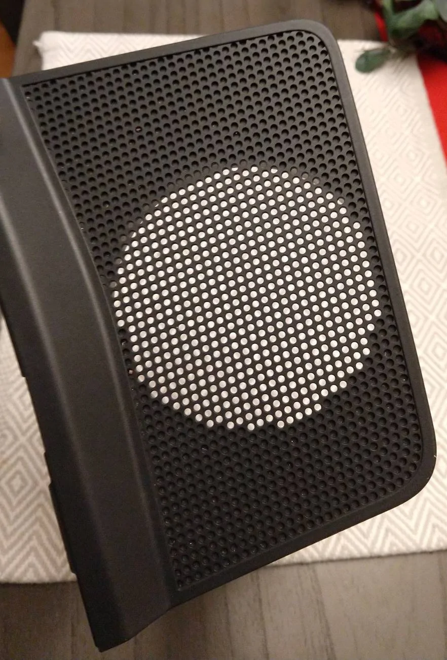

The stock speakers have an outer lip with foam, which mates to the round ridge on the speaker grills. That helps direct sound from the front of the speaker outward, while sound from the back side is directed into the dash.
Photo below shows the speaker lip and grill ridge. When assembled in the dash they mate up.
That’s not there to direct any sound. It’s to keep the speaker from rattling against the grill - as much or more from bumps as sound vibration
I did put some thick and narrow foam tape on the kick panel speakers, but I don't know if it makes a difference.I didn't do it anywhere else.
Same with Kilmat - that's to keep the panels from reverberating so much, but it can only do so much. I think those things are the last 3%, and new speakers and a sub amp are the 97%.
