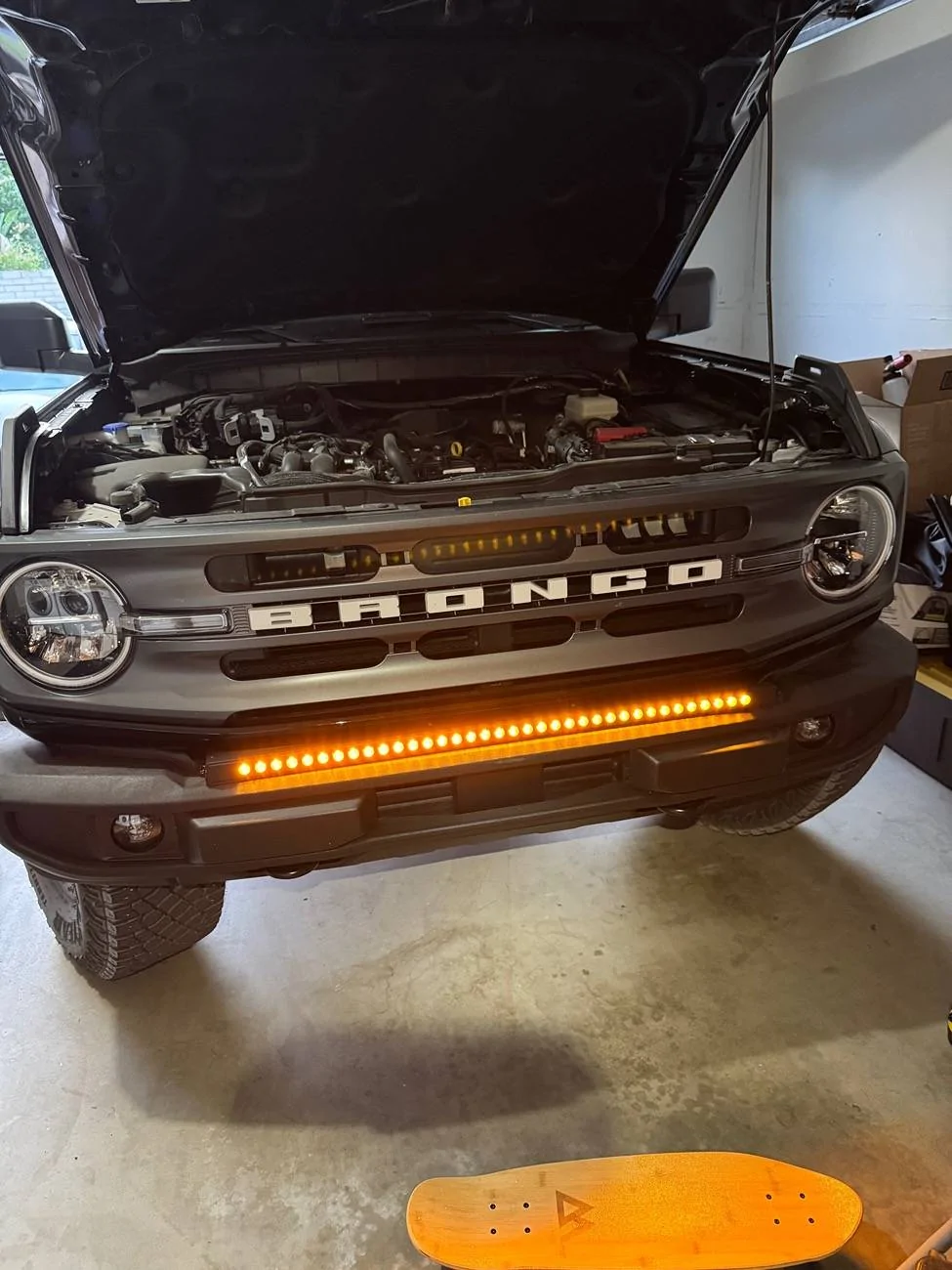

UPDATE - successfully mounted and wired M and R 40” light bar using their no drill brackets, and added 2x 5” AUX BEAM round pod lights directly to the bronco mounting points … light bar was a breeze, but the pods were a bit more tedious then I expected. Here’s the results, I’m pleased. Thanks everyone for the help @MandRautomotive
Ford Bronco AUX SWITCH WIRING QUESTION IMG_6465
Ford Bronco AUX SWITCH WIRING QUESTION IMG_6366
