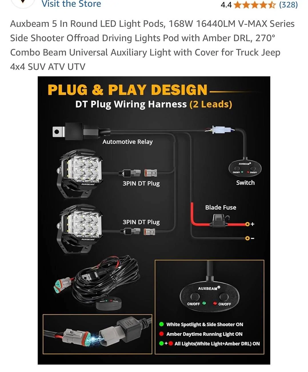

So my question is, in order to wire AUXBEAM ditch lights , can I cut into the wiring harness provided by AUXBEAM between the 3pin DT plug and the automotive relay to expose the power and ground wires ? In theory So I can splice the ground and power wires directly to the bronco aux switch wiring which already has a fuse and relay, bypassing the redundant fuse and relay in the aux beam wiring harness ? Any and all advice appreciated .
Product link and wiring diagram photo
https://a.co/d/1PTDXDT

Correct. Just make sure you connect the power wire to the Aux wire that can safely handle 168W

Switch(s), you have (2) sets of lights.
White and amber.
While you could put them both ono a single aux switch, I am not sure that would be the wisest choice.

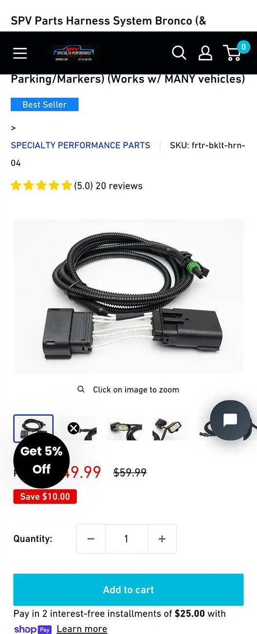

This what I did but used this...
Ford Bronco AUX SWITCH WIRING QUESTION chrome_screenshot_Mar 28, 2025 5_18_18 AM MDT
Ford Bronco AUX SWITCH WIRING QUESTION chrome_screenshot_Mar 28, 2025 5_21_17 AM MDT

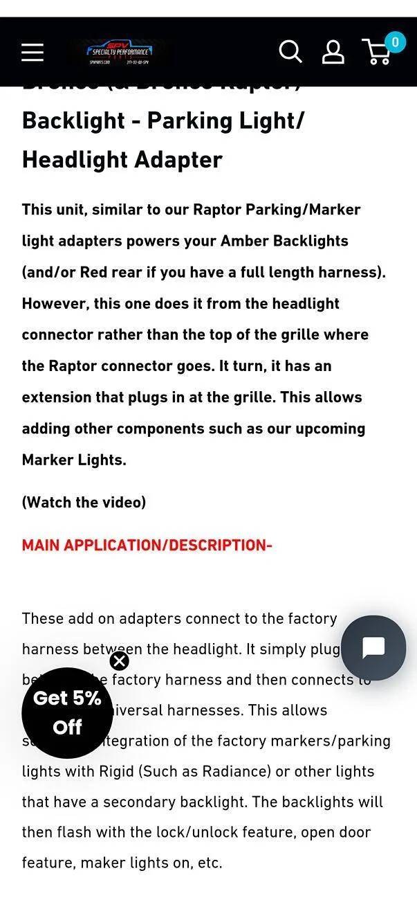

I used the diode dynamics harness that came with mine & I already had a fuse tap on 24 from my Grill letters, so I just spliced my backlight into that harness. Cheap & simple.
White and amber.
can you explain why you don’t think it’s a good idea ? I completely forgot it has amber DRL lights … does that mean the wiring harness has two sets of wires that I can cut into to connect to the ford aux switches ?
The fixtures, light pods, you have have two sets of LED diodes.
The connector has three wires
Two switch legs shared ground
If it were me, I would connect one switched leg to a uplifter switch individually
If not, you have a white and yellow light on at the same time.
Seems like a mistake, in my opinion.
Thanks for clarifying ! I think I’ll take your advice
