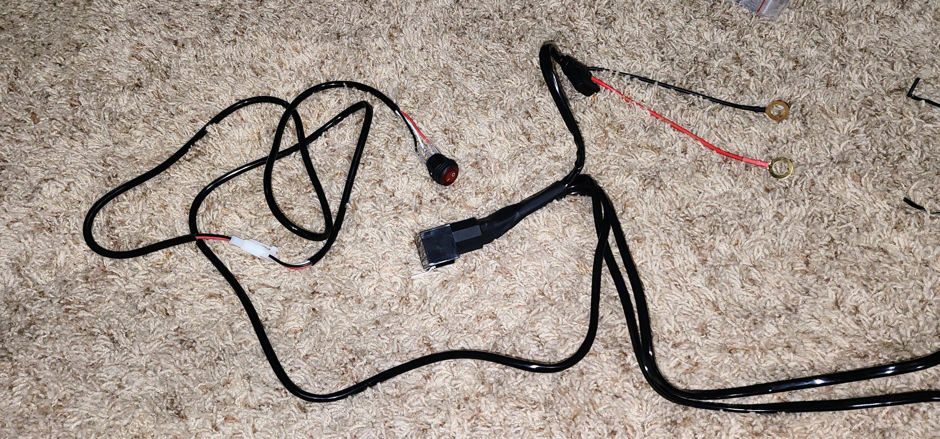

So I just got the Nilight Nixmen Pro 5.7" Round lights (https://a.co/d/g1Wa41b). After reading all the previous posts I have successfully confused myself. Same harness as OP and I also have Aux switches. Planning on hooking up to Aux 2. I need this to be simple so, in Fisher Price terminology, how should this harness be dissected to make the most of it? Do I need to connect to the battery? I read about removing the toggle switch and using the red and black wires... I guess for the aux and ground?... But then what about the white wire? Do I cut before the relay? I also saw someone mention leaving the fuse in-line. I know the answer to these questions are dead simple so school me please. Included is my wiring harness. Cords to the bottom right go to the two round lights.
Quickest way with minimal effort will be to connect the red wire’s eye terminal to the battery, ground the black wire’s eye terminal. That will provide power to the lights. Disconnect/cut off the three wires at the switch, tape up the white one, ground the black, and connect the red to the aux switch wire of your choice.

Doesn't the aux switches have power? Wouldn't the above example, connecting to the battery and the aux switches, be connecting to two power sources?
The way I described uses the relay in the supplied harness. The wires connecting to the battery supply the power to the light, but that power is essentially "cut off" by the relay. When the circuit running to the switch is closed (when the switch is on), that power going back to the relay tells it to complete the circuit to the lights and they power on.
OK, I understand "that power is essentially "cut off" by the relay.".. somewhat, but... Is that just to keep the relay in the wire harness?
It seems redundant to get power from both the battery and from the aux switch too, I admittedly don't know enough to know if that's good or bad.
A relay is more commonly used in higher amperage situations, like for a winch or an air compressor. You generally don't want a large current running through those little toggle switches when the power is activated, hence the need for a relay.
That being said, you are correct. With LEDs like these, the amperage is so low, the current provided by the aux switches in the bronco are more than enough to run these lights. If you wanted to go the cleaner route (but more work), you can connect the two red wires coming off of the lights to a single aux switch wire and ground the two lights' black wires. You may need to add some additional length to the wires, since it looks like they may not be long enough to reach the fuse box area under the hood. If it were me, this is the approach I'd use since it's much cleaner, but understand that it likely requires a bit more cutting/splicing.

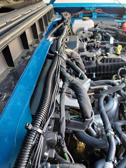

That's exactly what I did, I butchered the wiring harness down and spliced in the multiple red wires to the main wire in the harness and spliced in additional length to the red wires when needed and ran straight to the aux switches. I used "waterproof" shrink wrap connections and I grounded the black wires at closest best point I could use.
Ford Bronco Wiring lights to aux switches, using harnesses? IMG20230404144050
The wiring harnesses' wires are in the black plastic sheathing. I stripped the ground wires out to fit the hot wires in the sheathing and the other black wires zip-tied and running with, are my rock lights.
