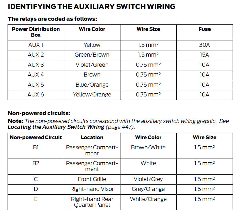

So- If I am reading that table correctly, Aux1 & Aux2 have higher load capacity as they are using the 1.5mm wire, but Aux2 is fused at 15A. Since they have the same wire and same switch, Aux2 could simply benefit from a fuse change to 30A... is that correct?
Also- all 'Non-Powered' circuits are designed to support the 30A load as they are prewired with the same 1.5mm wire?
Is there any other literature from Ford indicating the maximum load rating of these circuits in use- or is that their position as stated in the table?
Before I get totally flamed- the Relay option is the best way to power lights and other high load circuits, but does require more effort to run wires to the desired locations...
I’m assuming Ford did their litigation homework to determine they’re protected but running anywhere close to 30 amps on any more than a couple feet of 16awg wire (~1.5mm) seems sketchy.
Even though all of the stuff I’m running via the switches are within the stated amperage I still have a few of the switches run to an additional relay and heavy duty wiring

Nice. I really like the idea of replacing the stock relay box with something like this. But I would just want to use my upfitter switches to turn on the relays and use heavier gauge wire from the MLC-6 out to my accessories, instead of using the Bronco's smaller gauge pre-run wiring. I'm not really happy about running 20-30A through 18AWG.

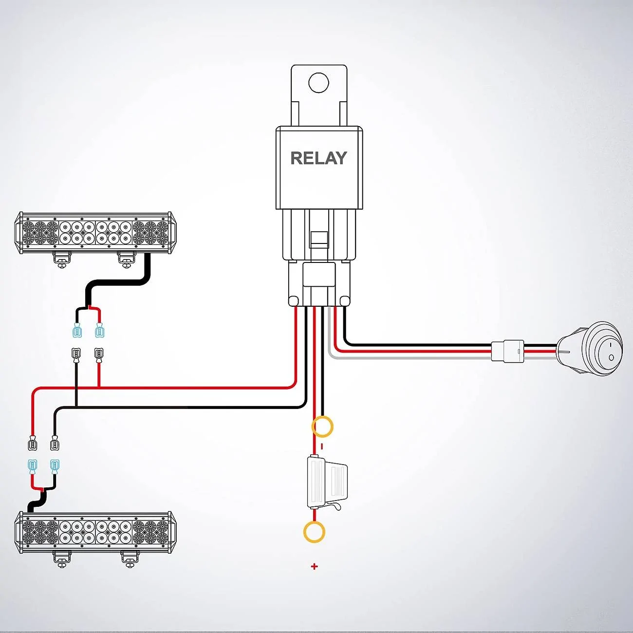

Bought 2 Hella 500 Halogen driving lights, 55W each. So 110 total. Would 10A auxiliary be enough or use relay?
Thinking of this relay kit https://a.co/d/bYnaTZl
Do I need to worry about relay capacity/size?
Any advice on which wire to power from the switch? Red?
If I bought Led lights I'd just wire to auxiliary without asking, but since they are Halogen thought id reach out
I’d relay it.
You’re right on the edge so, while technically 10A should be enough, remember that devices will often surge a higher current draw when you initially power them up. Not to mention, there is no way to predict how much current the device will draw as it ages and the electronics and connections degrade.
That relay kit you linked to should be more than sufficient for this use.

I would use a relay. You are at about the max of 10 amps with the 2 lights. Relay is cheap and easy to do.
