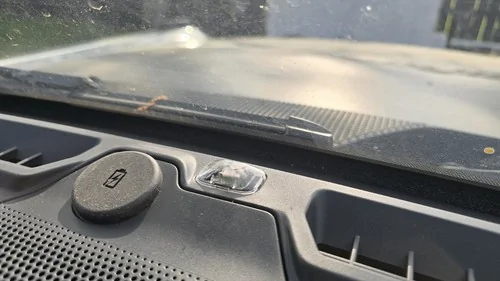

There are clear ambient light sensor covers for those with tinted windows - for someone without a deep tint, this might push your automatic headlight activation a little further into the dark and offset (if not avoid) the auto oscillation issue.
There is an "autolamp delay" in the settings but it seems to only control how long the headlights stay on when the vehicle is turned off.
e: (not my pic)

You could just cover the sensor on the dash during that time of day.

For the record, the auto-dimming of interior lights/backlighting on the screens is different from Auto High Beam
My Auto High Beams work fairly well in rural areas. A little more glitchy if I'm in town with lots of street lights and store lights and such.
My interior lights though - they brighten/dim with no delay, and no gradient - they just turn up or down in very distinct and noticeable steps, so even something like just driving in the shadow of a tree will set them off. One of my small pet peeves with the vehicle. And yeah, at dusk it's really annoying...
Not sure if you can turn off auto-dimming or not, I should look into that too. Covering the dash sensor as previously recommended sounds like it would work as a manual work around, I admit I haven't tried it yet though, but now it's on my list.
