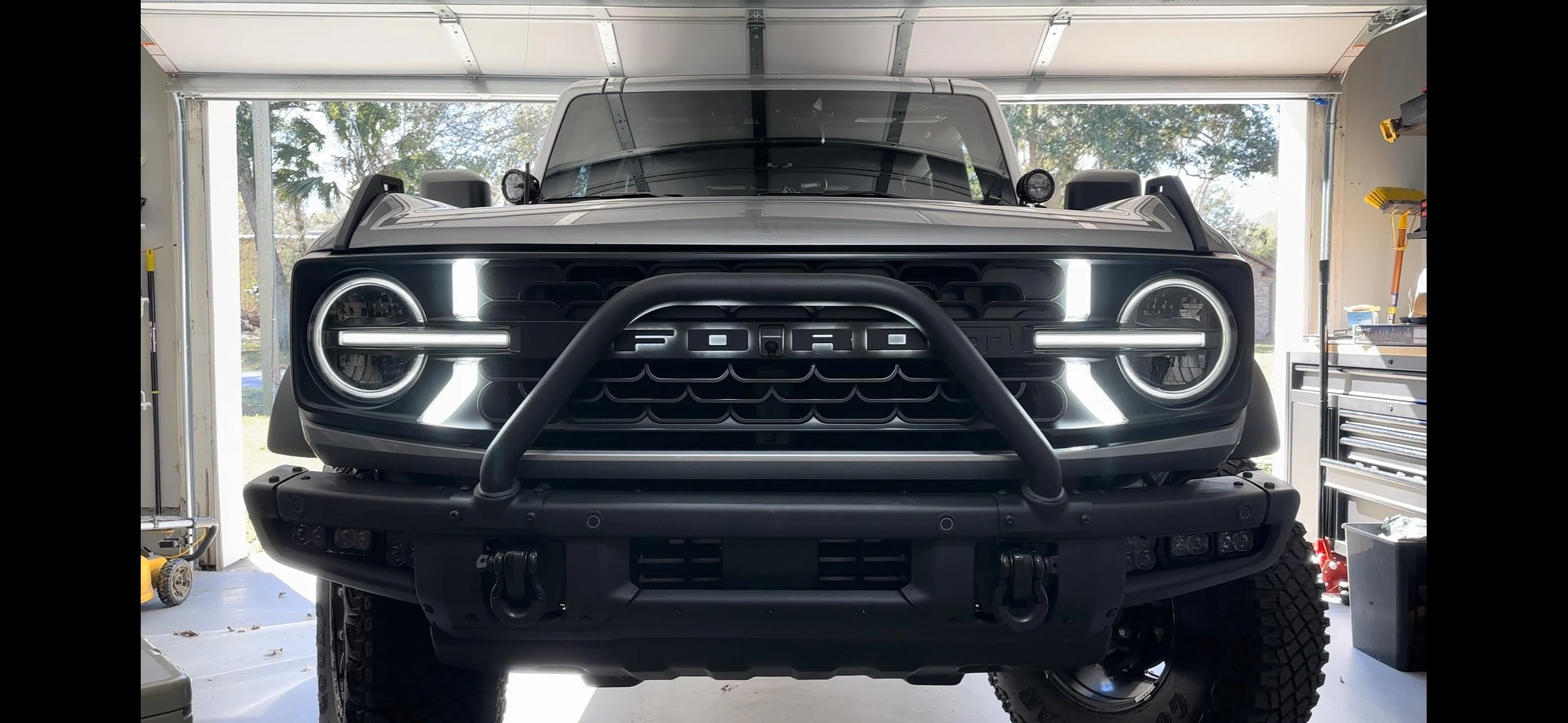

As the title suggest I installed the RTR grille today and after everything was said and done it now appears the auto headlamp position no longer functions, has anyone else that’s installed the grille run into this issue?
Ford Bronco RTR grille auto headlights not working now 1DC0ECEC-4E13-4A08-8659-E58995FE782D
When in the auto position headlights are dead, no light no running lights, nothing. If I move the switch to running lights or headlights it works so just didn’t know if something was a miss.

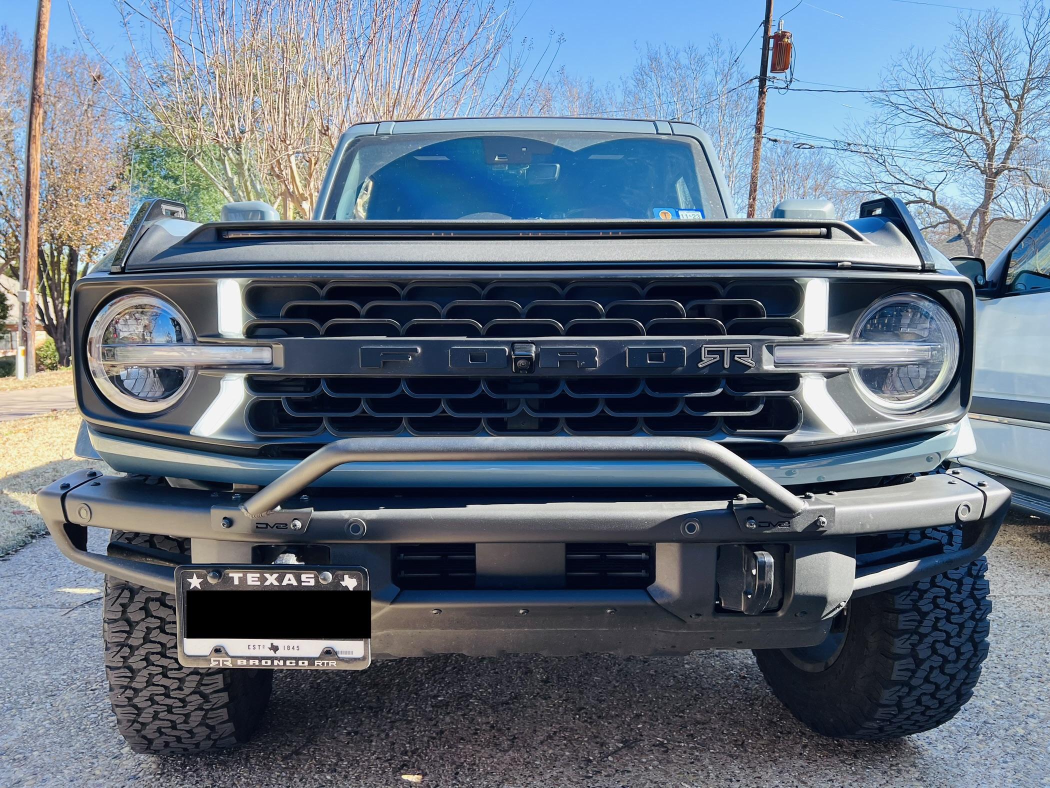

@DocFuller first off, glad to see another FORD x RTR Grille out there!
I‘m going to look into this later, but I was wondering if that’s an OEM Safari Bar on the front or if it’s another brand? If OEM, do you not have any rubbage between the bar and grille (from road vibrations)? I had this issue and that was without installing the RTR emblem, which the Safari Bar would have definitively rested on.
I ended up replacmy OEM Safari Bar with the DV8 Bull Bar and had to buy another RTR center bar for that very reason so I’m curious.

Do you have any issues with your DRLs not coming on during the day since the swap?
I have the OEM safari bar and will have to go checkfor rubbage but I dont think so. I also haven’t installed the Rtr logo yet. I’m waiting for a couple ideas to get to the house sominhavensome symmetry going on haha

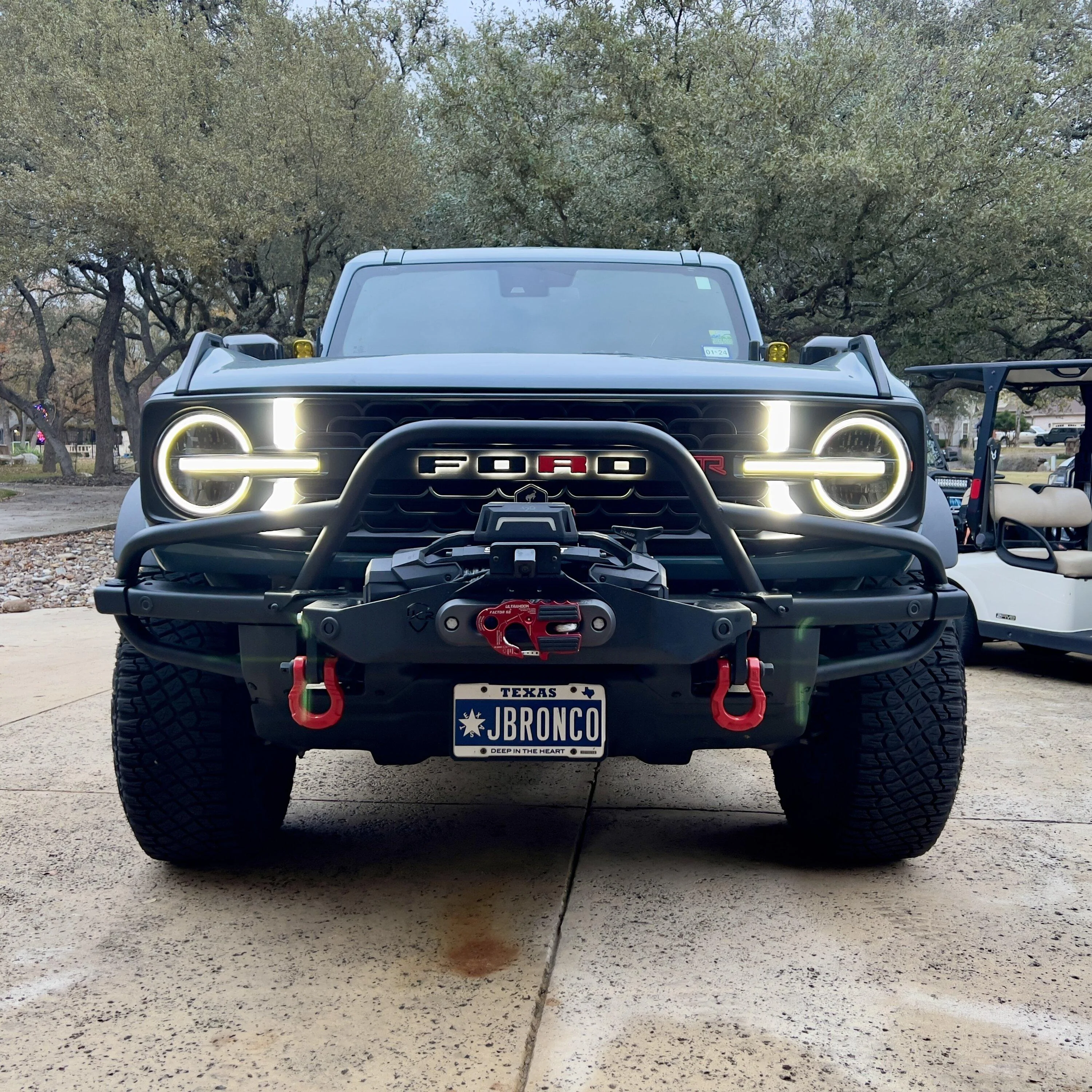

I have noticed on mine that the daytime running lights only switch on when put into gear when set on auto. Not sure if this affects what your experiencing or not. Very nice to see others with this awesome setup. I have the JCR Pre-runner bar and it DOES rub a bit on the grill, but not enough to bug me.
