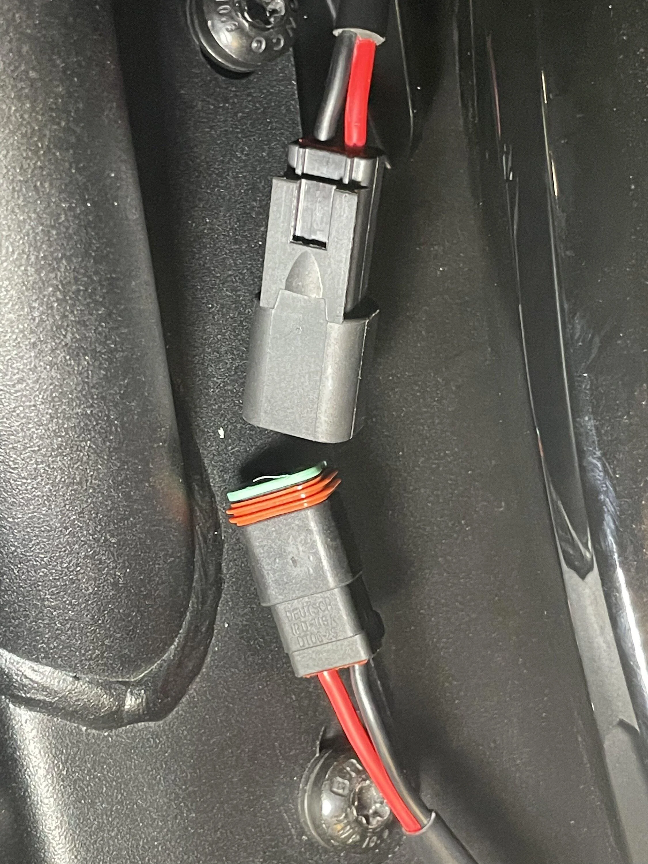

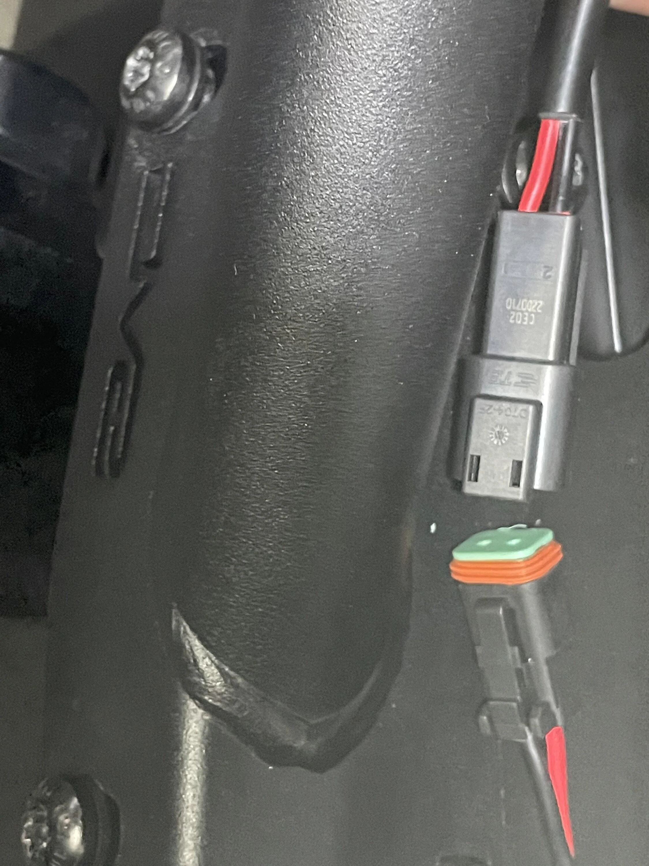

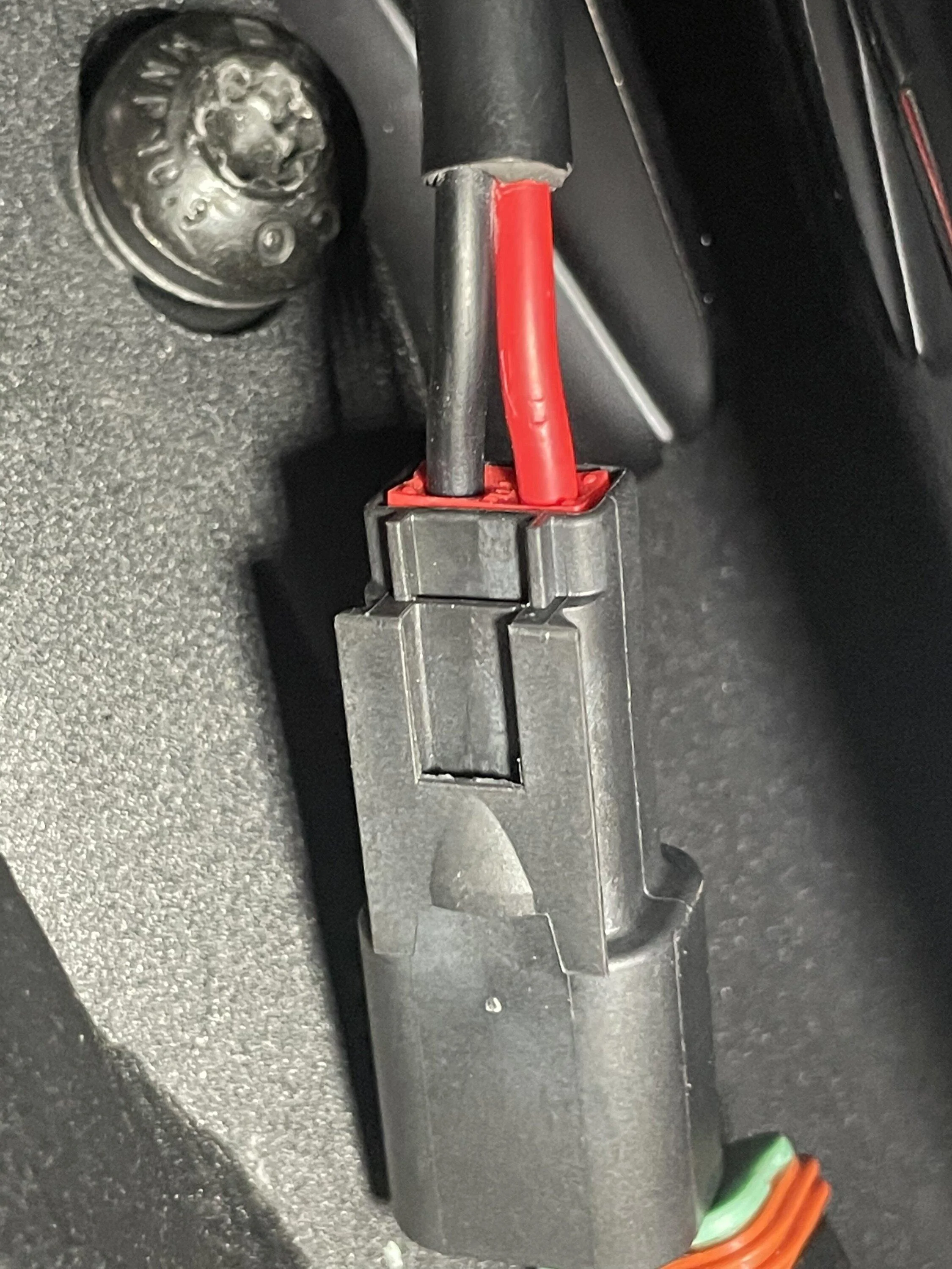

here is a few pics of the only harness connection. Originally I thought maybe they assembled the harness incorrectly as the positive is on the opposite side but not sure?

Assuming that the rest of the wiring isncorrecr, red needs to connect to red and black needs to connect to black. What does it look like plugged in?

Well! Heretic had it reversed. After googling how to depin , I removed and reversed the wire and plugged it up and it worked. Shit! Not a great first impression after a month wait!

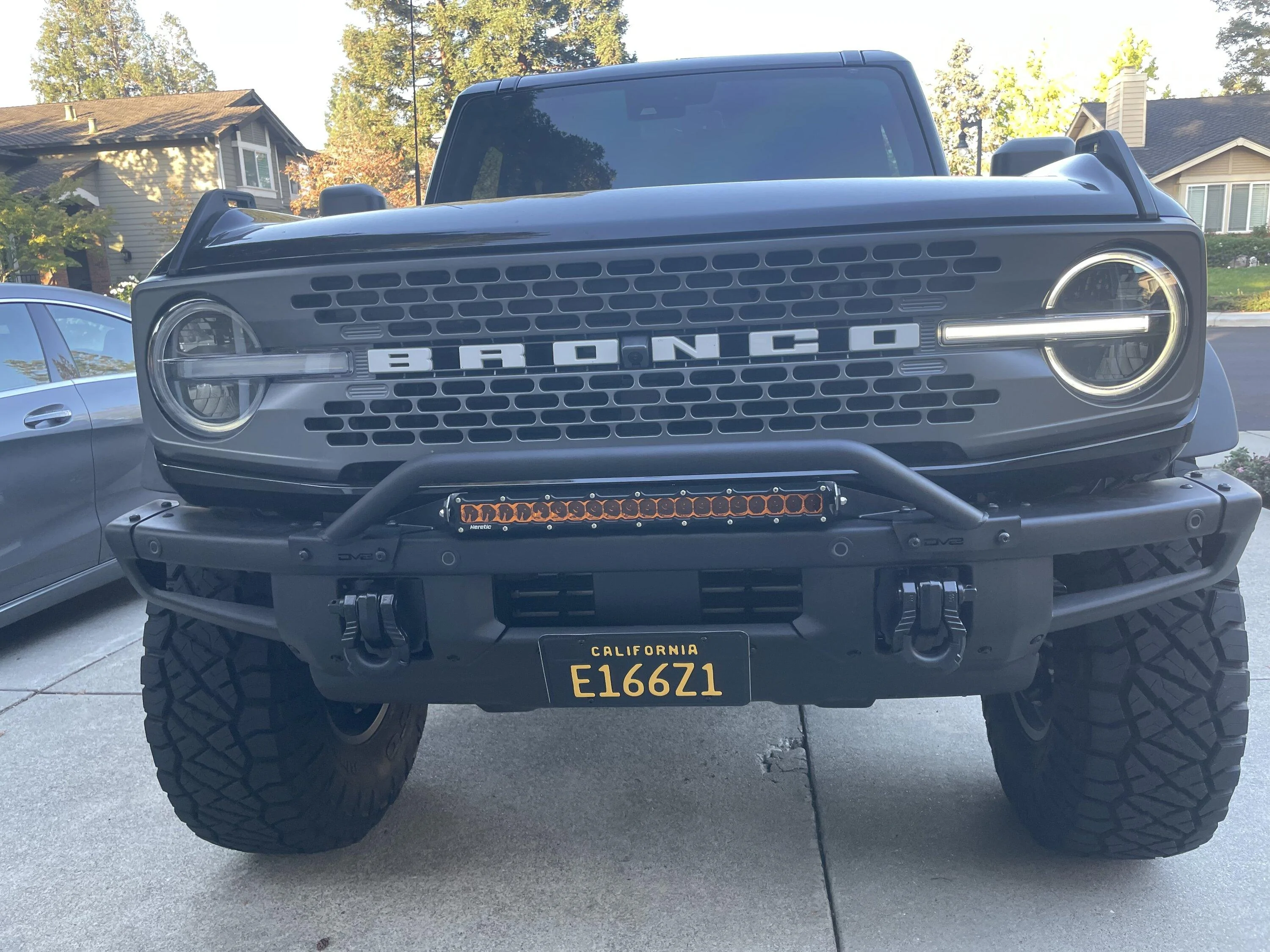

its the dv8 bar and have their front license plate frame. I’m sure I will get shit for how I mounted it but I put thr lightbar bracket on and then the bullbar over it. It’s tight, a little gap but doesn’t bother me. I like thr lightbar position rather than hanging off the bar.
still waiting for pocket Fog lights and pillars from heretic

It's the OEM modular bumper that came on the Badlands. I think its now an option vs the capable bumper? I am not a fan of the OEM brush guard/bullbar that is soooo tall so I saw the DV8 one. Several others have a similar style. Bolted it on and felt it made an impact. It has an optional bracket that you can mount a small lightbar to it but I saw several vids of the heretic mounted to the bumper so liked that position better. The 2 have to mount on the same OEM bolts so it's not ideal but it works.

Curious, did you have to rewire the actual deutsch plugs or just flip it over?
By the images posted, it looks to me that they are not being inserted the correct way by looking at the wiring, but the pins are matching up, so to me, one of them was built incorrectly by the manufacturer. If so, lucky for them (and you) that nothing blew or caught on fire.

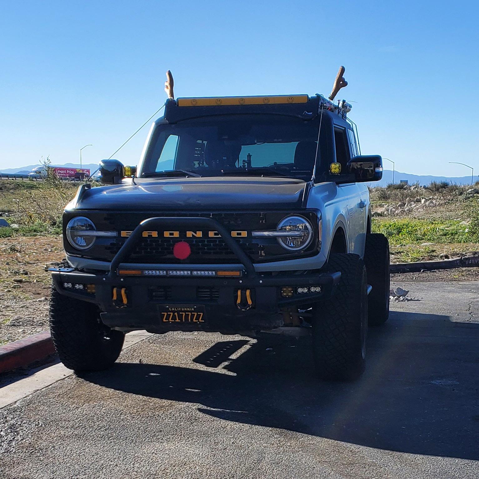

I opted for a Diode 30" bar for the bumper because, well, it fit between the OEM nudge bar. However, I like your nudge bar a lot better.
Does it hinder the front cam view?
Also, is the spacing the same, because I don't want to change light bars.
Thinking I'd swap this out and add some round KC lights to the top of the shorty nudge bar, if the above conditions are met.
Ford Bronco Lightbar install not working 20221126_091653

I just released the end, reversed and then reconnected. They put it on reverse. It was a quick fix once I figured out how to release the plug.
Cameras is good. You can see the bar but barely and doesn’t block view. I did look at the 30” bar but the angle on the dv8 would prevent it from fitting. I have seen other bars on Amazon that are similar to the dv8 but slightly taller so could possibly fit.
