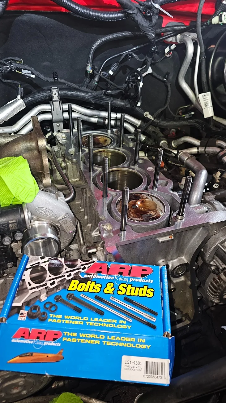

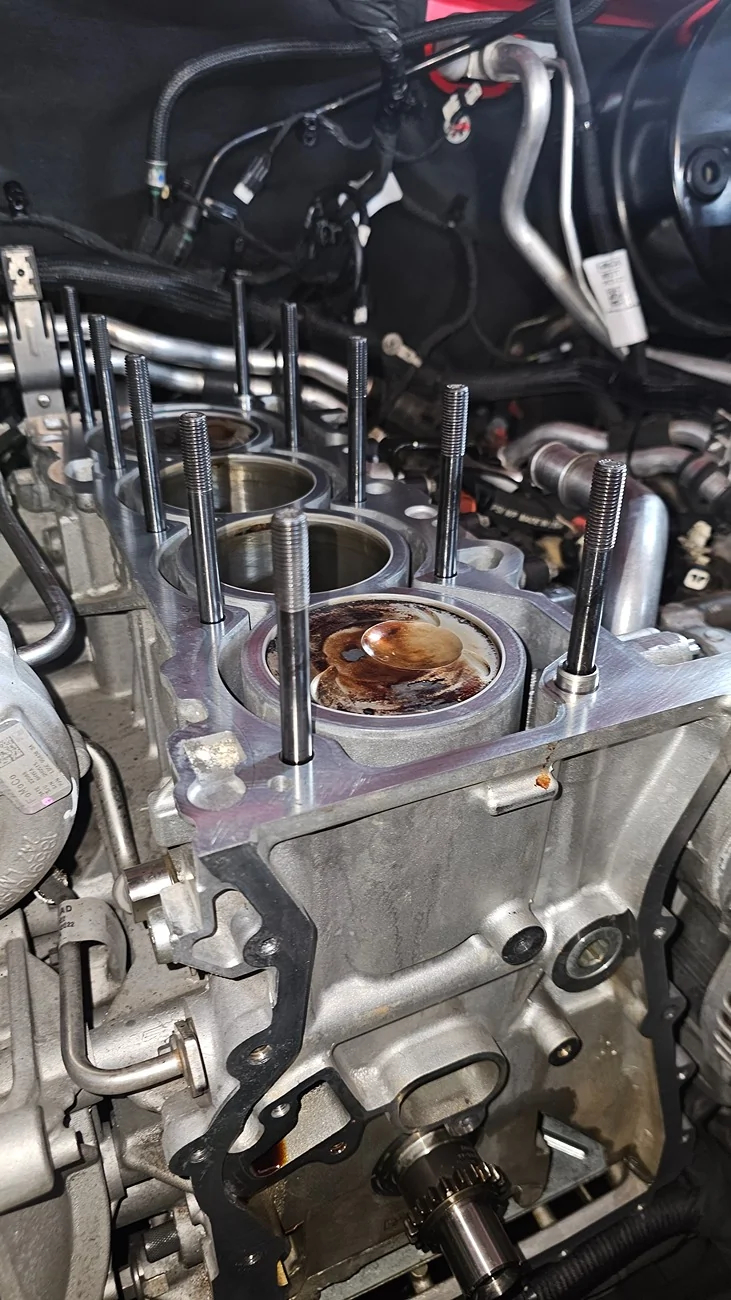

Having to replace the cylinder head on my 2022 2.3 with 50k miles due to a burnt intake valve.
Ive found some Mustang Forums using ARP 151-4301 2000 series Studs and some upgraded head gasket designs. ARP lists these studs as 2.3L Ecoboost replacement, however Ford parts manual shows different part numbers for the mustang vs bronco head bolts.
Is anyone in here familiar with what parts are interchangeable with the Bronco vs the Mustang for cylinder head Studs and gaskets? Most aftermarket sites dont mention the Bronco for 2.3 Upgrades with base engine components. Hoping to find a wiz in here that can help!!
Looking to do studs and a better gasket with the new cylinder head.

Yeah unfortunately they can't confirm that they are a direct fit. As fas as they know the 2.3L isnt redesigned completely for the Bronco (which we know) so they should fit. The studs appear to be correct length and everything else is identical.
Ill be the test mule, as I have a set on the bench to put in. Will probably be the first studded Bronco in the US 🤷‍♂️
