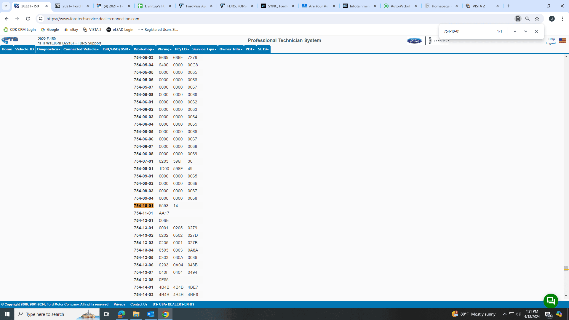

My updates never worked, likely never will work, and have to be manually done with FDRS apparently.
Why don't your OTA's work?

I suspect it's because my Bronco isn't fully spec'd/programmed as a "USDM" market car. It's a fleet unit sold thru some European holding company as part of the military auto sales program. I don't have proof, but there are some oddities with it.
Correction, I did get one update, one time in late 2021. Otherwise, even spinning a dead chicken overhead and chanting while talking to Ford support wouldn't fix the problem.

Do any of your connected services work?
If you have FORScan or know how to pull the as-built data on your truck, go to this line in the TCU. If in the 754-10-01 location you see anything other than 5553 14, then your TCU is registered to another country and that's your problem.
Or send me your VIN and I'll poke around to see if I see anything.
Yes, all my connected services work.
My TCU is registered as 5553-14.
I will send you the VIN.
