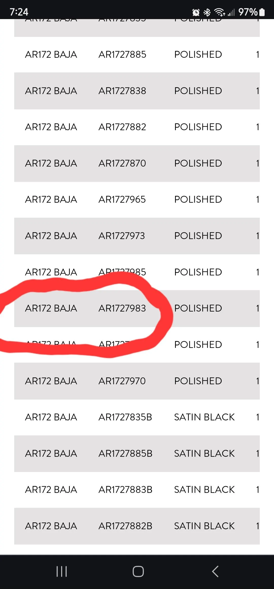

DEALERS ON LINE SAY THE WILL NOT FIT MY BASE SASQUATCH. ANYONE HAVE THE CORRECT PART NUMBER? IVE SEEN THEM ON A FEW BRONCOS

Ya you need the one circled and it's going to be a -12 offset. Just need to order the right finish.

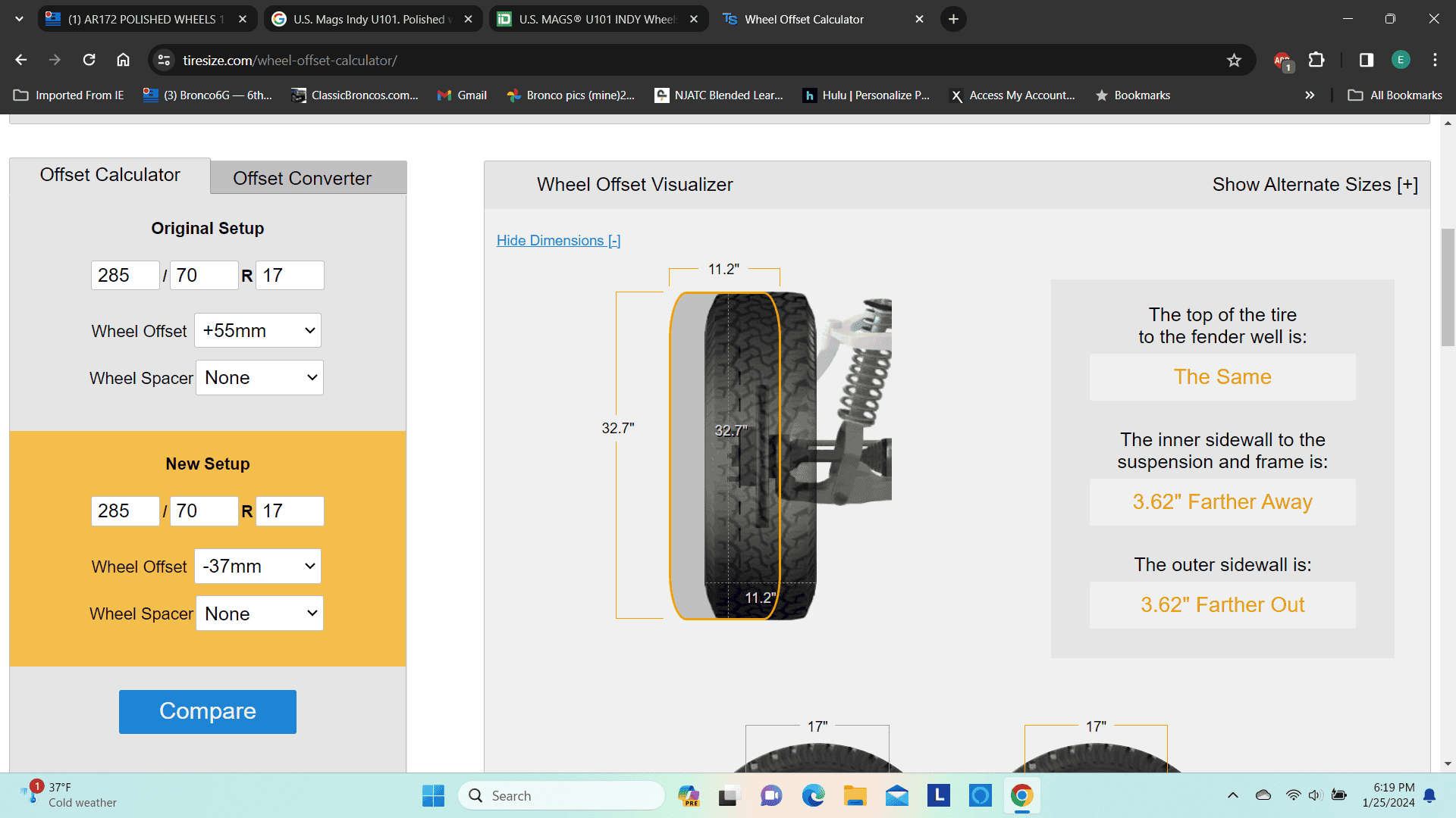

Guessing this wheel has too much offset the wrong way? I always get confused on + or -
U.S. Mags Indy U101. Polished wheels U10117908335
Positive offset brings the wheel into the wheel well = Less poke. Negative pushes the wheel out = More poke.
