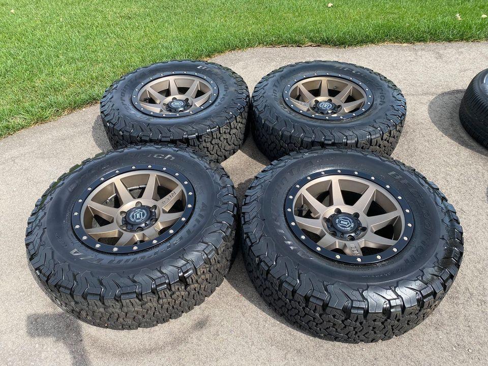

Good news and bad news. Found these wheels for a steal of a deal. 6x5.5 off of a Silverado. Only issue is offset. 0 offset currently.
Could I pull these off? with spacers? Any recommendations?
These wheels are quite literally 1/3 of a new set which is why I don't want to pass it up.
TIA.

0 offest should work fine. adding a spacer will put that wheel in the negative offsets. so unless you are looking for more poke outside the flares then no need to add spacers.

At zero offset they will stick out past the fenders some. Spacers will make it worse.

What are you going to do about the 5th wheel ? Post pics once mounted
