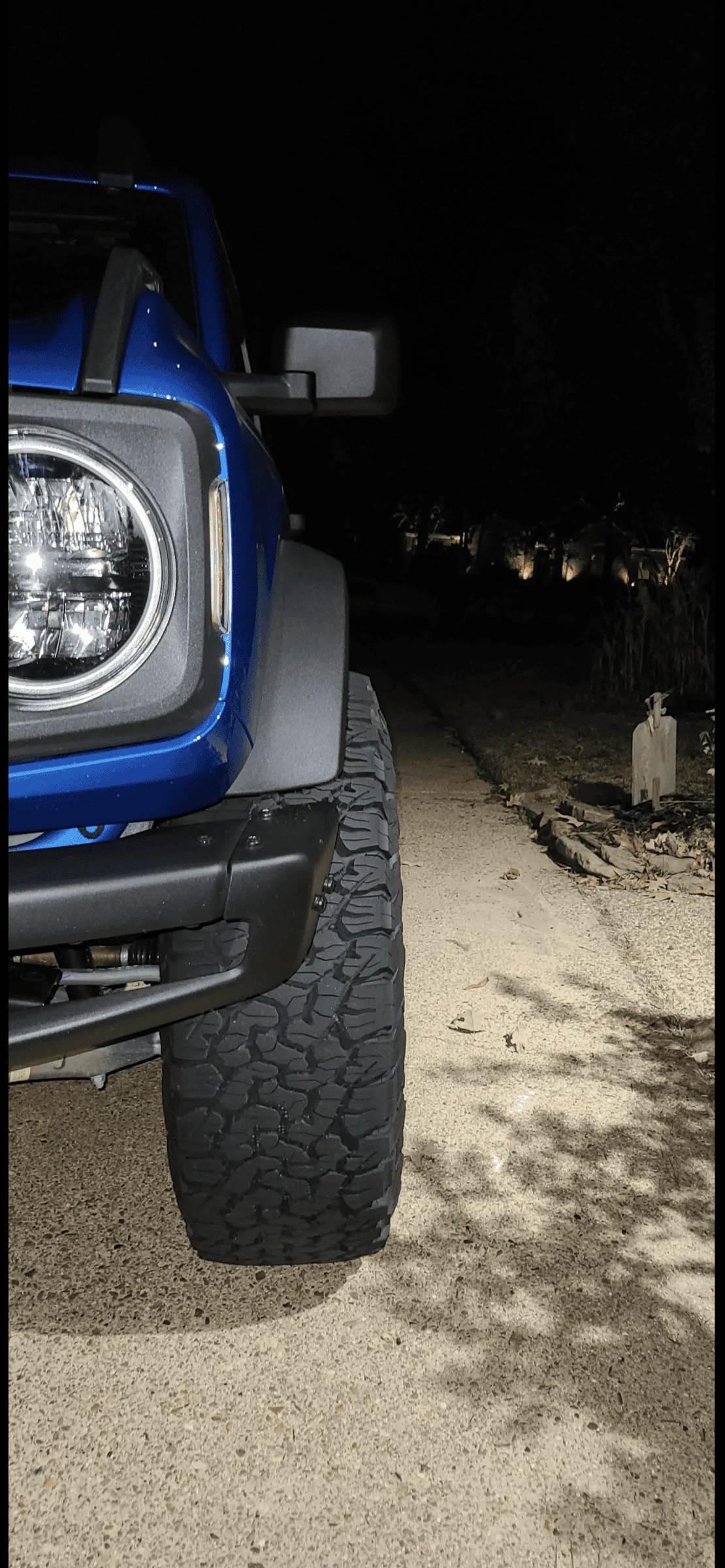

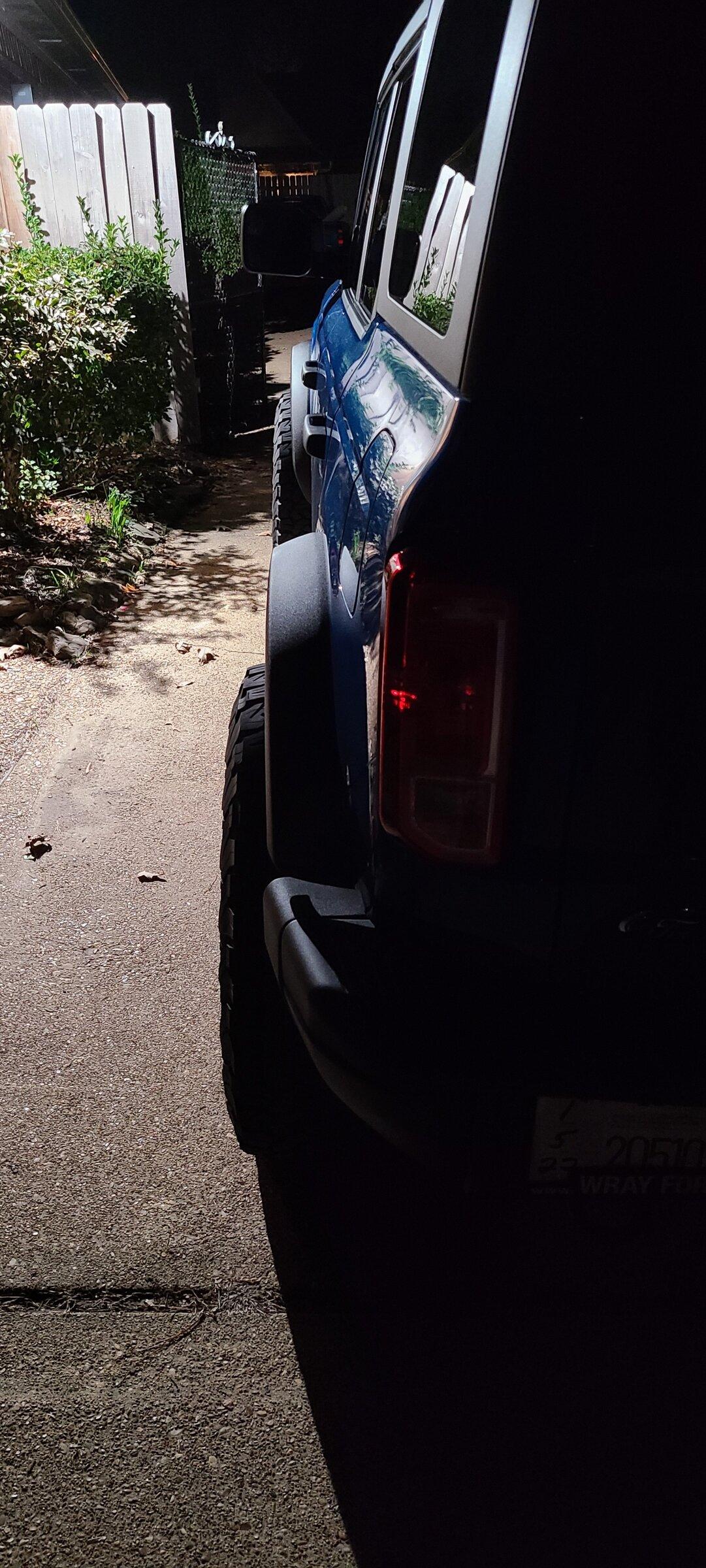

I got you. 17x9 wheels with 0 offset and non-SAS flares. Ended up swapping for SAS flares afterwards, which was perfect for me

Are these the RTR Tech 6 wheels? If so, can you post a pic of them from the side? Thanks so much!

Does anyone know if those flares are equivalent to the painted OBX flares?

No they aren’t. They are American Racing Baja 172 wheels.

Yes they are. Same size
Thanks... so to minimize the poke w/ a similar size tire/wheel combo I'd need positive offset correct? I'm looking at a similar setup but want 0 or minimal poke, these stick out a little too much for what I'm looking for and I don't want to switch to SAS flares

Correct. Stock wheels on the OBX are +55 offset so I’d stick to as close to that as possible if you don’t want poke

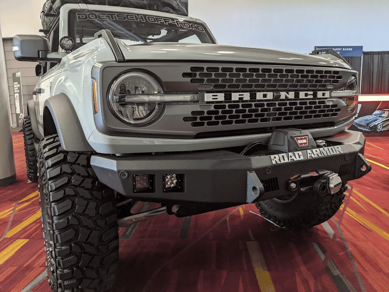

Here is another angle of 00 offset with stock flares. I would prefer a bit more coverage over the tires and am thus looking for someone with squatch flares to swap.
