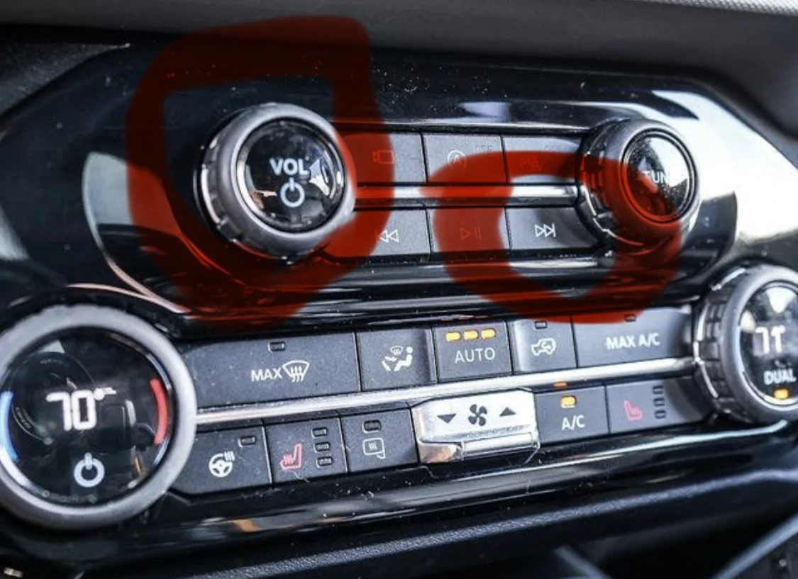

Same. I’ve been dealing with connection issues ands no sound from my left side speakers. I have to turn off the Bronco and open the door to reset.
If you hold these 2 buttons it will reset while you’re driving without having to shut everything down.
Ford Bronco Apple iOS 26 and carplay IMG_1873
That's alot more convenient. Thanks!
That’s the problem. This is required more often than necessary.
IIRC that causes a 'hard reset,' not the soft reset that shutting down and opening the door causes. So rebooting with those buttons MAY help with your issue.
You'll also want to make sure Sync is up to date. If you aren't doing the automatic updates you may still have issues.
