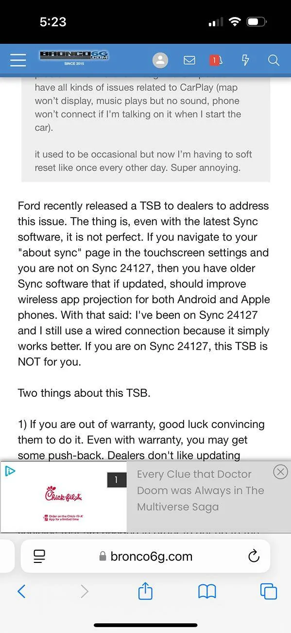

I found this in another post. I don’t think I have that version. Will drop by this week and discuss
Ford Bronco Apple CarPlay disconnect issue - Solved? IMG_5315
