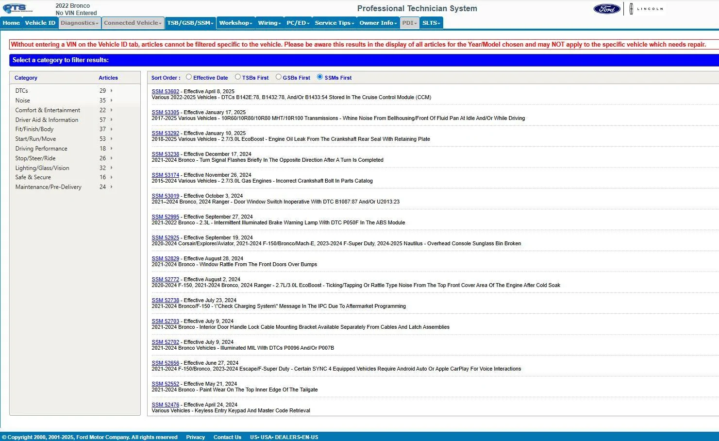

Have you got any useful info regarding this issue (SSM 53088)?
Thanks! C
It does not seem like that SSM is active anymore. What Sync version is your truck on now? 5 digit number that starts with a 2 in your "about sync" page in your general settings menu.
Ford Bronco Android Auto Functionality - 6 Months In, and I can't Take a Call! 1745511507818-j

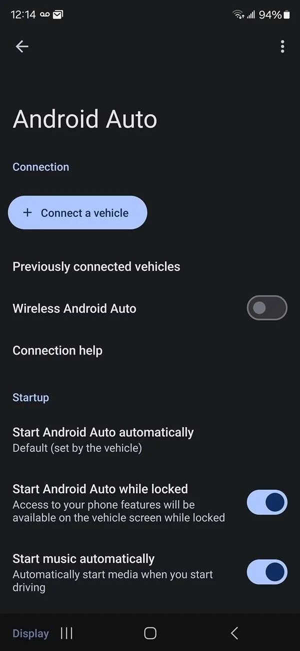

So I disabeled blutooth in sync 4 and the usb won't even recognize android auto. As soon as I connect the phone back up, blutooth automatically comes on and connects. Extremely frusterating. The Blutooth codec on sync 4 is complete garbage and makes music sound horrible.

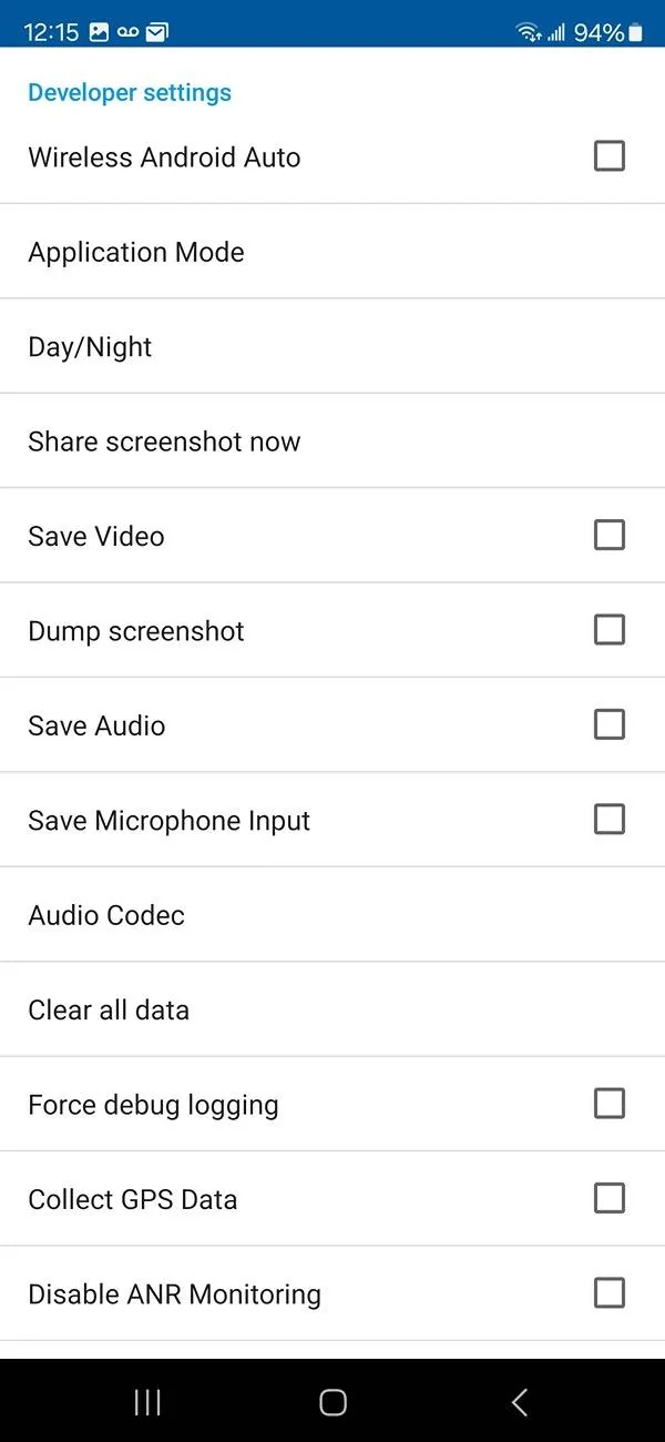

I am not sure how it works on your phone, but you need to find a way to enable the developer settings on it. On my S25 Ultra, you go to software info in the about phone section and tap "build number" seven times. That will allow you to turn off wireless android auto. I've been running it that way for years. Even on the latest and greatest Sync version, wireless projection is garbage whether you have Android or Apple. IMO, anyway. If I don't plug my phone in, the truck won't pick it up. The other thing is, I use an OEM Samsung cable and not a cheap knock-off cable. I don't know how much of a difference that makes, but I can tell you Android Auto works flawlessly 95% of the time. The only issue I have is sometimes the maps do not load, but if I unplug the cable and plug it back in, the maps load up right away 100% of the time.

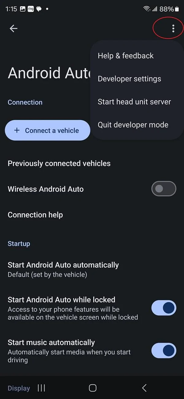

These are the settings I need. I'm on s25 Ultra and have had developer options available. However, mine is missing those settings somehow. Where do you find that develepor settings page?
Hit these three little dots and it'll bring up this menu to go into the developer settings for AA:
