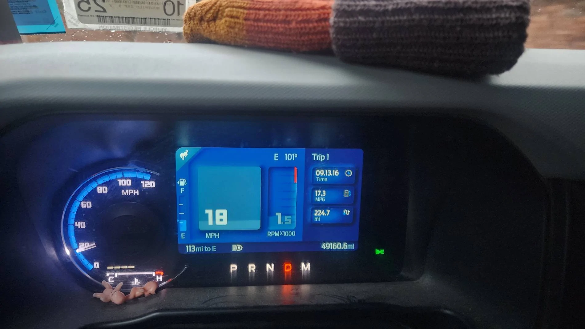

From me previous post, 2 weeks ago, I had removed mine and cleaned it off and it started working ok... Then a few days ago, it started going screwy again. Yesterday, my engine light came on and my App got a message that the Ambient Air Sensor is having an electrical issue. I'm now going to order a new one.
It was about 26F when I took this picture:
Ford Bronco Ambient Temp Sensor - Replace Myself or Take to Dealer? Bronco_AirTempSensor
Update:
I installed the new part and the temperature readings were immediately accurate - but the engine light remained on. I drove for about 300 miles before the engine light went off.
