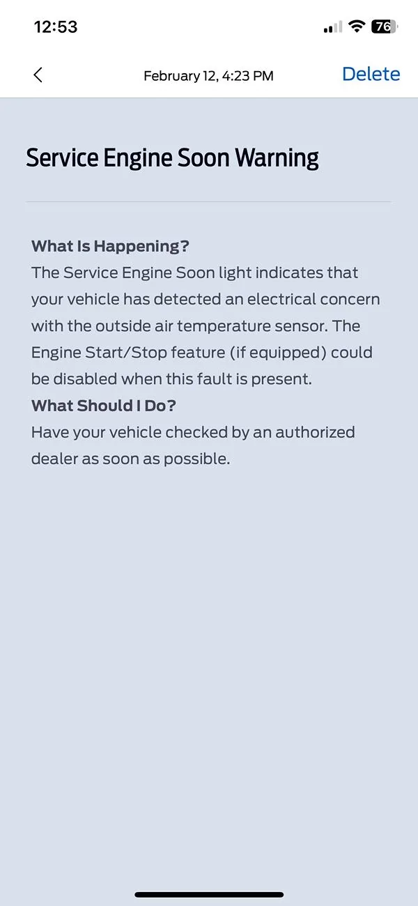

Check engine light came on saying
I don't think any of us had to calibrate the sensor.
Back when I replaced mine, just unplugged battery, replaced sensor, hooked battery back up and was good to go.
What I would question is your check engine light though. Never had that pop with the sensor reading wrong. And when it read wrong it was reading around 110 when it was like 40 degrees out. You should pull the code and find out why your check engine light is on.
check engine light came on and ford pass app sent a message saying
That's odd, my light never popped.
Well I guess it wouldn't hurt to just try and replace the sensor and see what happens.
