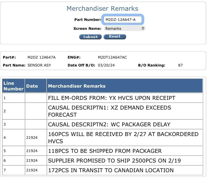

Got the same issue, will be trying the clean off and see method, meanwhile, nationwide backorder for the sensor again....
Ducati1098
10,048
23,421
Midwest
Looks like a bunch will be available soon.

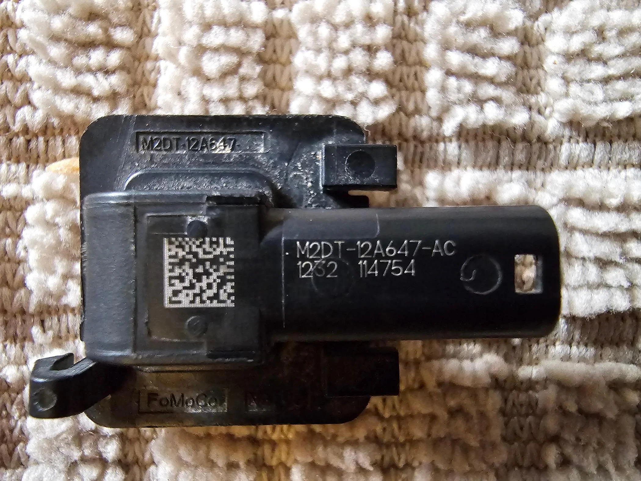

I just had the same issue. I took it to Autozone to have the codes read and it was P0071 primary and P0073 secondary. I swung by the Ford dealership in town and bought a new sensor for $4 (part stamp # M2DT-12A647-AC). Quick install and the outside temp is back to normal at 55 degrees (was previously 120 degrees). However I can't get the check engine light to go off, even after disconnecting the battery for 15 mins. I'm going to drive it for a few days and see if it resolves.
A couple of other tips if you're waiting for a part...
First, if you disconnect the sensor your heating/cooling will function normally again...at least mine did.
Second, if you don't feel like doing that but it's still cold where you are you can run the climate on HI to get some heat out of it.

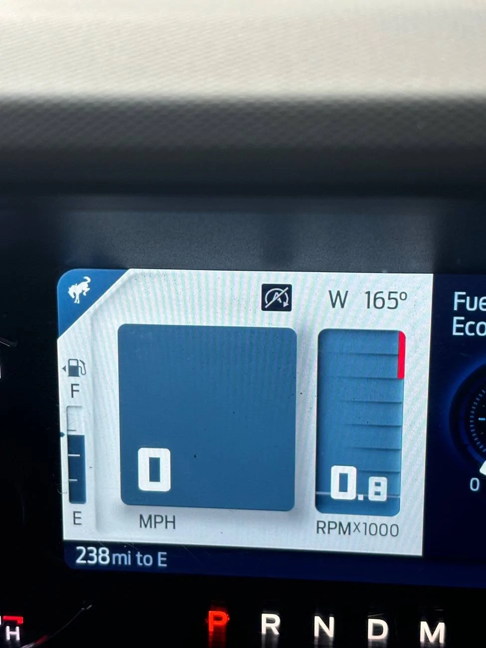

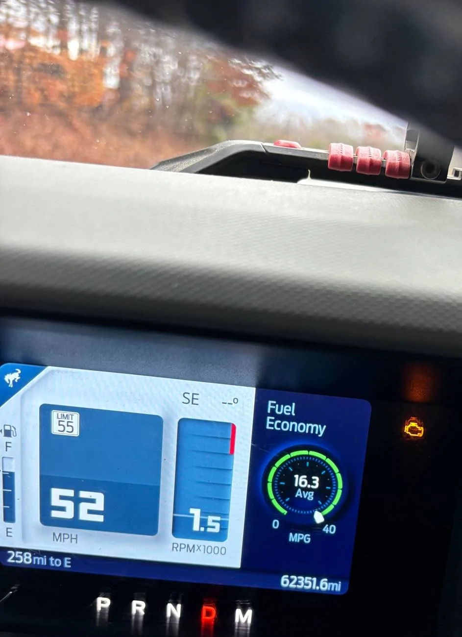

First this
Ford Bronco Outside temp sensor module f*cked? IMG_2511
Then this.
Ford Bronco Outside temp sensor module f*cked? IMG_2512
Ambient air temp sensor is what the code came up to be…
To do list just got a bit longer.
