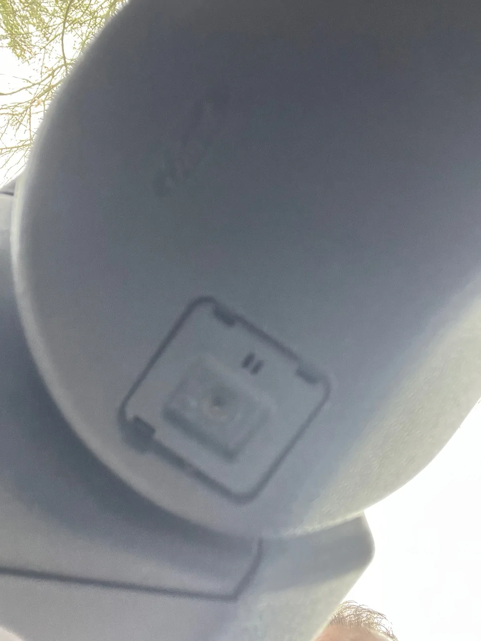

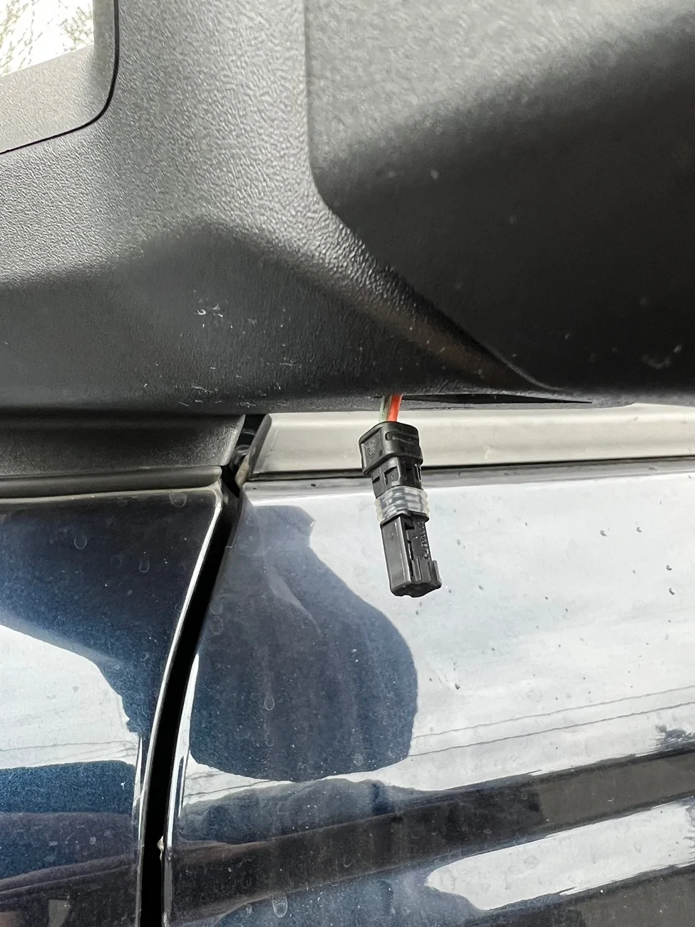

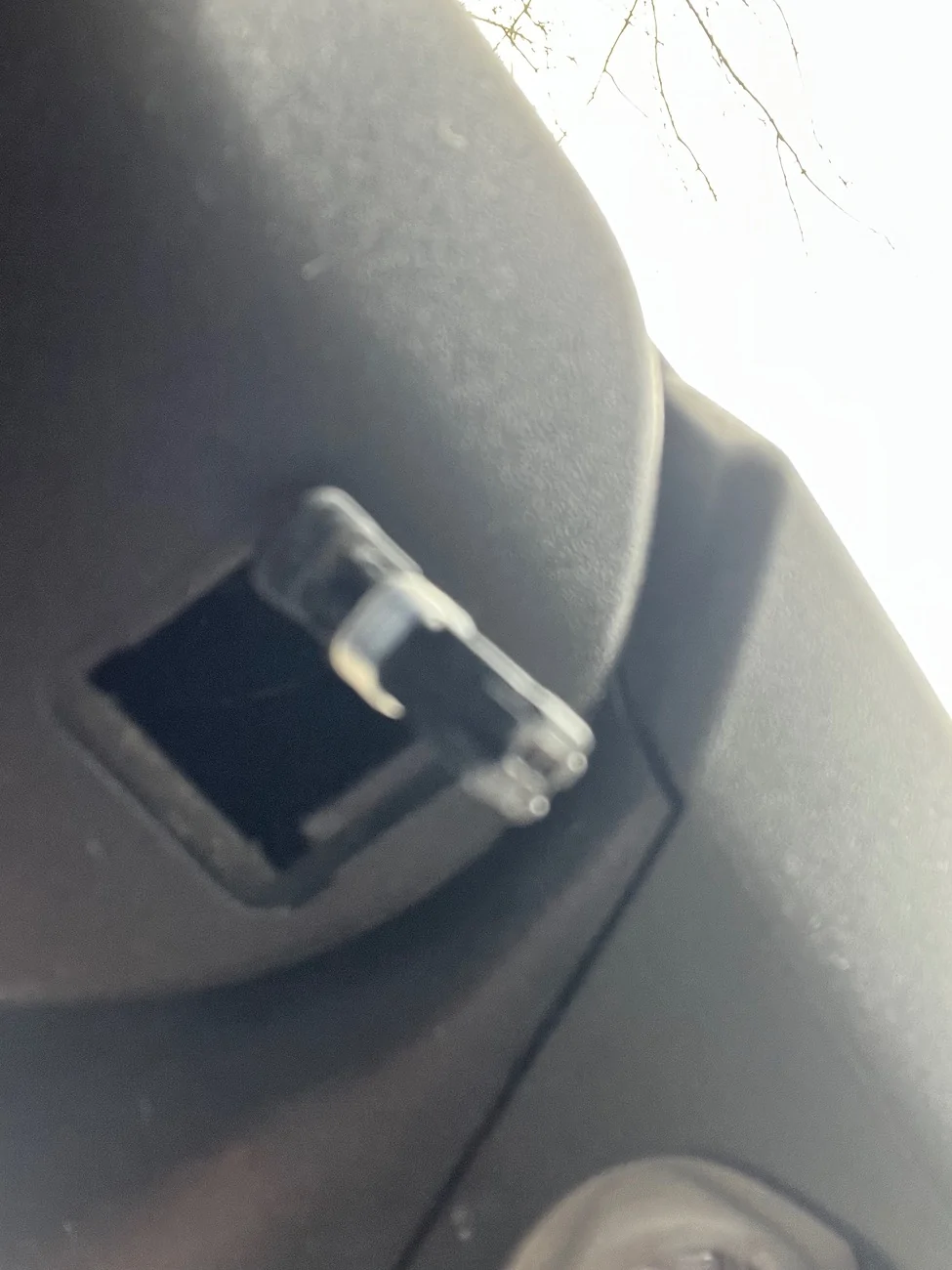

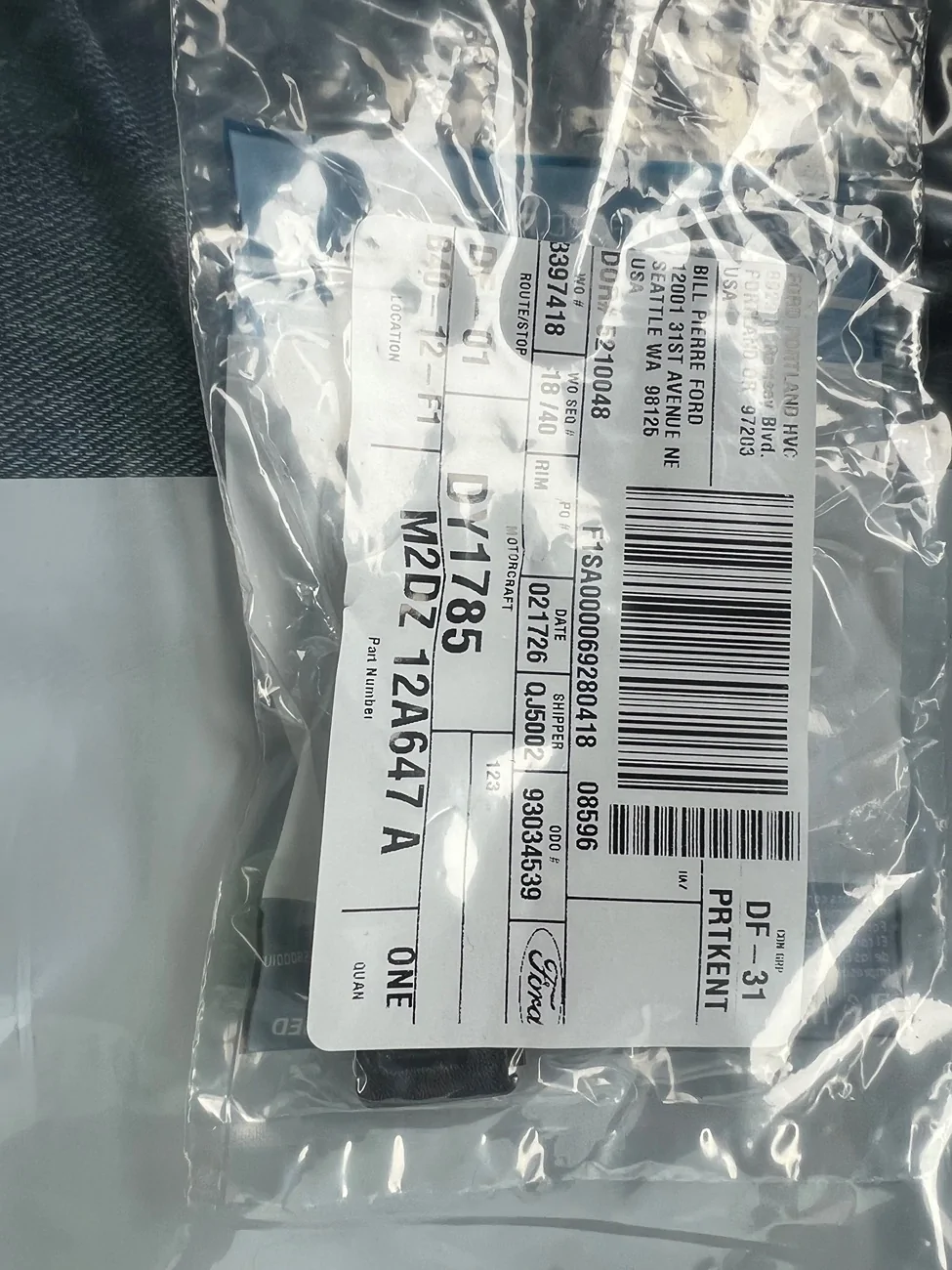

I just did the R&R. It set a ”permanent“ fault that the truck has to clear, but I used the bluedriver scan tool to reset the CEL (Check Engine Light). Pry free of mirror with flat head or spudger, then press in clip for harness with an awl to wriggle it out. Get the orientation right and the new one slides on and clips in.
No programming was required, but I did use my scan tool to reset the codes.
