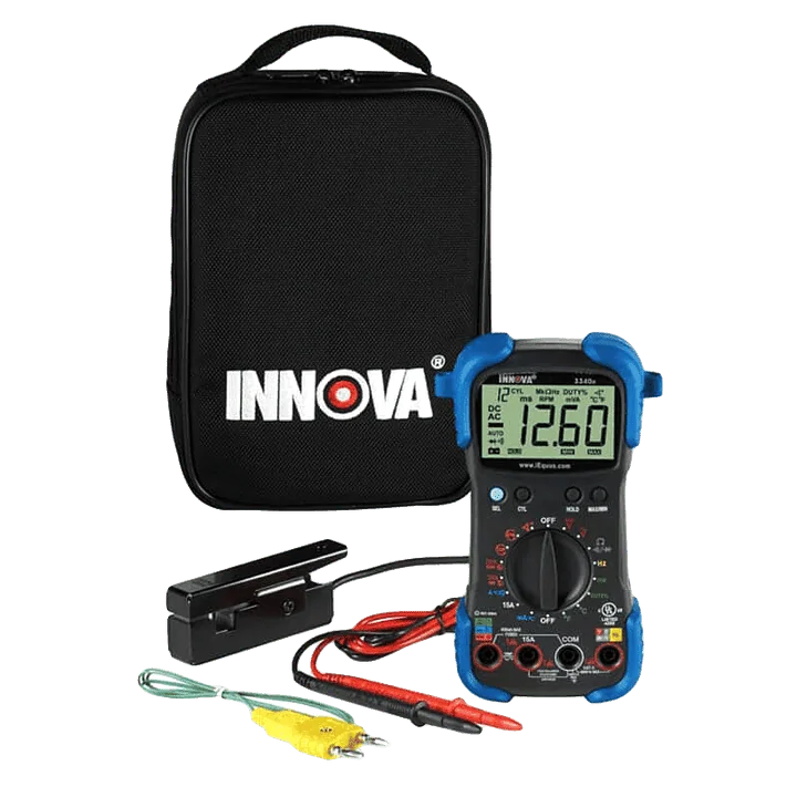

What you need is an inductive amp probe and a multimeter. Turn on all these accessories at idle, and see what they draw. Voltage is misleading because it will rise and fall w/demand on the system. 250A is HUGE for an alternator...although the newer alternators are much more powerful than what we used to have!
Got one, It's difficult to find a single point to check the whole system because of the wiring harness layout (No real single point to check cause my clamp isn't big enough to do the big bundles coming off the battery) This is my multimeter. to show the clamp;
Ford Bronco Alternator Upgrade automotive-dmm-3340-1_720x720
I did measure the Amplifiers' current with it, that was a max of 38 Amps with a pretty punchy song at 24.... I should be able to measure the steering rack the same way.... But I got some other stuff I gotta do before the parts counter closes, so,
to be continued....
to be continued....
The steering rack isn't a continous load. Its fused at 80A, but only would get close to that draw when turned hard over and held there. Doubtful your upgrade plays any role in the overall amperage budget (considering the original rack drew close to the same, for street purposes at least). I would clamp the inductive pickup to the alternator main lead, then check power output at no load idle, then turn on accessories and watch the output. Remeber "surge load" will be handled by the battery, but the alternator will need to make up that amperage use over time, so give it a few minutes of runtime at high load to see if it gets even close to its max rating...my bet is it doesn't...but 38A of audio is nuts also! Must be one "bumpin system"!
