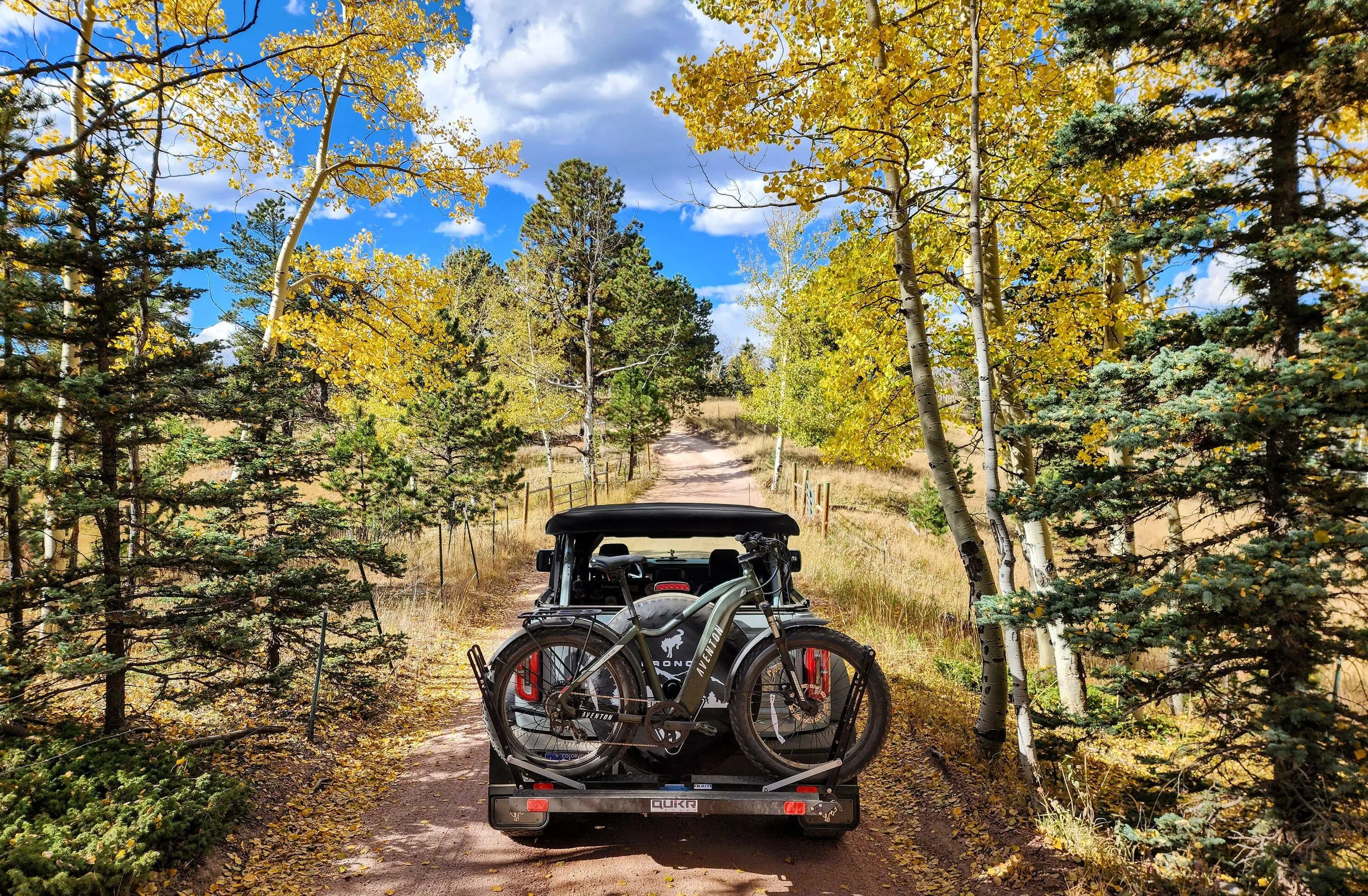

I got a Curt aftermarket hitch, it suits me fine, I may occasionally tow a small trailer but mainly use it for bikes and very small stuff like that. I mean the tow capacity is small anyways. It's mounting position is pretty robust. I did use it for a recovery a couple times and it's not bent or anything at all. Having said all that, it's not as solid as a full size receiver hitch for sure.
Second this, plus it’s simple to install.
