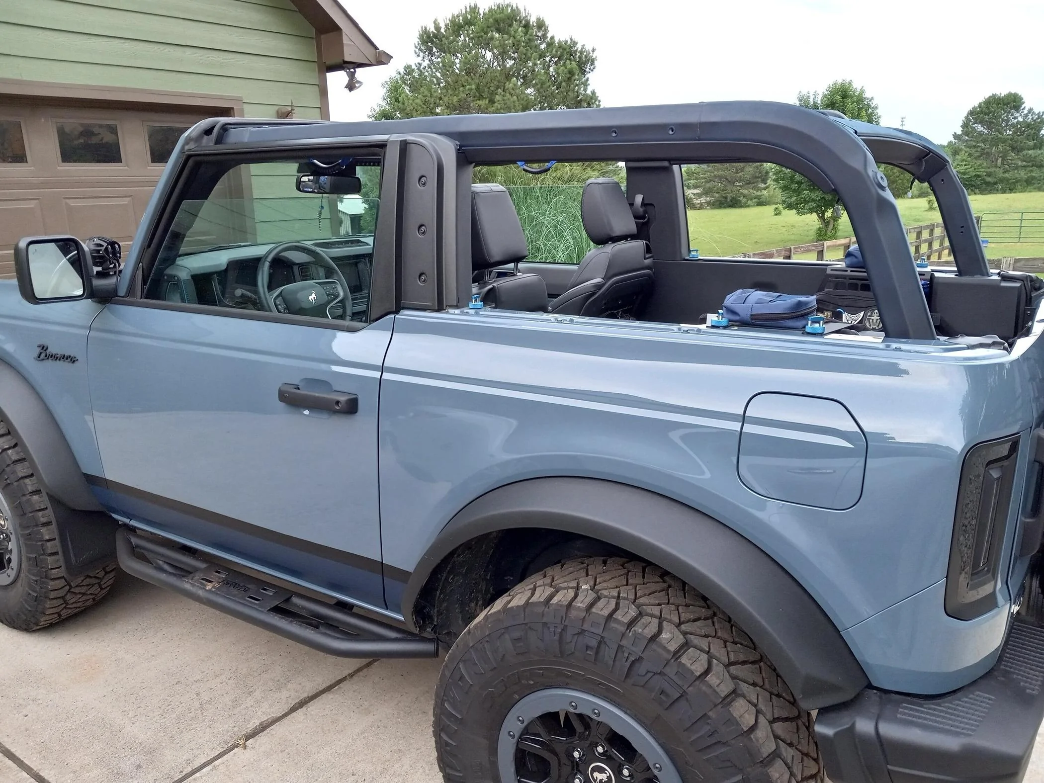

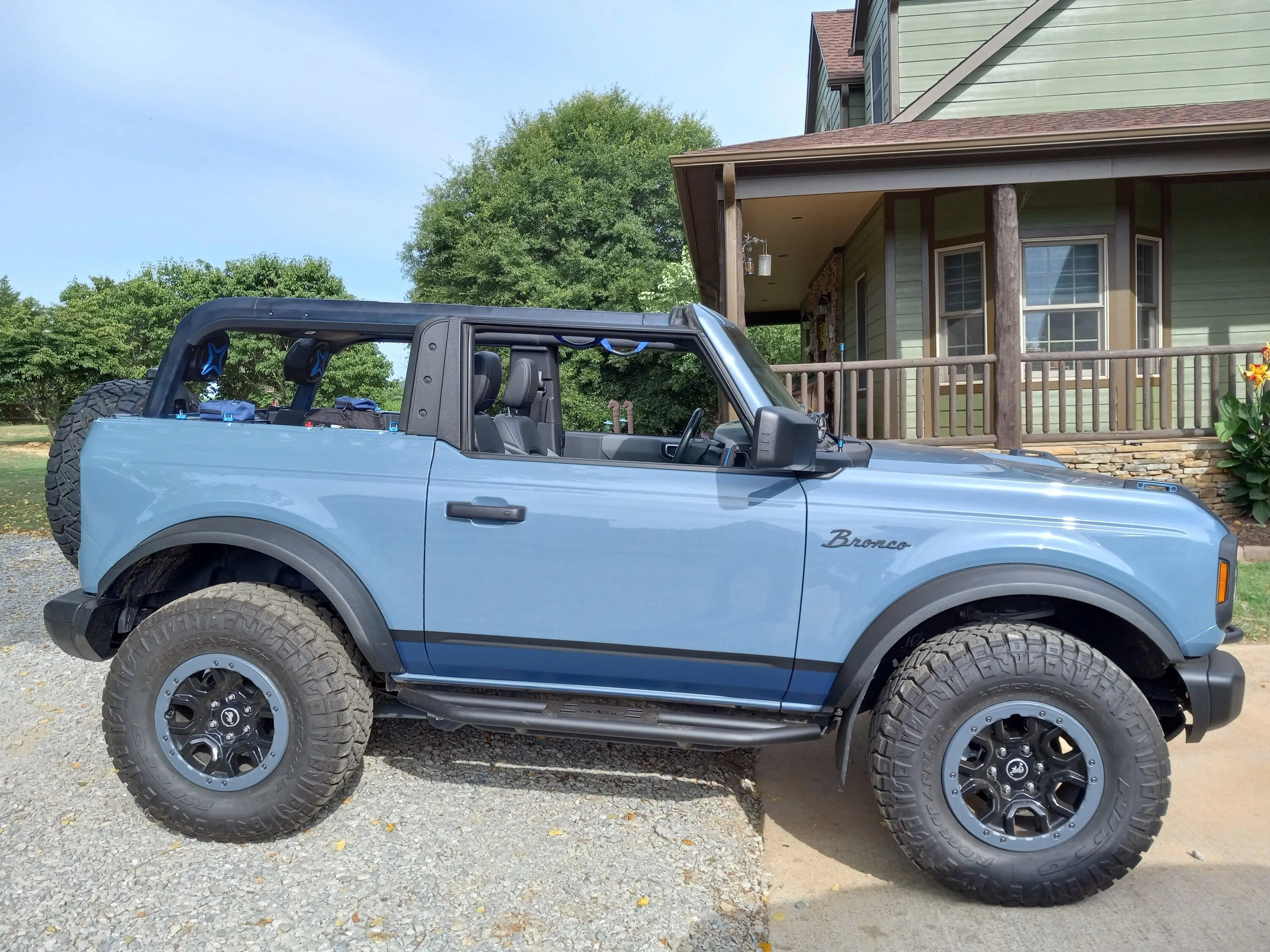

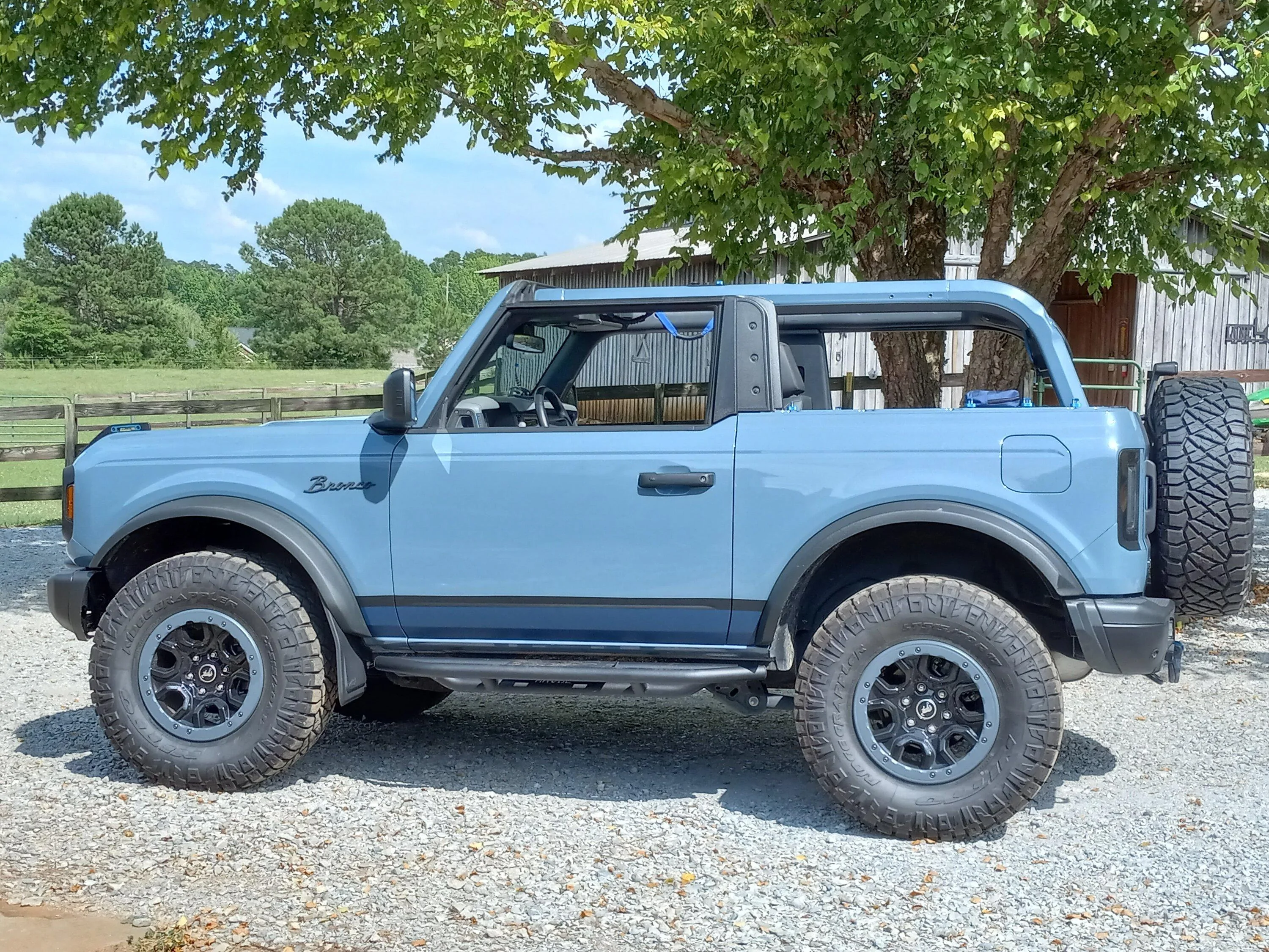

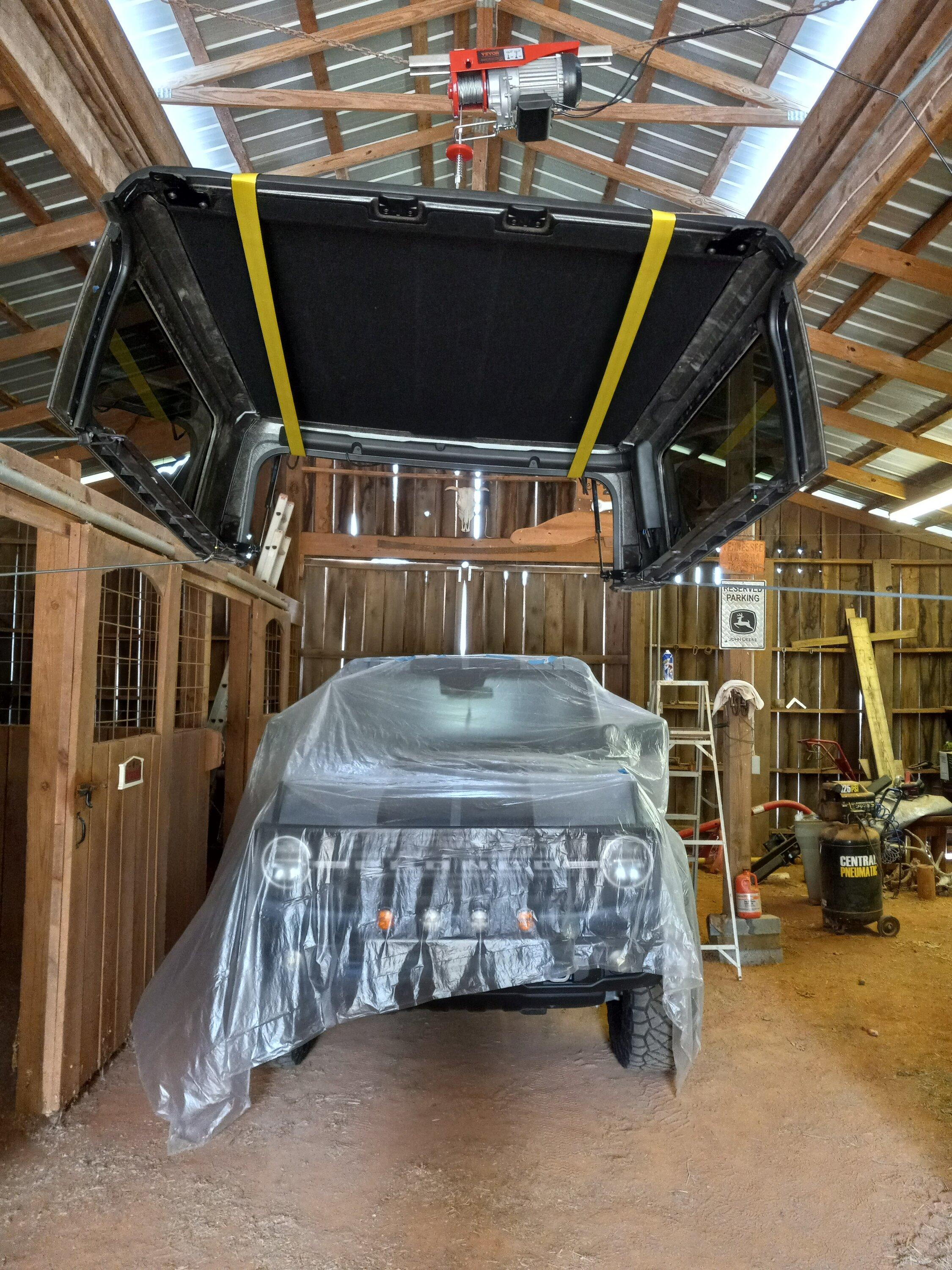

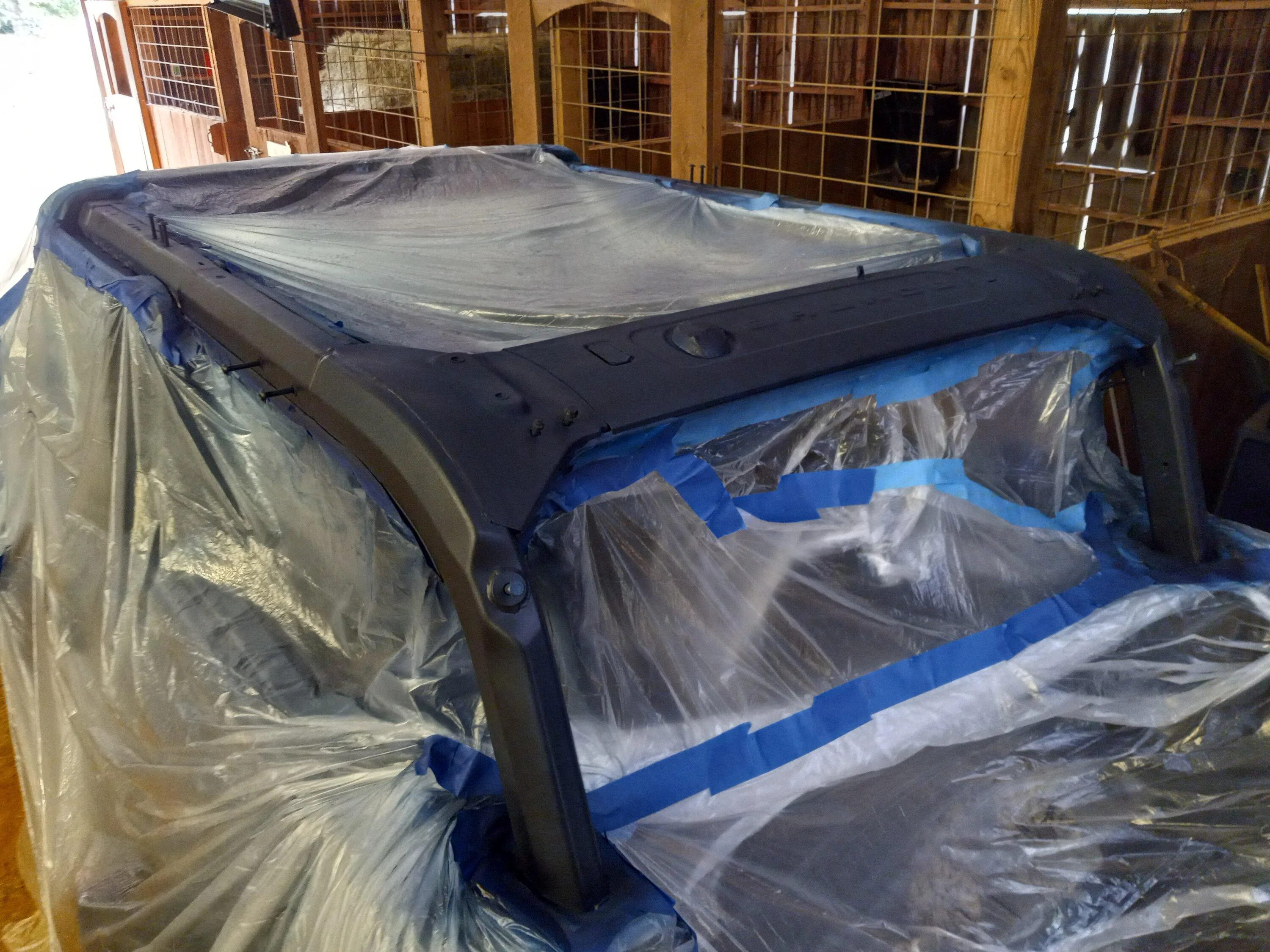

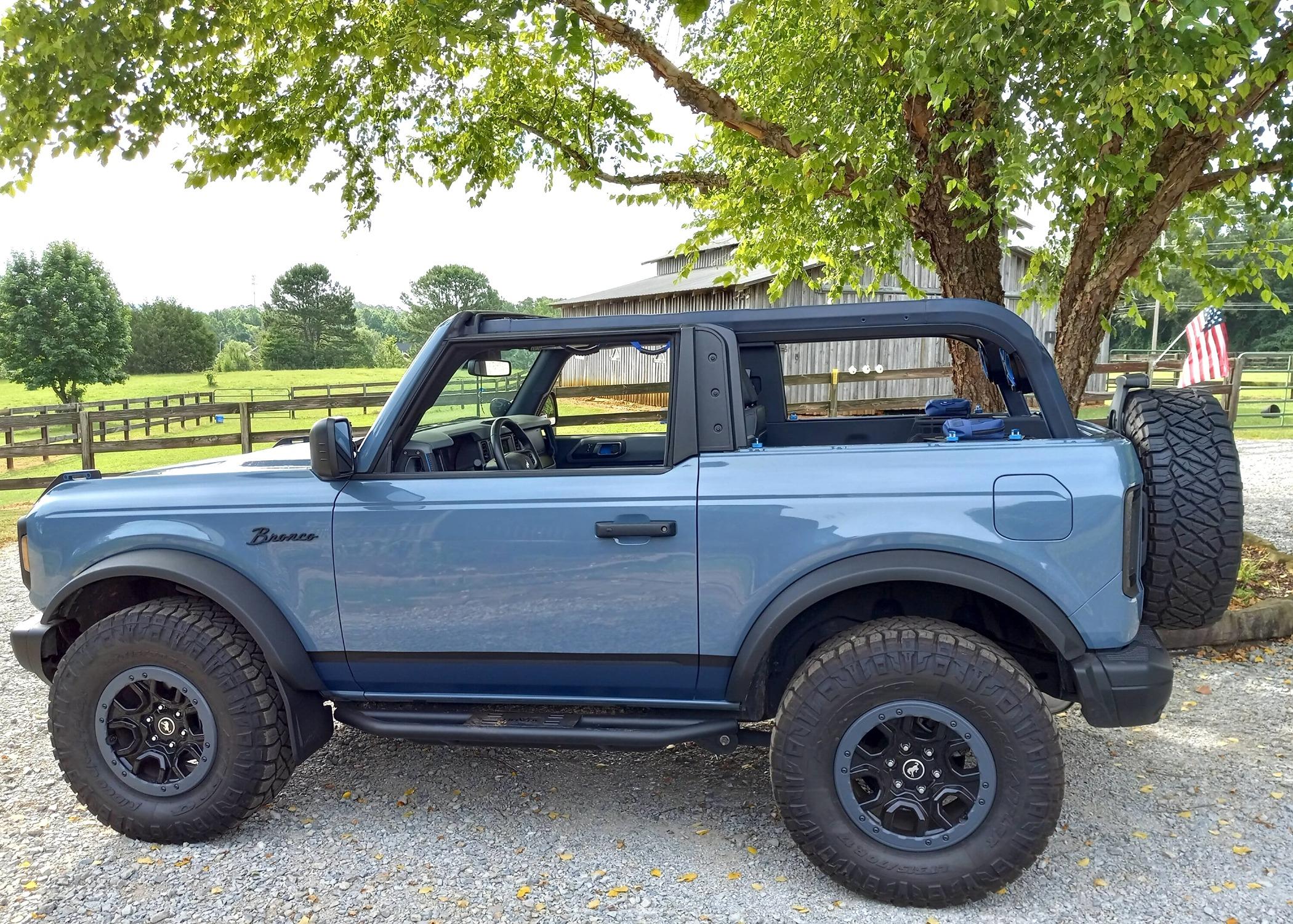

Painted KRAKEN's roll bar with Plasti Dip; color "black & blue". Was planning to wrap the roll bar, but after a close inspection of the roll bar's many welds, spot welds, holes, & slots I decided to just Plasti Dip it. Was going to do it black and then I found the black & blue color which plays well with my stripes & rockers. I removed the roof latch plates, speakers, and window molle brackets and installed temporary screws in all the threaded holes. I did not remove any plastic panels and just taped & draped everything which was a big pain in the @ss, but I got it done. I used two cans of Plasti Dip and got 4 good coats with a little left for touch up. Wish I had another can for a couple more coats. If you do this, plan on needing three cans.
Before & After:
Ford Bronco Plasti Dipped my Roll Bar 20240617_154615
Ford Bronco Plasti Dipped my Roll Bar 20240619_082339
Ford Bronco Plasti Dipped my Roll Bar 20240618_190337
Ford Bronco Plasti Dipped my Roll Bar 20240619_082534
Ford Bronco Plasti Dipped my Roll Bar 20240618_154644
Ford Bronco Plasti Dipped my Roll Bar 20240618_162357

Adhesion should be good... thorough cleaning with Isopropyl Alcohol/Water mix before application. This Plasti Dip does have a matte finish which goes well with my matte stripes/rockers.

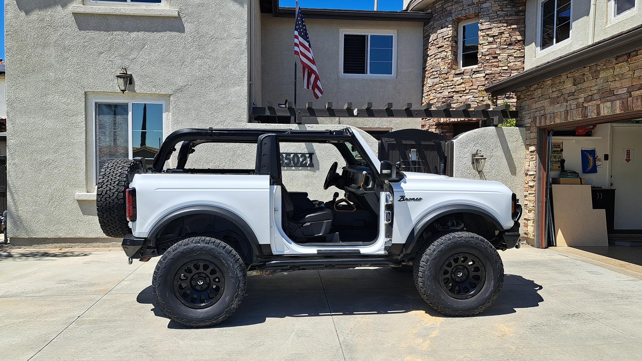

I did the same a couple a weeks ago. But I also did the windshield frame as well (which needs another coat or 2). I had done the door jambs last year too and it gives it a much better look when the doors are off.
