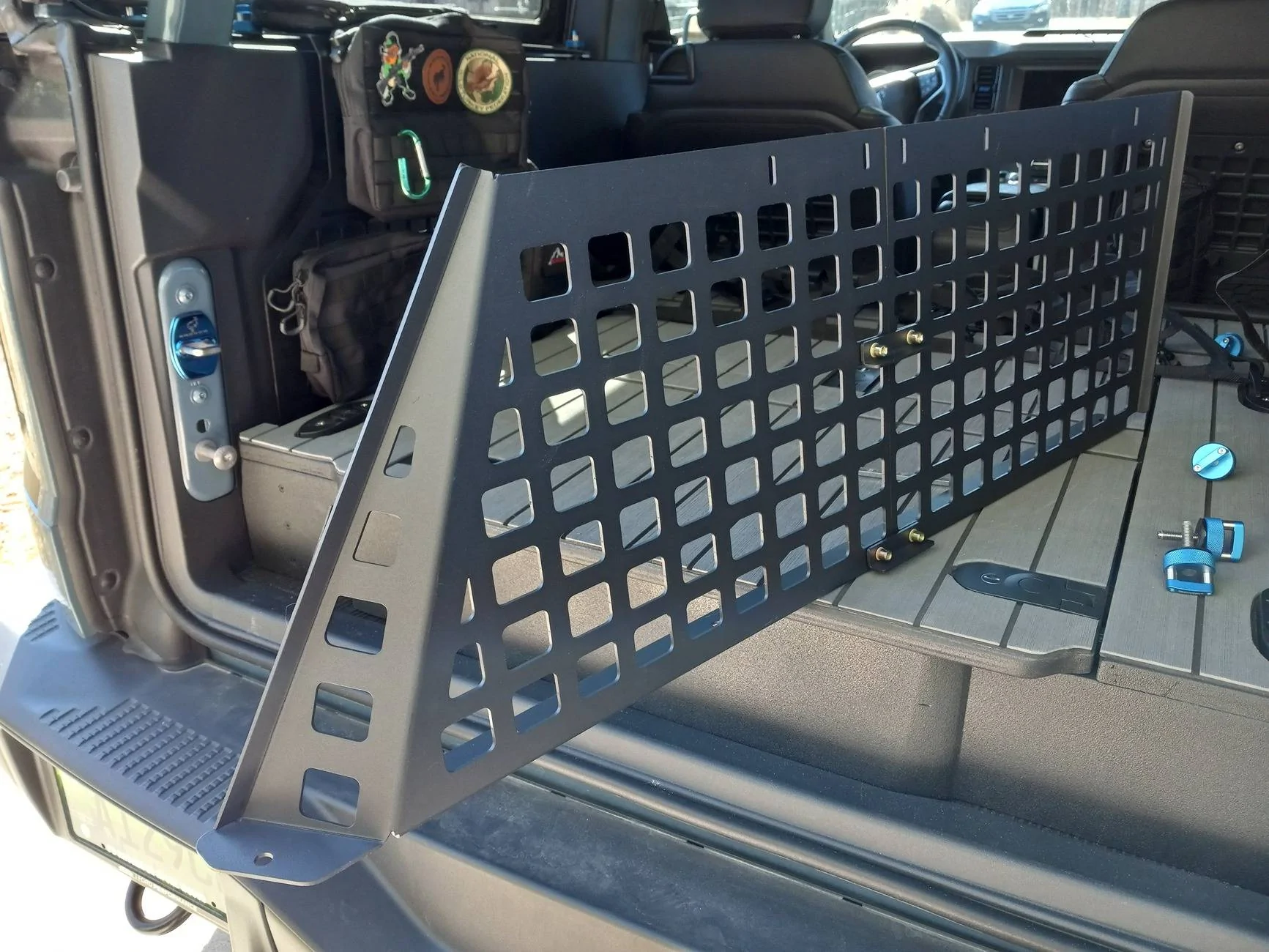

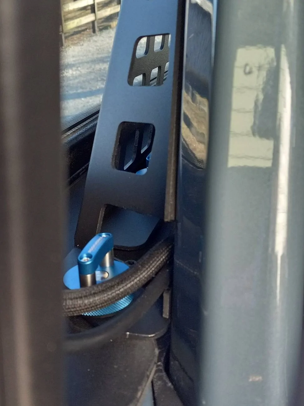

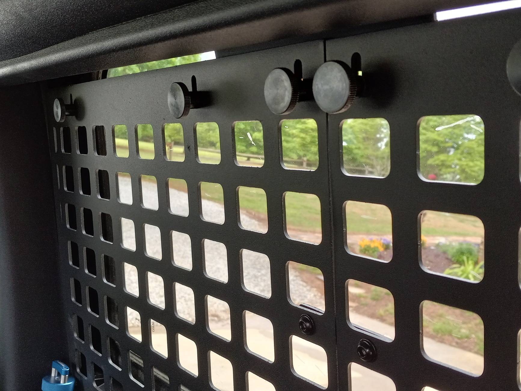

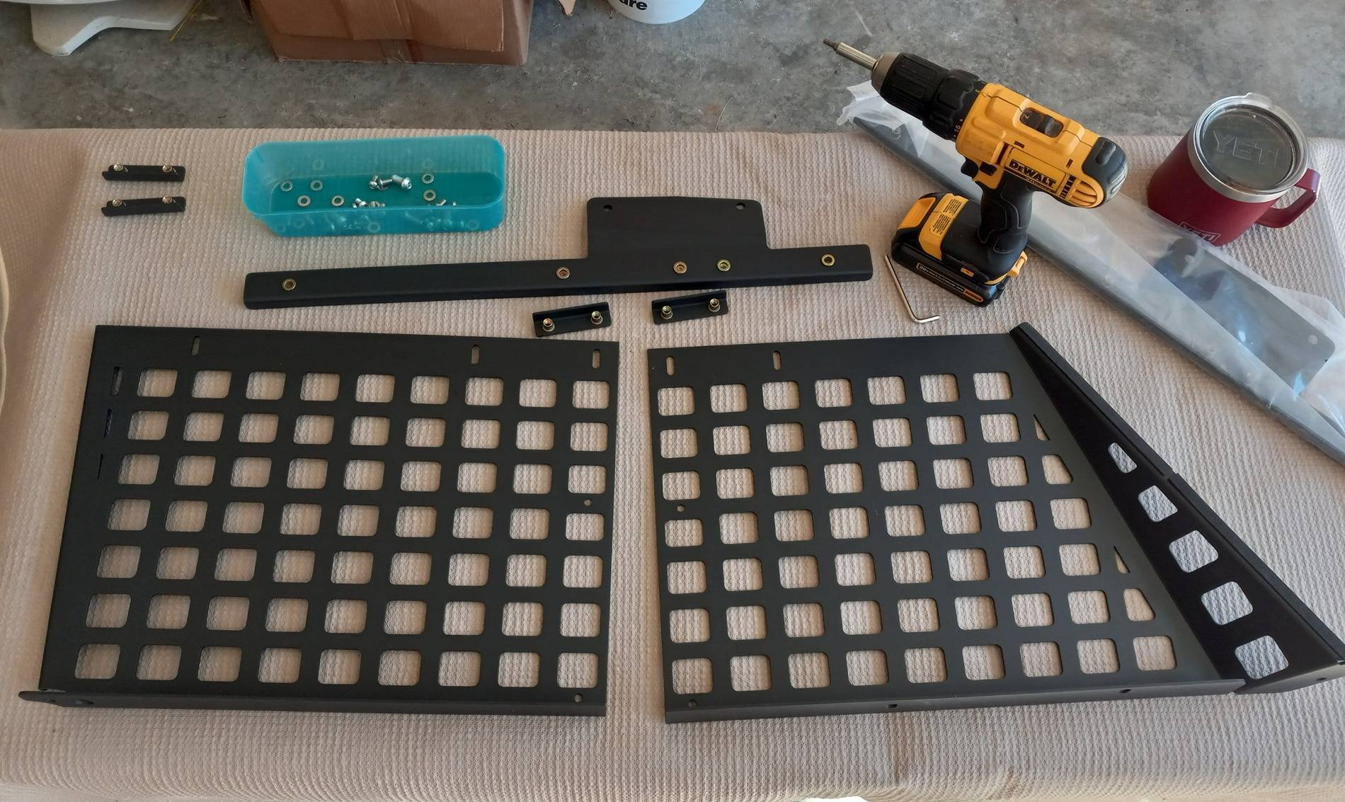

What back window molle panels are those? I'm looking for something that still allows for easy hard top removal and it seems like those have the screws on the inside if I'm seeing correctly?
They are TESIN brand from ebay. You have to remove them to get the top off. The bolts are on the inside of the bottom, but the back of the panel sits outside the roll bar so you can't just undo the bottom bolts and pull the panel in to clear the roof lip at the bottom. I put thumb screws in the top of the panels which along with the Rorkworkz bottom bolts make removal/installation tool free. Oh, and the driver's side needed modification to run the rear wiper hose through.
