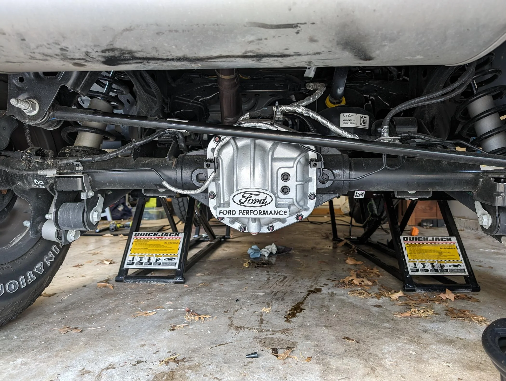

Finally got the cover. Gave up on FPP (Ford Performance Parts), my f’ing points, and my dealer and bought a cover on-line @ full price.
Here are my observations/opinions on the cover:
1) Cosmetically, major bonus points and style points. Not too flashy, but it is there….
2). Very will made and comes with the proper bolts including the threaded studs for the brake line clips.
3) Well packaged!
4) The installation went flawlessly. Draining of the fluid with the original equipment cover was messy. How come you never have a rag handy when you need one?
5). The original fluid was clean…. 28,200 miles. The oil in the untrainable portion in the bottom of the housing was fairly black. It appeared to me that the housing was designed for a bottom drain as several ounces of gear oil remain in the low spot of the Dana housing.
6) If you want to utilize the drain in the FFP housing to its fullest extent, you will have to do some grinding. From the photos, you can see that the way the drain system is fabricated, it forms about a 3/8” damn.. At 60,000 miles, I will probably again remove the cover and grind out the drain to reduce the amount of untrainable oil.
7) The Motorcraft Synthetic Gear Oil, $$$$$$, is very light colored.
Ready to hit the back country!!!

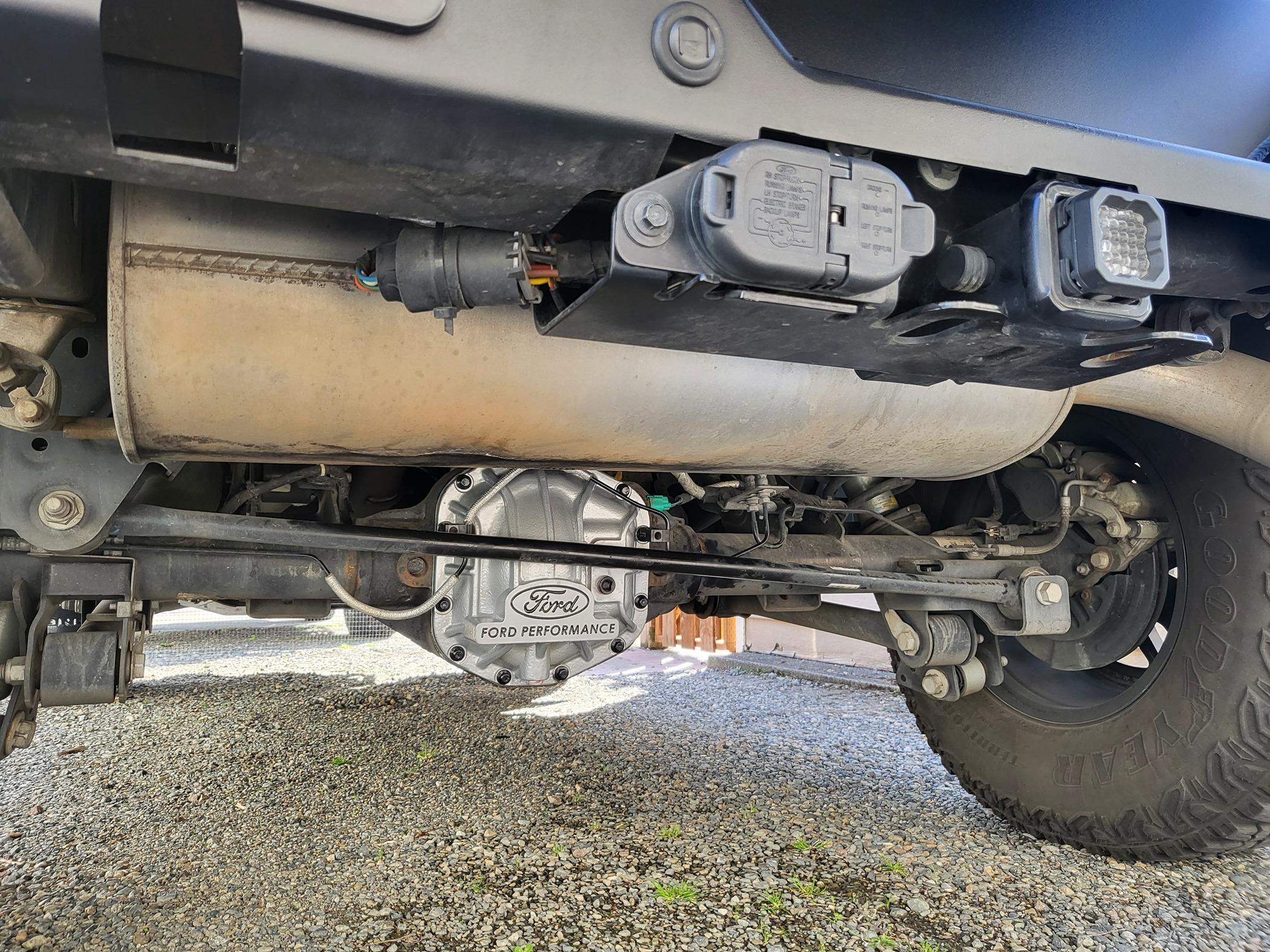

Agree. Did the cover when I did all fluids and not only does it look great it, it has a drain plug which is quick and easy.
