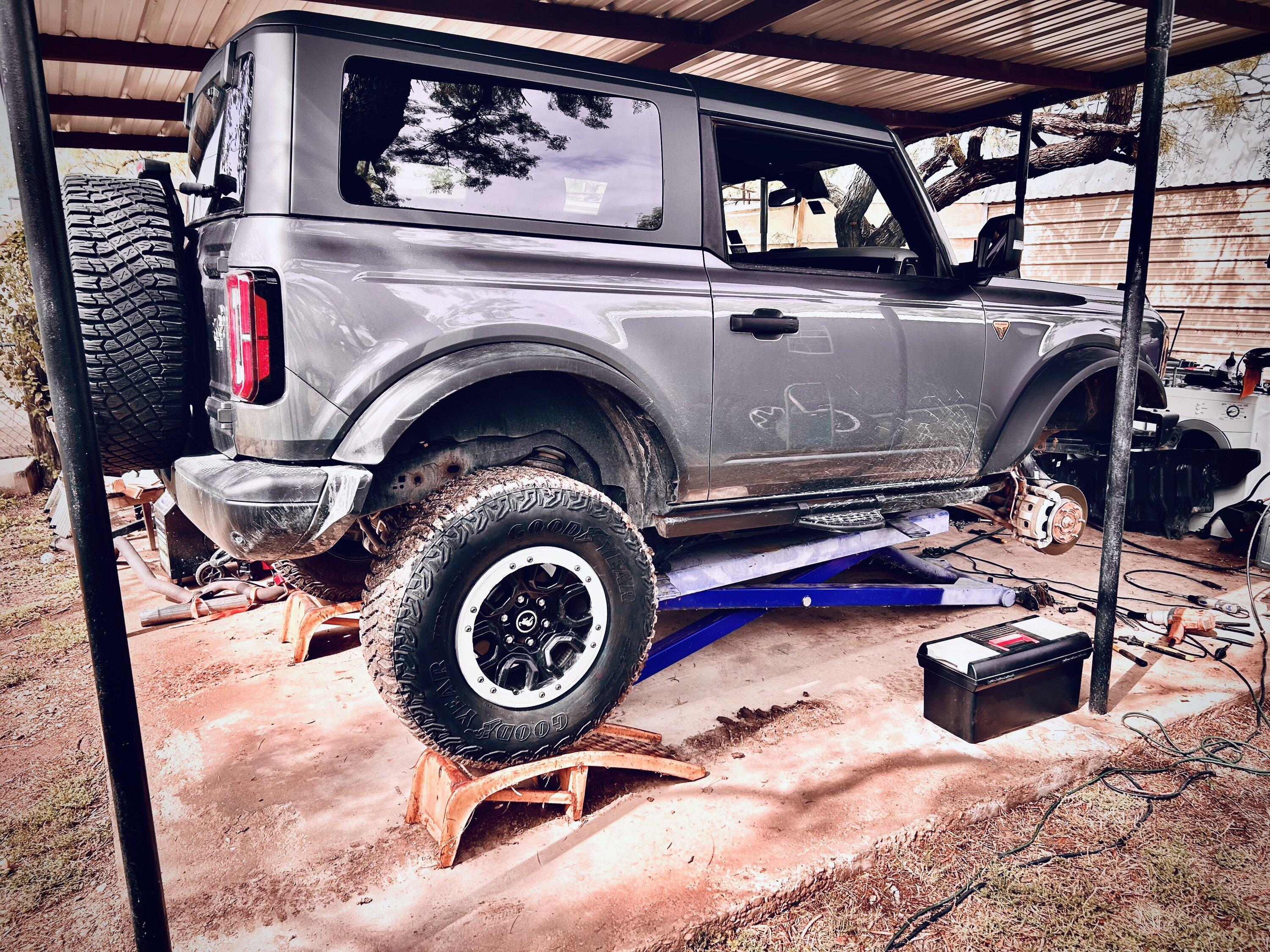

- Lift and/or ramps or jack stands w/jack (wheel chalks if you're using ramps or jack stands)

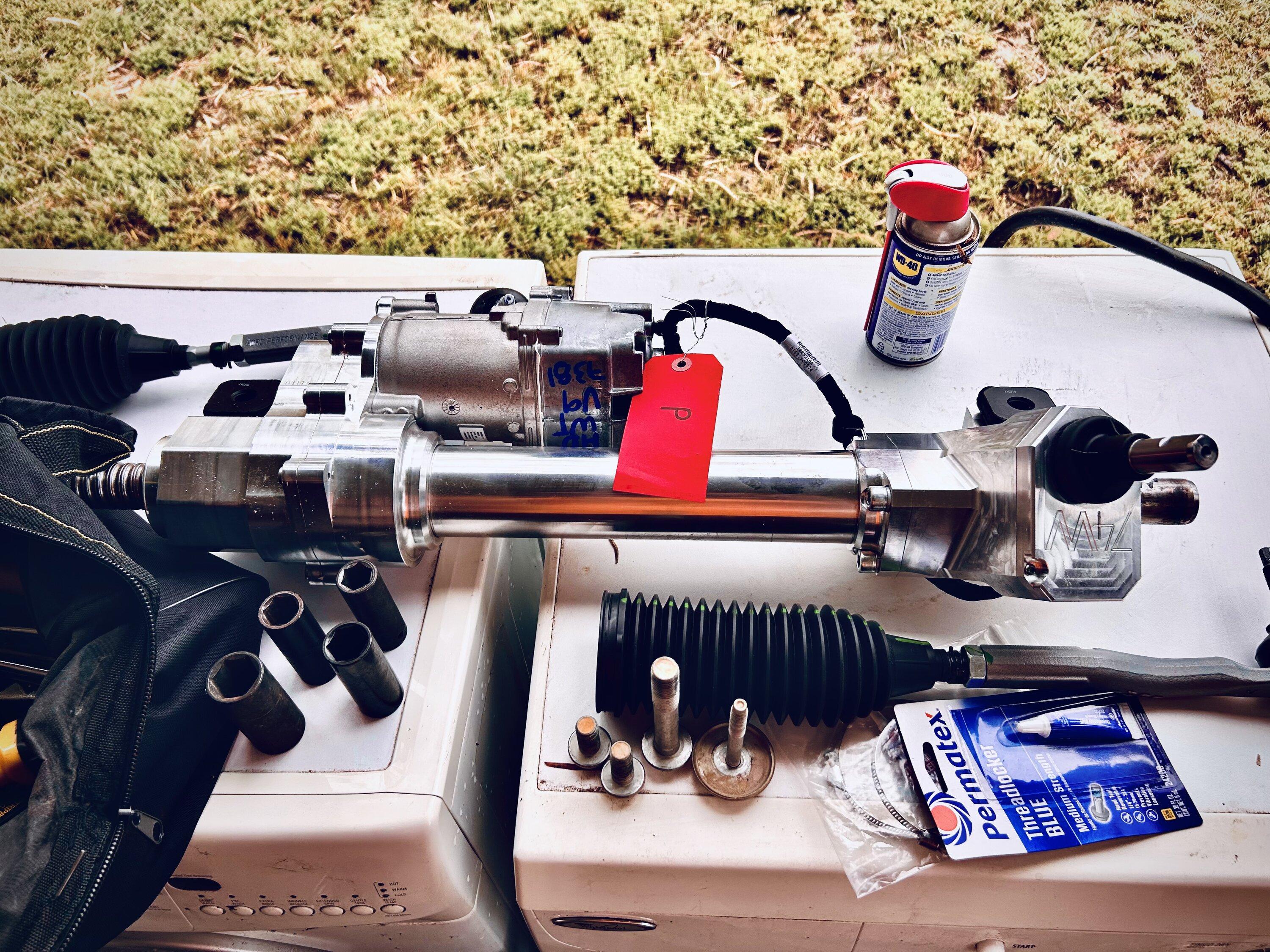

- 74Weld's rack did not take long to receive. I would've had it in four days if UPS hadn't had a broke down truck.
- Consider, if you are going with 74Weld's rack and you don't have a HOSS 3.0 yet, it could very well be cheaper to just buy their packaged Stage 3. Especially consider at least right now they have an OnX Elite discount that is substantial, as well.
- If you do have a HOSS 3.0 rack already, get the Stage 2 and get it programmed. mpeugeot does them at least in Texas. You might ask him if you're looking for programming.
- The box 74Weld's rack comes in is small enough to fit in the back of my 2dr. The tie rods are not installed, in other words.

- Important: Immobilize the steering wheel from turning FIRST. A slight turn is not bad, but a quarter or half turn can mess up your clock spring, which I hear is a Bad Thing. We used a ratcheting strap, wrapped around the bottom of the steering wheel, then fed under the seat and hooked one end to the headrest post, then ratcheted down. This worked pretty well.
- Watch the 74Weld install video and note that they do not at all show disconnecting the steering column from the rack. Completely omitted, probably because it's hard to show it.
- The order that the bolts are removed and put back matter in making it easier to take care of. The order in the video and reversing the order to reinstall is probably a good starting point.
- Make sure and pay attention to the direction the steering column set screw points. lol Not a big mistake, but if you have slip in your steering, check this screw is too loose or is reversed from how it should be.
- Take the front tires off once you've got it jacked and secured. You see this in the video.

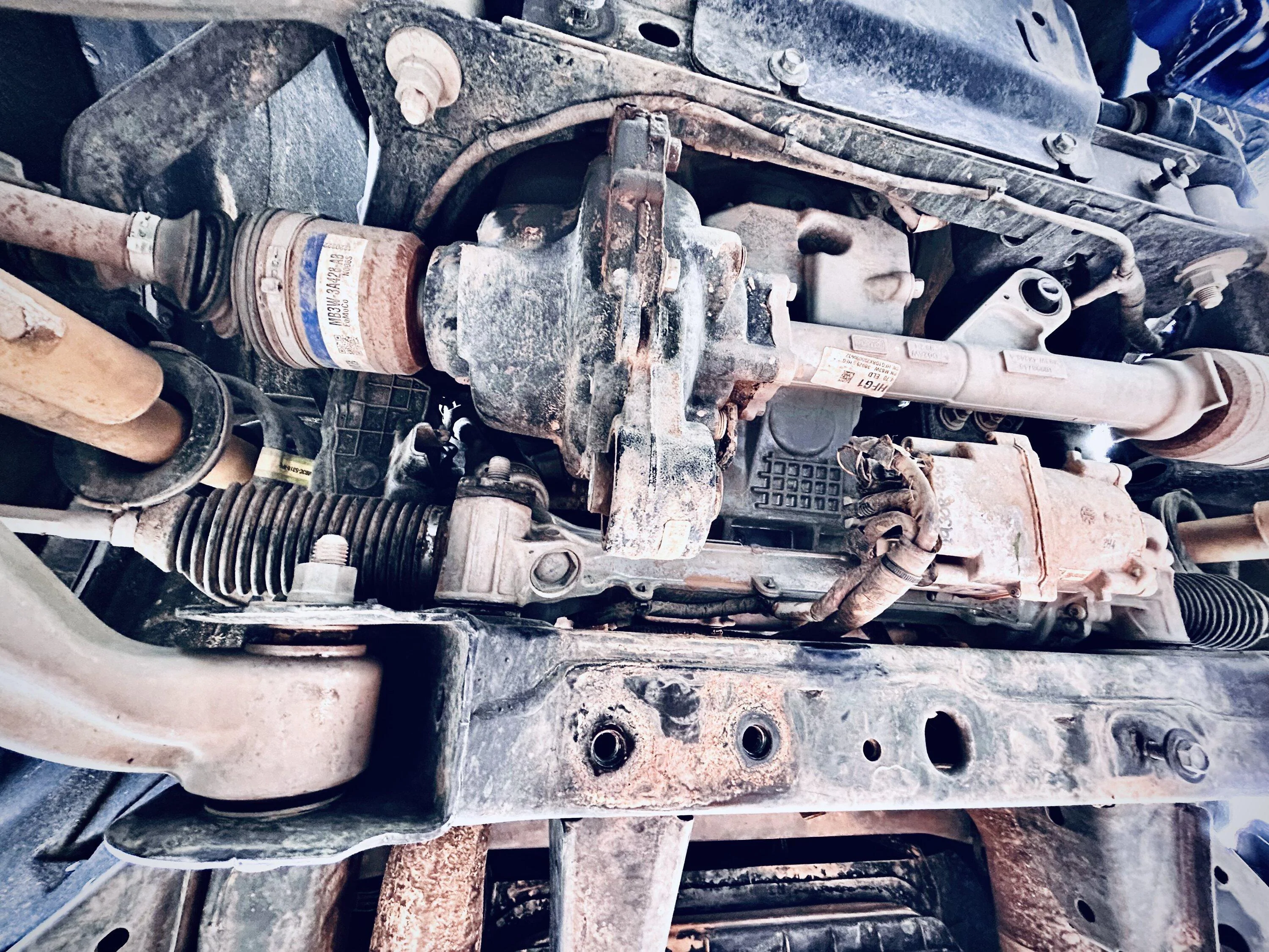

- We took the inner tie rods off the rack while the rack was still in place. I guess you could leave them on, but I don't know how you get the rack out.
- Other than the hassle of breaking the bolts out of their loctitedness, the first big hurdle is getting the tie rods off the wheel. We ended up heating the mount the outer tie rods sit/drop in, hitting the seat with a hammer, then heating some more. They eventually come out but expect they will be wedged in there pretty good.
- Wrangling the HOSS 2.0 steering rack out of it's cozy little spot is a lot of fun! Not really. I have the front lockers, so getting around that is where the snag happened for us. We pushed, pulled, crushed my hand and finger, and eventually wended it around somehow (pull passenger and push up and twist!!!). It was a good feeling when it finally came out.

- The 74Weld rack is easier to get in. It didn't slide right in, but we didn't really struggle.
- Pay attention to the direction of the steering column clamp bolt.
- Measure the lengths of the tie rods when you have them both out. Make sure you compare the left and right side with their matching new tie rods. They should have stickers to designate the left or right side when reinstalling.
- You don't have to loctite every bolt, but make sure and do the big bolts on the frame.
