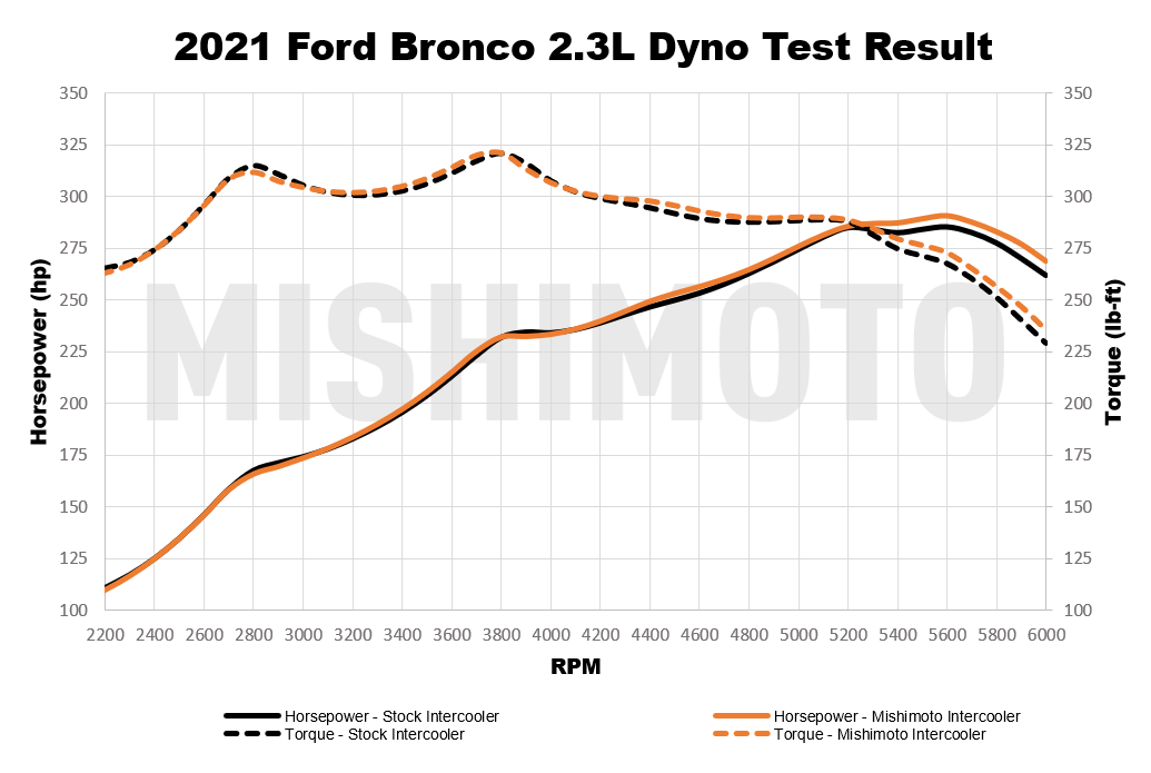

The nature of the i4 does make shifting a little bit different than a standard naturally aspirated engine - not all of it is due to the turbo though. This engine wants high rpms, and your torque really suffers under 2k, There is a really steep torque ramp up from idle to 2k and it really hits it's stride at 2.5-3.5k. Peak torque is around 3.5k, and peak hp is around 5.5k. A lot of larger engines, or older naturally aspirated ones, you'd usually shift before 2k RPM for fuel economy and easy shifting, but this engine lugs at those lower RPMs.
The fact that almost every dyno run I see for the 2.3 starts out at 2k, they aren't even testing anything lower, I think makes the curve look a lot flatter than it really is (and it's pretty peaky even with that data omitted)
(Stolen from Mishimoto Intercooler page - it's the best stock dyno chart I could find)
