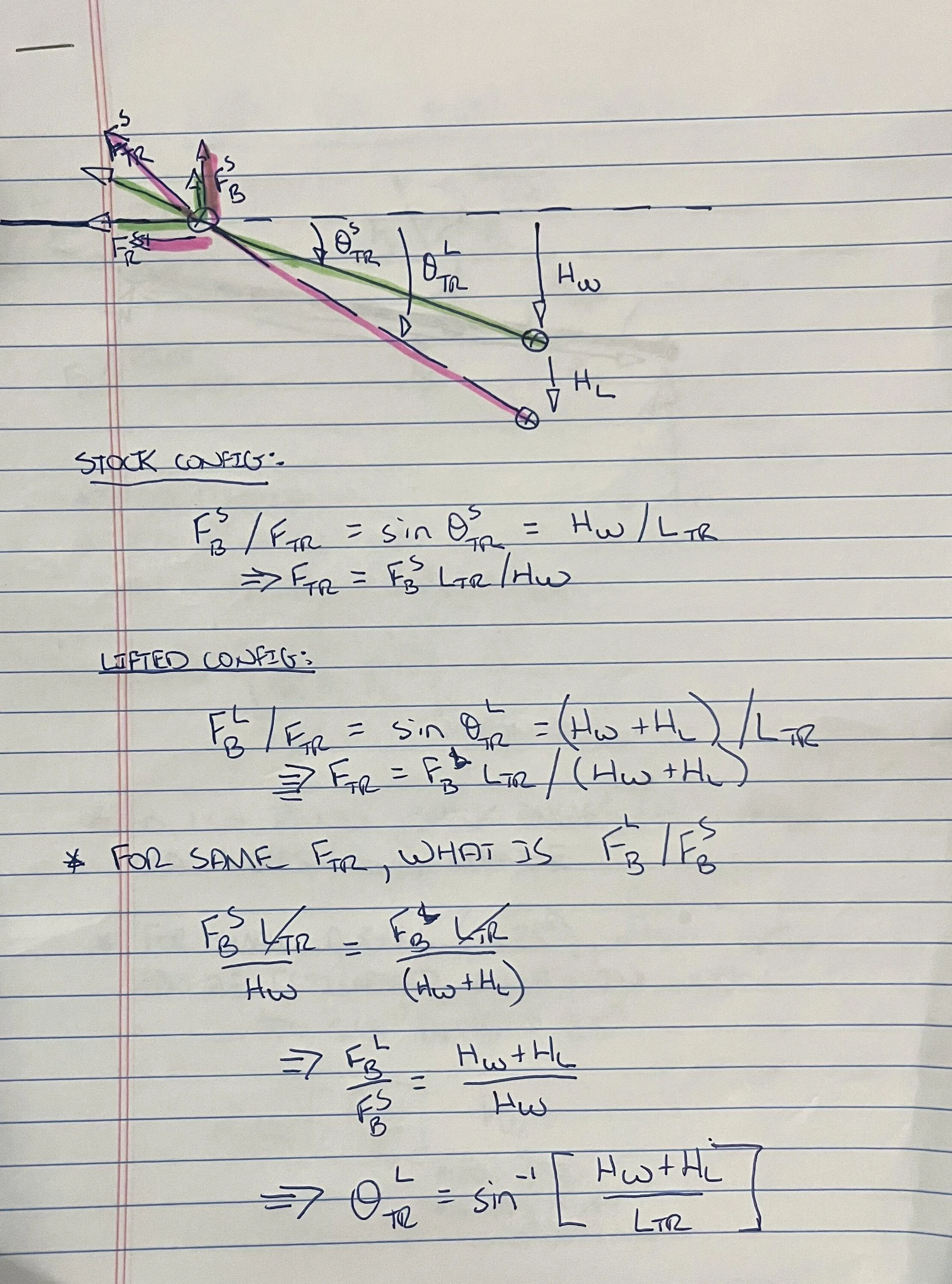

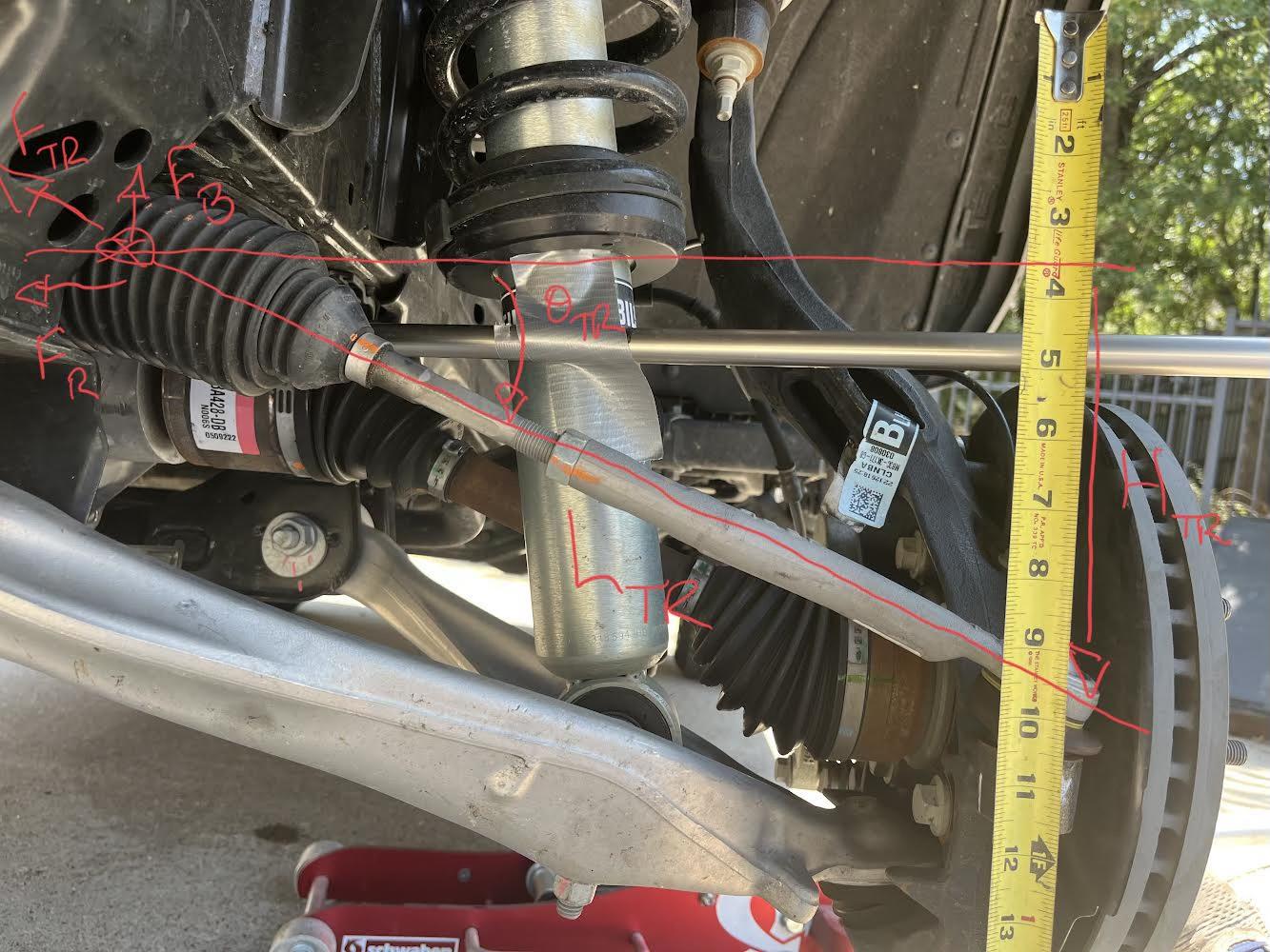

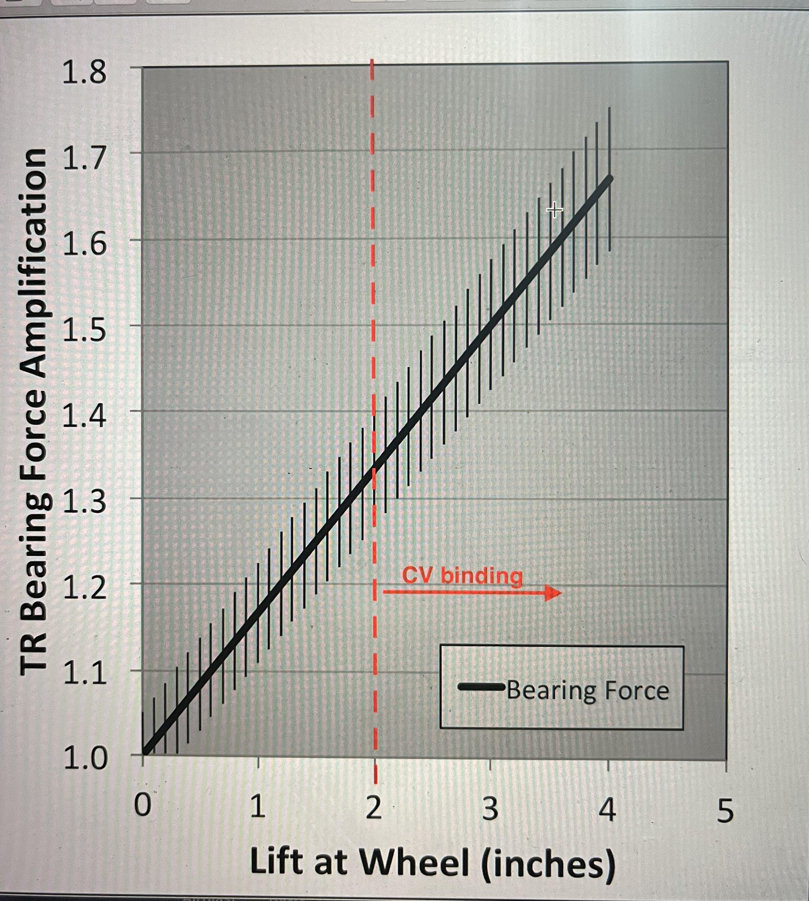

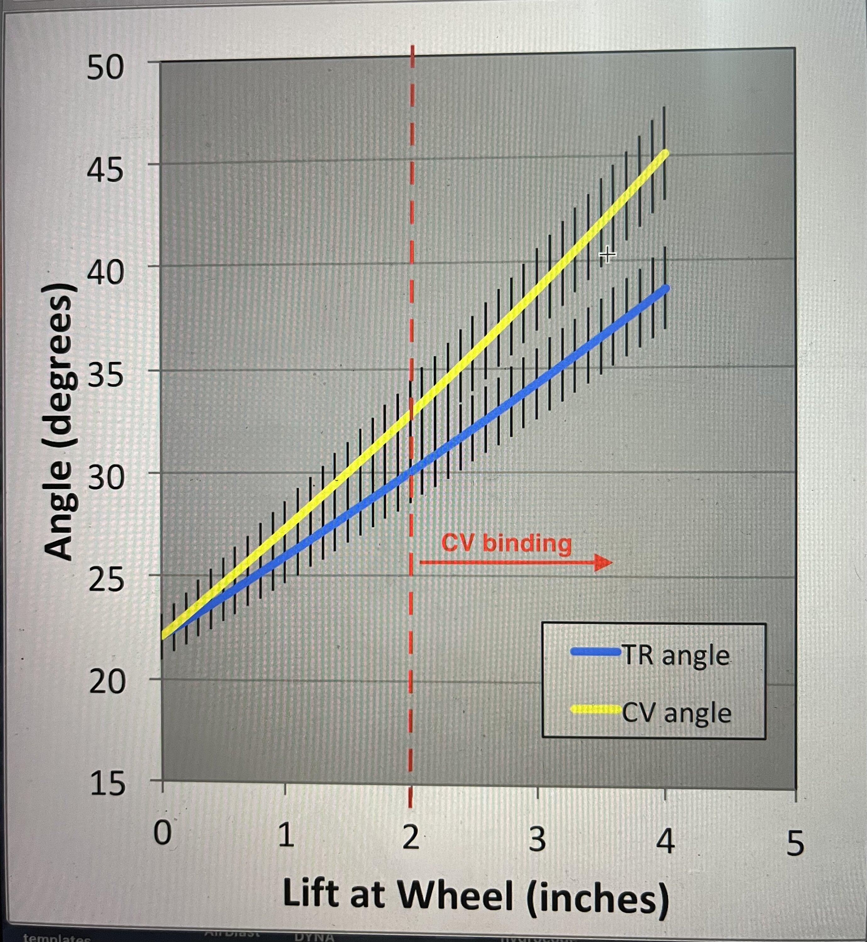

74 weld most likely does not want to provide any guarantees for their stage 1 kit because bushing forces get amplified quickly as a function of lift. Those bushing forces must be carried by the OEM HOSS 2 housing, which they did not make and therefore can’t really guarantee. Hence the reason for their full billet housing.
attached are some basic bushing amplification factors wrt wheel spacer lifts. The zero reference point is full drop on my SAS geometry. A mere 2” lift at the wheel (spacer lift) results in more than 30% increased bushing loads. Also shown are tie rod and CV angles at full droop wrt lift at the wheel. Angles also go up quick. The error bars represent measurement errors.
One thing for the masses to keep in mind which I’m sure you know is that ANY suspension lift changes tie rod and axle angles therefore increasing the impact of load, not just a spacer lift. The only real difference between a spacer lift and a coilover lift (or perch collar for that matter) when it comes to angles is that the latter will limit down travel and the former does not limit down travel, only adds to it.. Since a spacer lift doesn’t limit down travel it will quickly expose the tie rods and other components to angles they were never even close to being designed for or intended to survive.

Indeed. Spring compression lifts increase angles and loads at ride height. These loads are not as severe as full droop but occur for >90% of on road driving. The charts were generated for full droop but can also be generated for spring compression lifts. They would then have a different origin or starting angle.

The charts are not meant as absolute values. They just show how quickly loads and angles can increase. Lifting the front end has consequences.
However, the slopes of the curves are relevant. With your 2” spring lift you have probably increased the tie rod angles by 10 degrees at ride height. And maybe increased loads by 20% at ride height. No idea what the design limits or envelope of the steering rack is. But you are doing better than most since you have the 3.0 rack. It really depends on how you drive and where you drive. You are probably good, but others with a 3.0 rack can better answer that.
based on the real world feedback from this forum, more than 2” lift with 37s and the HOSS 2.0 will likely eventually cause issues. 🤷‍♂️
