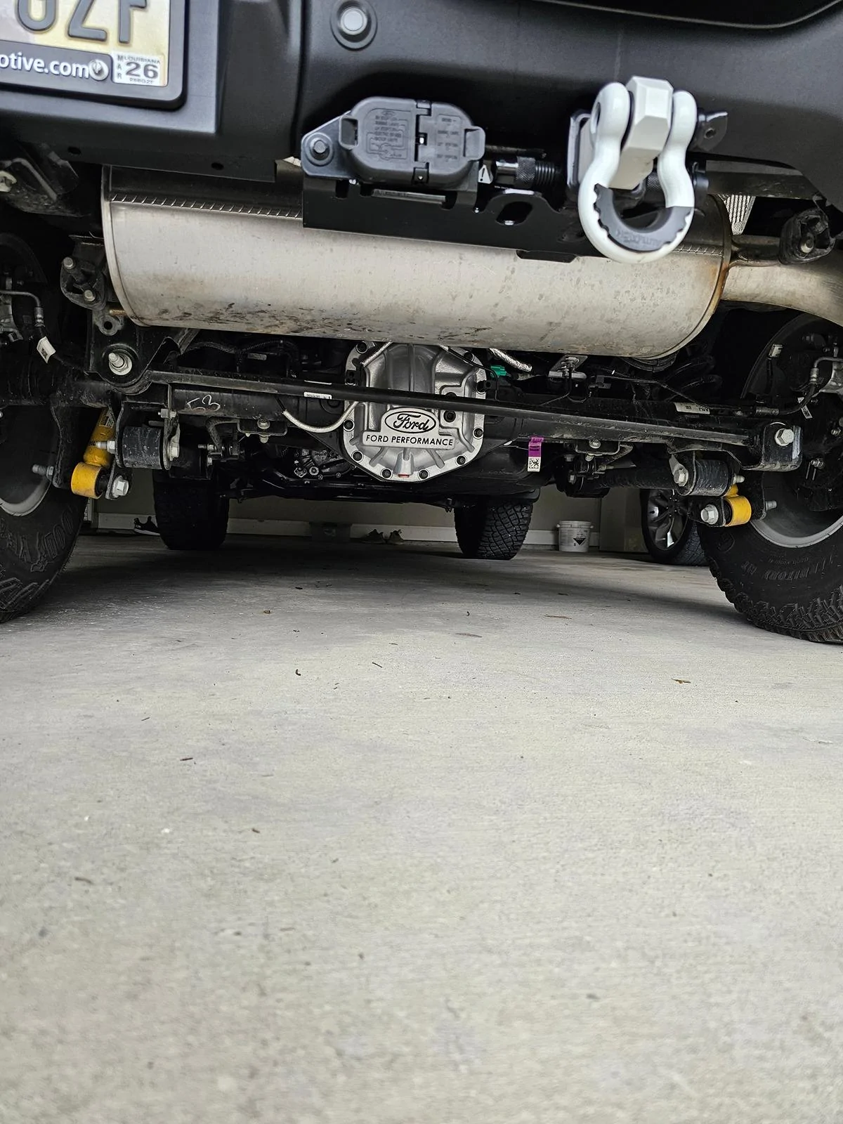

I'm more interested in keeping my vehicle for several decades, rather than shaving 0.2 MPG, so I installed 2 quarts of Mobile 1 Synthetic 75w140; $20/qt at Autozone.
I also installed an ARB diff cover which has a magnetic O-ring sealed drain plug, and a horizontal o-ring fill plug, with magnetic dipstick.
Same price as the Ford Performance diff cover.
Your mileage may vary...
