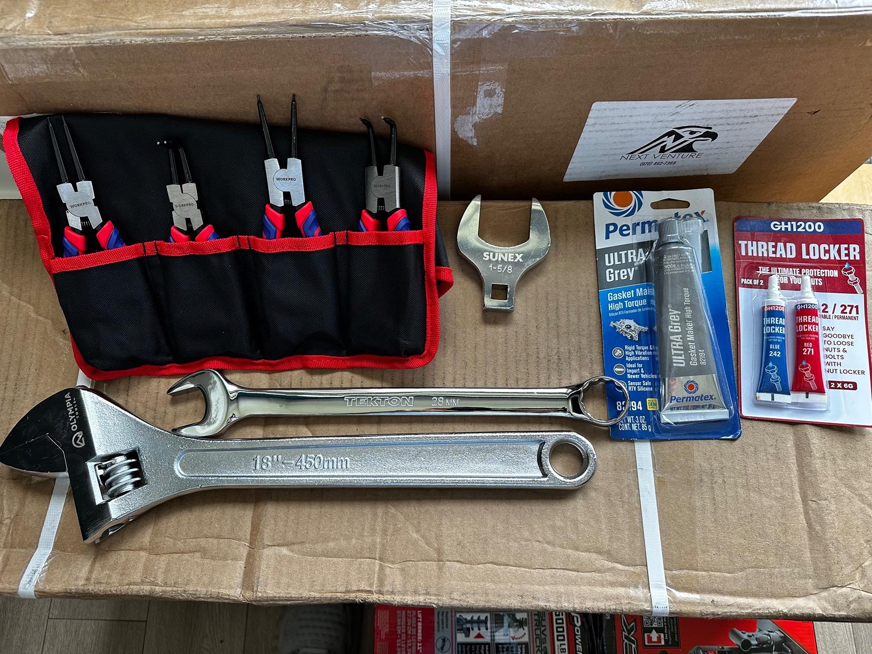

You guys think I’m good to go? Missing anything?
Standard tools covered… wrenches sockets etc
18” adjustable wrench
28mm crescent
1-5/8 crowfoot for putting on the Icons
Lock ring pliers
Thread locker/rtv
28mm crescent
Lock ring pliers
Thread locker/rtv
28mm crescent
Lock ring pliers
Thread locker/rtv
Gasket scrapper or razor blades and compressed air to blow the crud out.

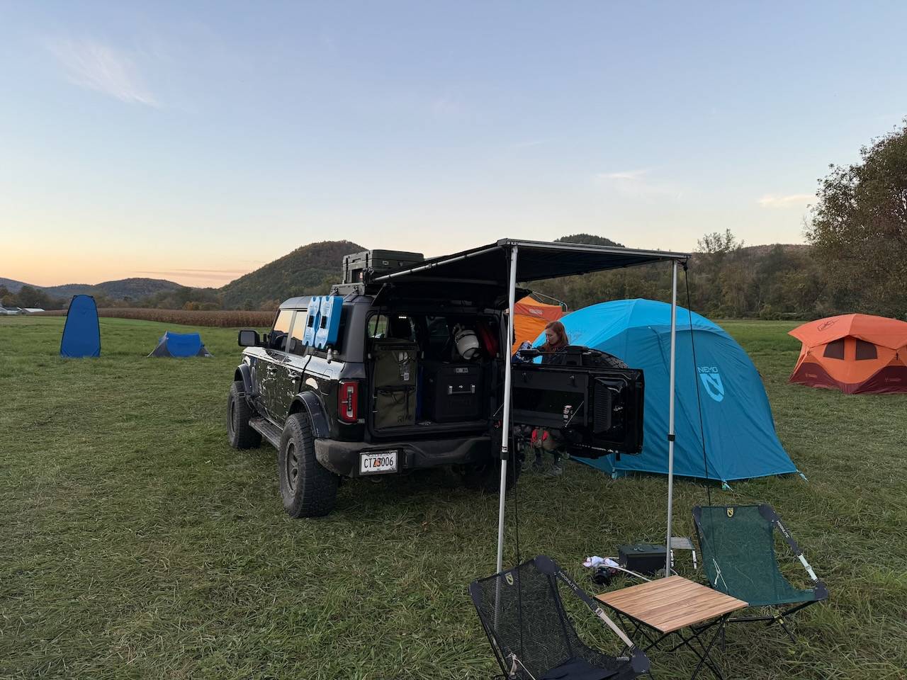

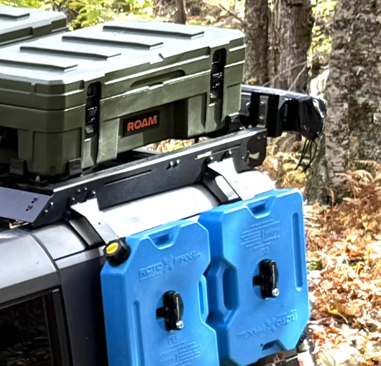

I’m literally in the process of installing the awning, roam rugged mounts, and my Starlink on the rack this weekend. It has been a freaking jigsaw puzzle. I’ll try to snap some pics today. I was at it all day yesterday and had to change my original plan on mounting the awning brackets and didn’t realize at the time that would change the mounting position of how far out I needed to extend the bracket. So after spending all day with it I had to pull the awning brackets off so that I can drill new holes in the “L” bracket. Such a pain. I think it will all come together. It’s just been a nightmare because the brackets are steel and keep melting my drill bits.

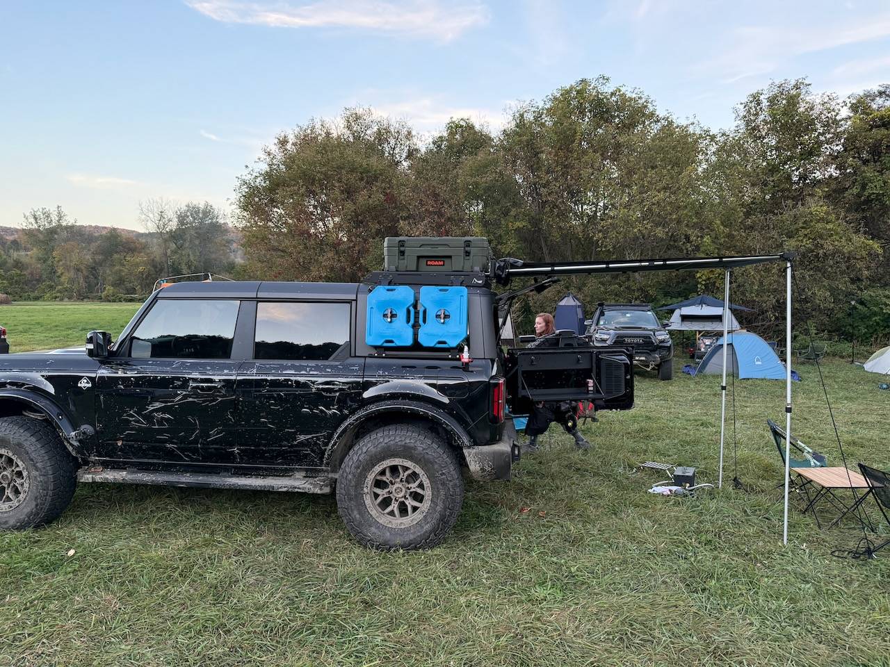

Thanks for the feedback. Are you okay with the four foot awning? I was considering the five knowing that it would extend about 6 inches on both sides of my roof rack. Do you plan on keeping the awning on all the time or just when you travel/need it.

I used these: https://racksbraxusa.com/hd-racksbrax/ They allow you to remove the awning when you're not camping without having to remove the brackets.
The 4ft was perfect for our needs and the fit is exactly what I hoped for. I think a 5' would be too big and hang off the sides too much. I unfortunately don't have a straight on shot from the rear and I've already taken it off. It's hard to tell, but it hangs off about 1.5" past the edge of the rack, but does not push out past the pakrax on the sides. I'd knock off a Rotopax before I'd clip the edge of the awning by a good margin.
Attached some pics of the starlink mini mounted and the awning.

Great Information. I'm also using a half roof rack and the same roam gear. Looking at you awning pics I believe you are correct about the 5 foot poking out a little to far. Saved me a return, and thanks for adding the links for how you attached the awning. Perfect response for me.
