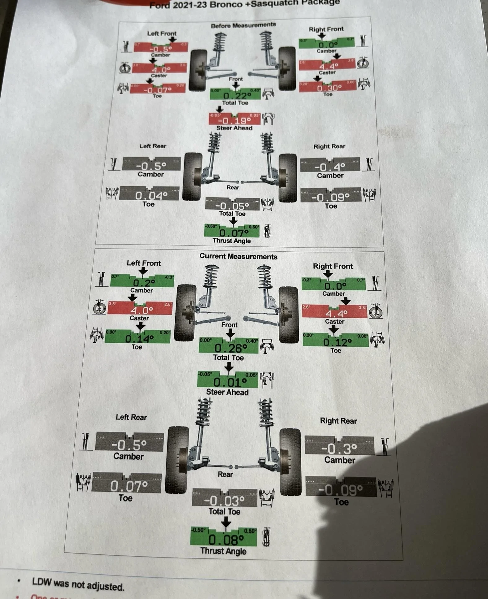

Approximately how long did it take you and how soon after install did you get an alignment?

Aligned. Didn’t mess it to bad.
