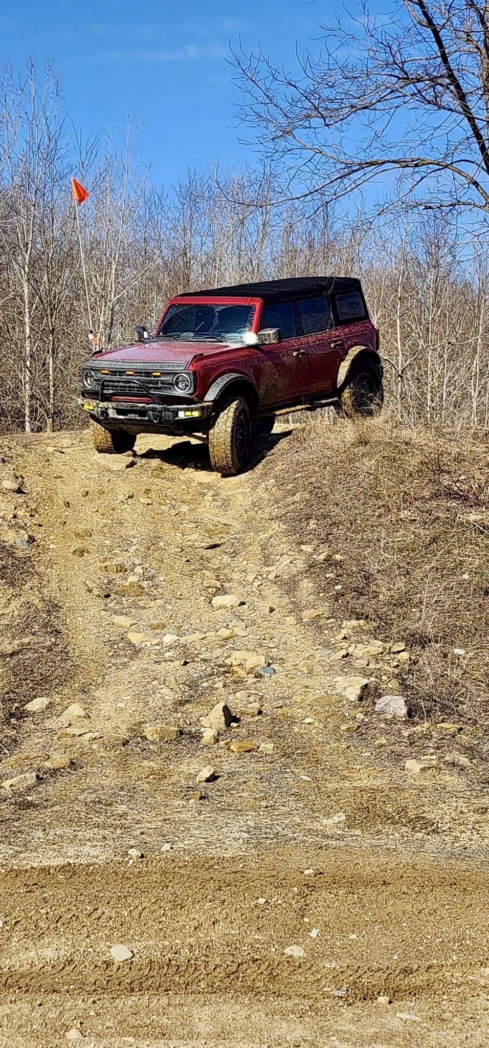

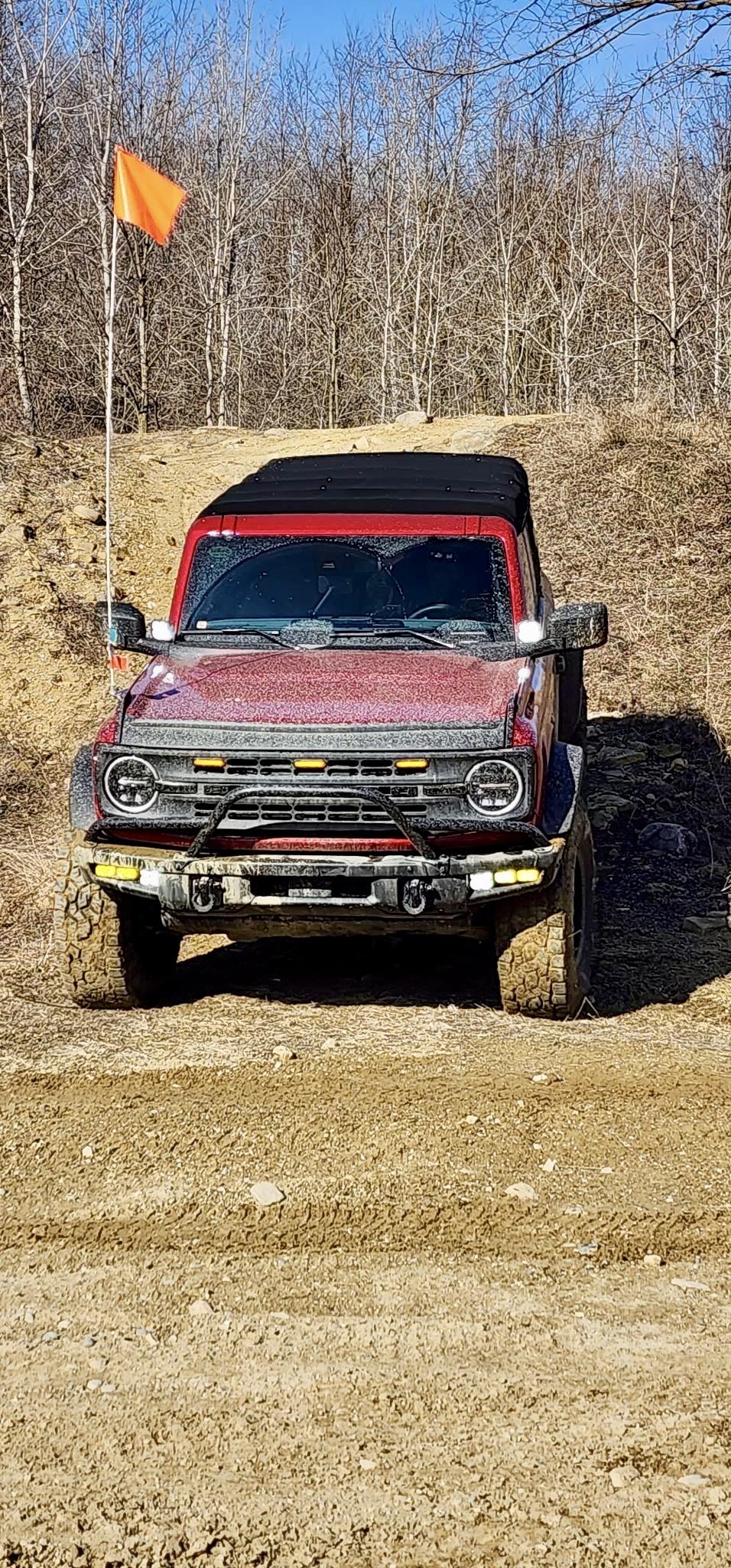

Approximately how long did it take you and how soon after install did you get an alignment?
It took me 4hrs 12:00pm Friday till 4:00 but that was from tools assembly-after box removal of tools new sockets etc. organizing jack & stands to clean up.
Test drove verified all was well and she was tracking straight. Today 11:00am got an alignment. So 24hrs to alignment.
Ford Bronco 74weld stage 1 steering upgrade DIY install IMG_1175

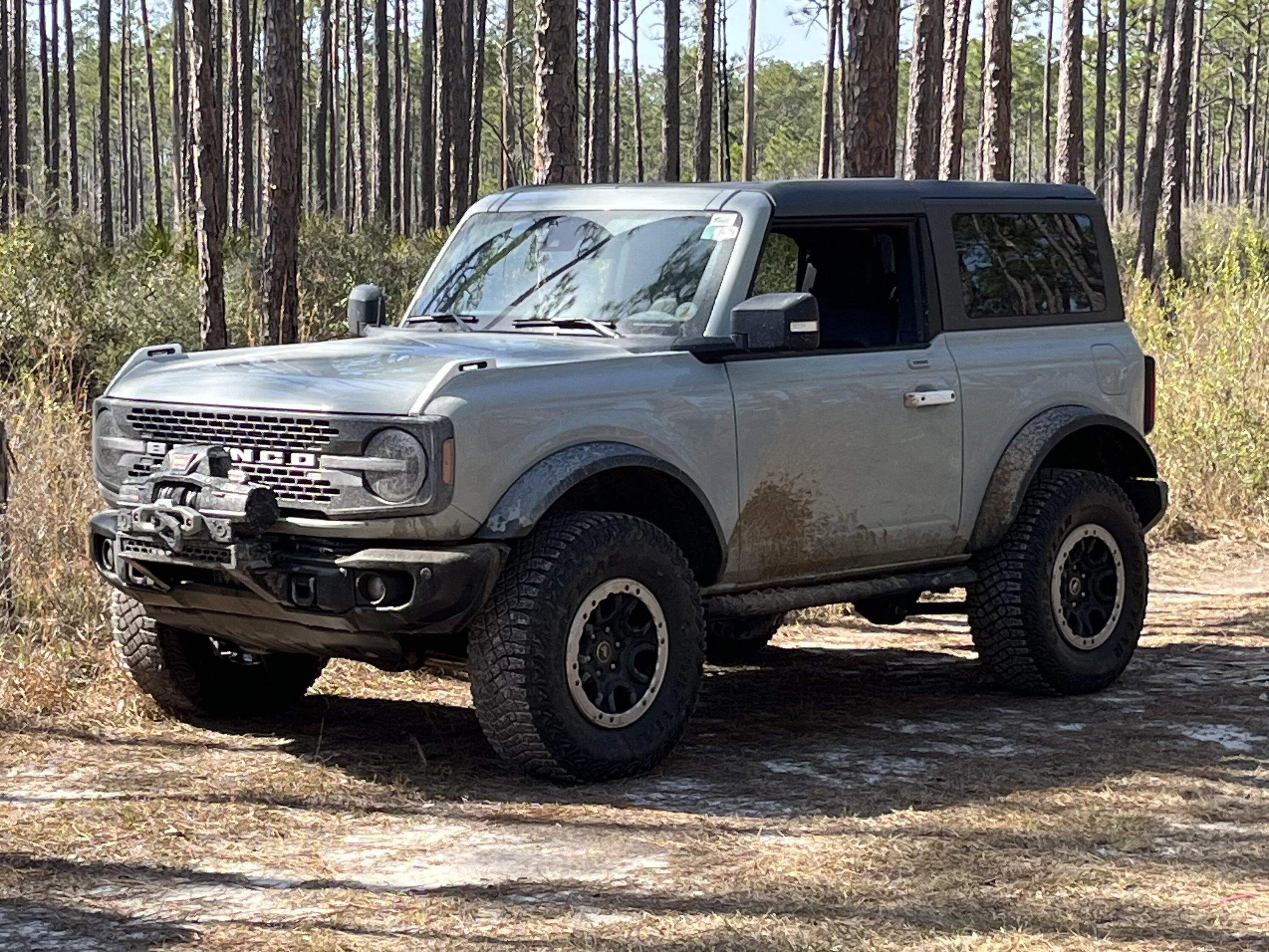

I got the Stage 1 and Icon tie rods installed 3 weeks ago along with SVC perch collars I got off Marketplace.
Yesterday wheeled Eglin AFB all day. And although it’s not hard wheeling the upgrade and the 2” lift worked great.
Ford Bronco 74weld stage 1 steering upgrade DIY install IMG_1639

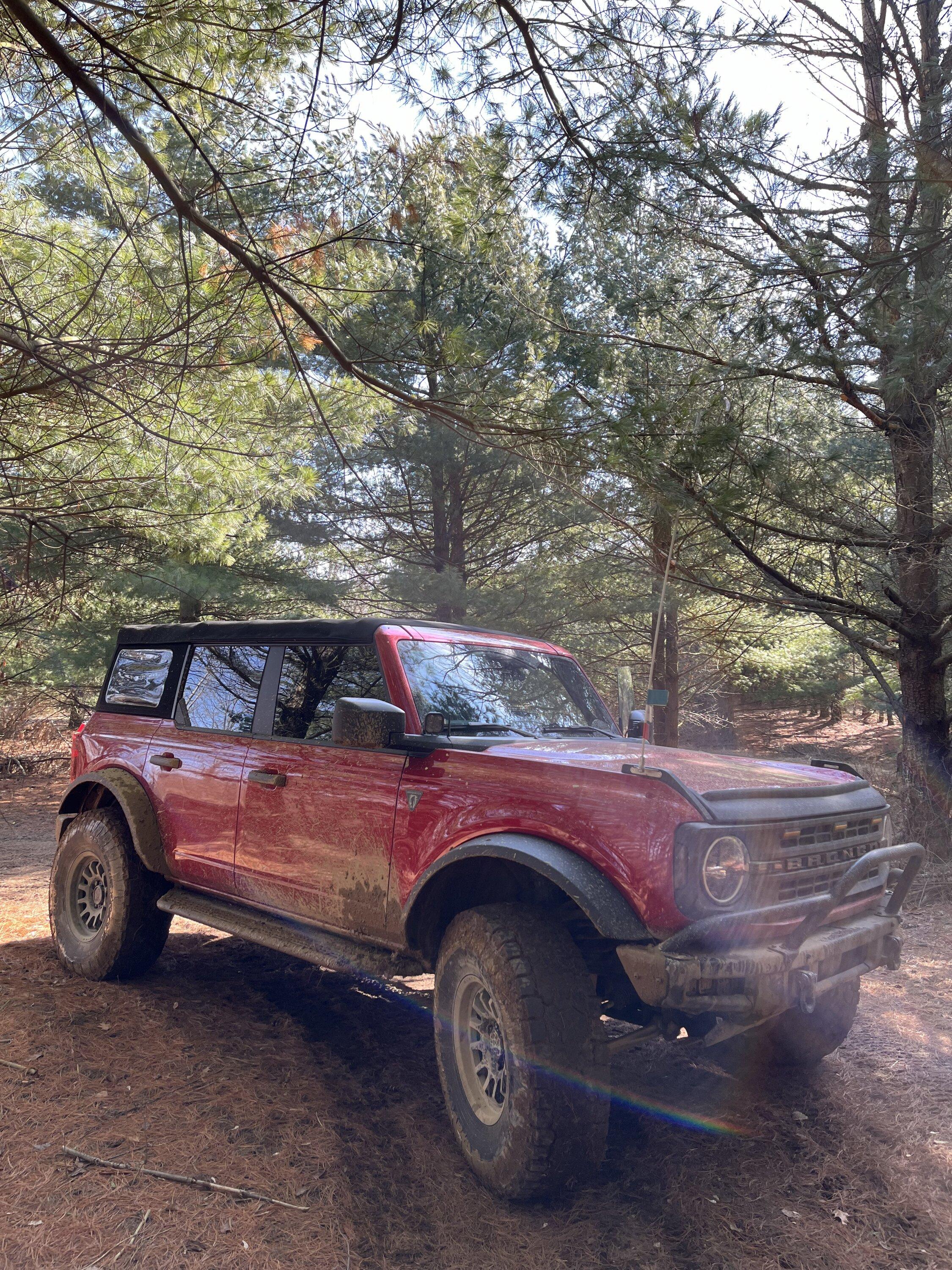

Ford Bronco 74weld stage 1 steering upgrade DIY install IMG_1200
Nice!!!! Me too. Did a shakedown all went well.
