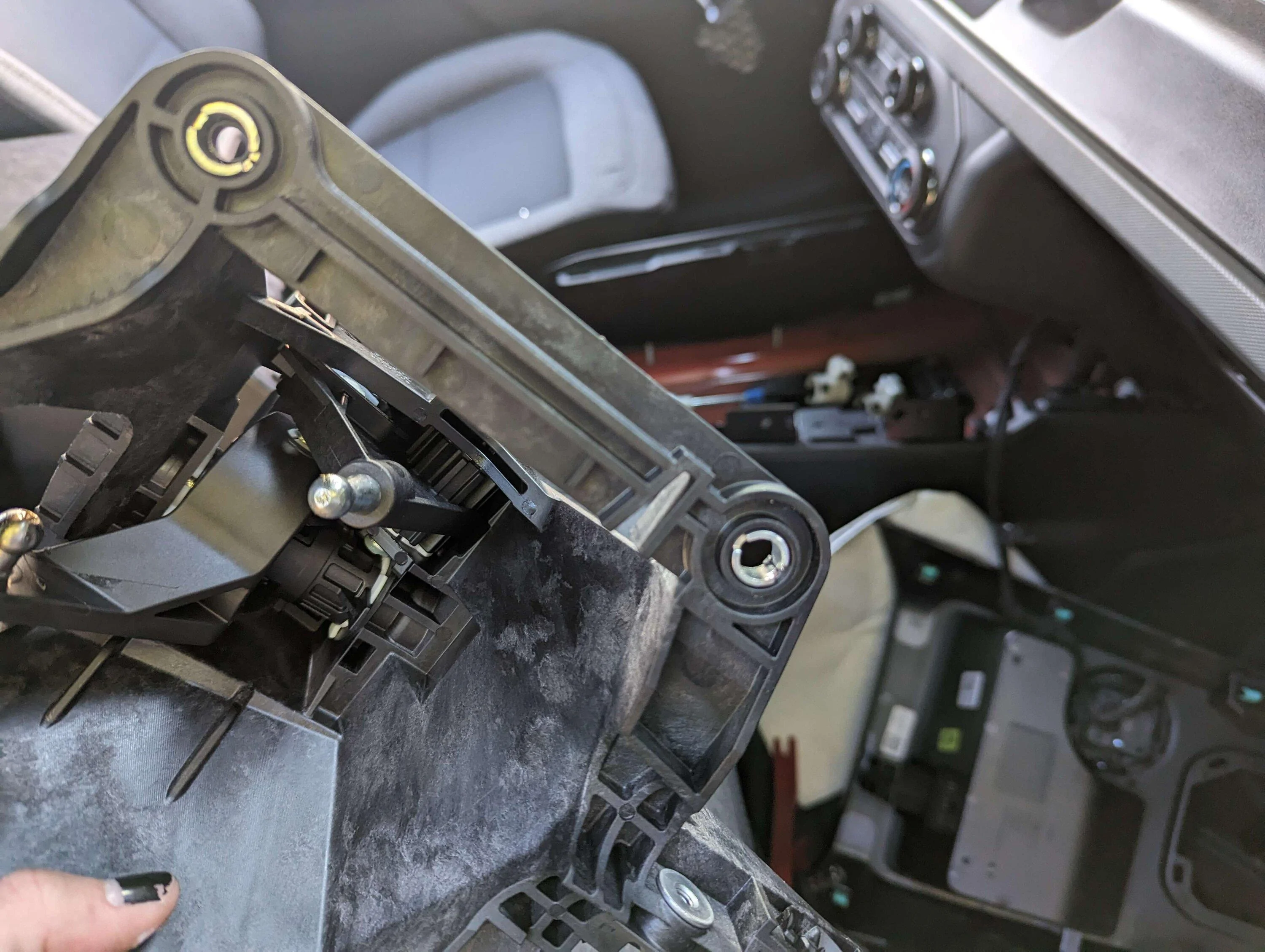

Ford Bronco Installed the B&M sport short shifter today PXL_20230603_044840643
You'll notice that on the plastic just under where the grab handle attaches, that there are some significant vertical scratches, this makes me sick to my stomach but overall it's not the end of the world. There are some ways to deal with interior scratches but this could've been easily avoided and it'll never be the same. Useful clarifying info would be: the edges of this center console panel are extremely sharp and the interior plastics are incredibly soft and pliable, almost spongy. If you look closely at the right side of that handle bracket, there are tiny "tooth mark" dents, that was from me just resting the panel into the floorboard as the instructions showed early on in the process. It would've made sense to just remove the wire loom holder and disconnect the 4wd selector switch but I was following it to a T not thinking this would damage anything. I've worked in a lot of cars and have rarely encountered a plastic interior so sensitive.
After noticing those marks I took measures to protect the center console, and wrapped the end of the panel in 4 layers of paper towel thinking that would be plenty, and I carried on with the job. It was only at the end in this moment when I discovered even my paper towel padding wasn't enough and it had been tearing into the plastic as I was fiddling with all the rest, the instructions have you bending out that plastic to remove the handle bracket. As you can see I put styrofoam from the shifter box in between after it was too late. Just not well thought out and I deeply regret not listening to my instincts, I wanted to unplug the 4x4 selector but thought whatever I'll play ball.

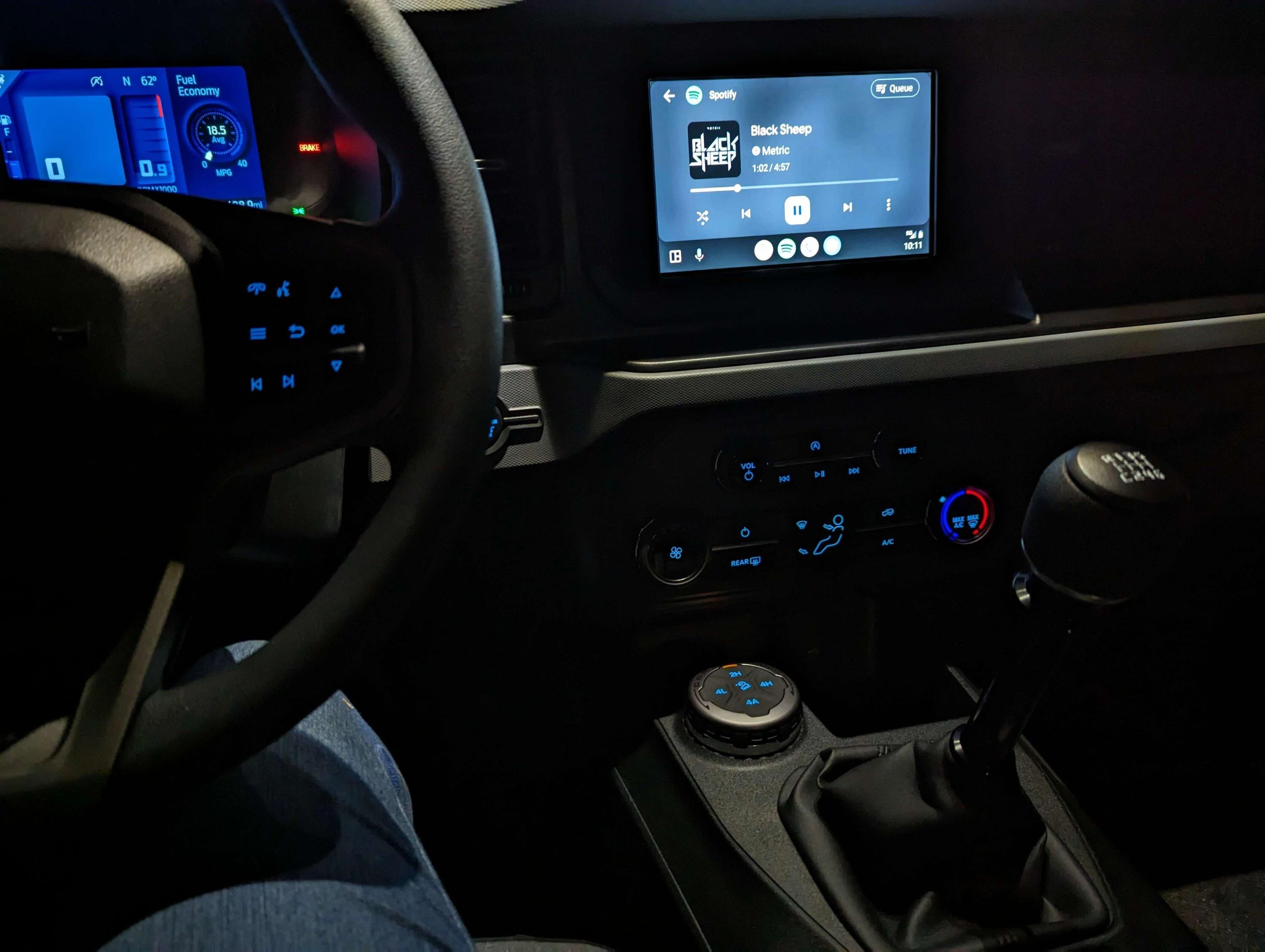

Ok with that over, I gotta repeat I love the mod, it's absolutely a drastic change over what is a mostly good shifter setup from the factory.
Ford Bronco Installed the B&M sport short shifter today PXL_20230603_054621128

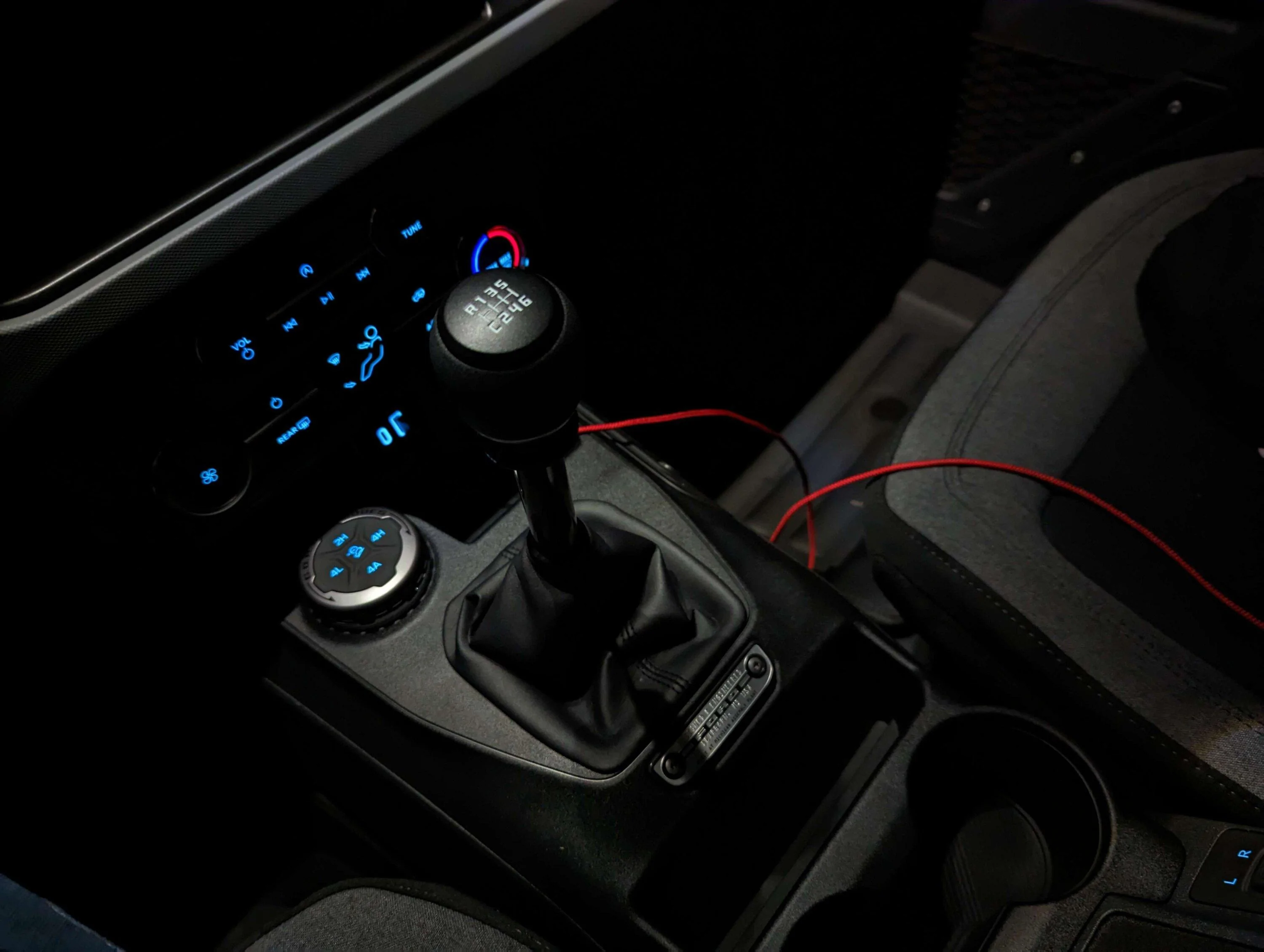

The ergonomics are vastly improved and the shift throws are a lot shorter. I thought the height might be awkward with hvac and radio controls but I didn't notice any troubles operating all that when driving. I love that it's closer to the steering wheel and I can rest my elbow on the center console and use my wrist and fingers to shift it. When it was oem I would on occasion keep my elbow to my side and reach around the center console, idk it made sense sometimes, I don't feel any need to do that and everything flows much better.
Ford really should consider a shifter similar to this either standard or as an option it's a lot better.

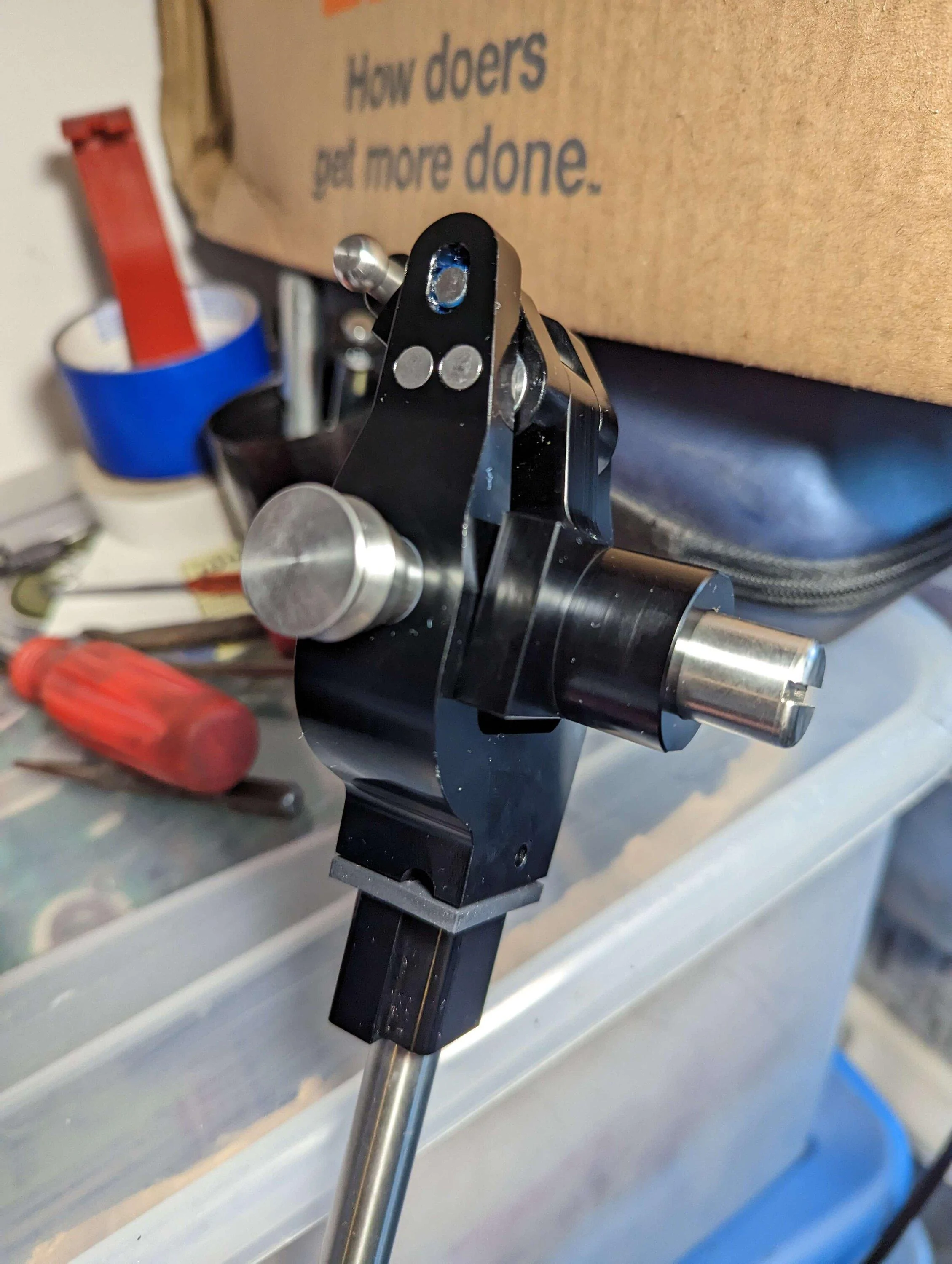

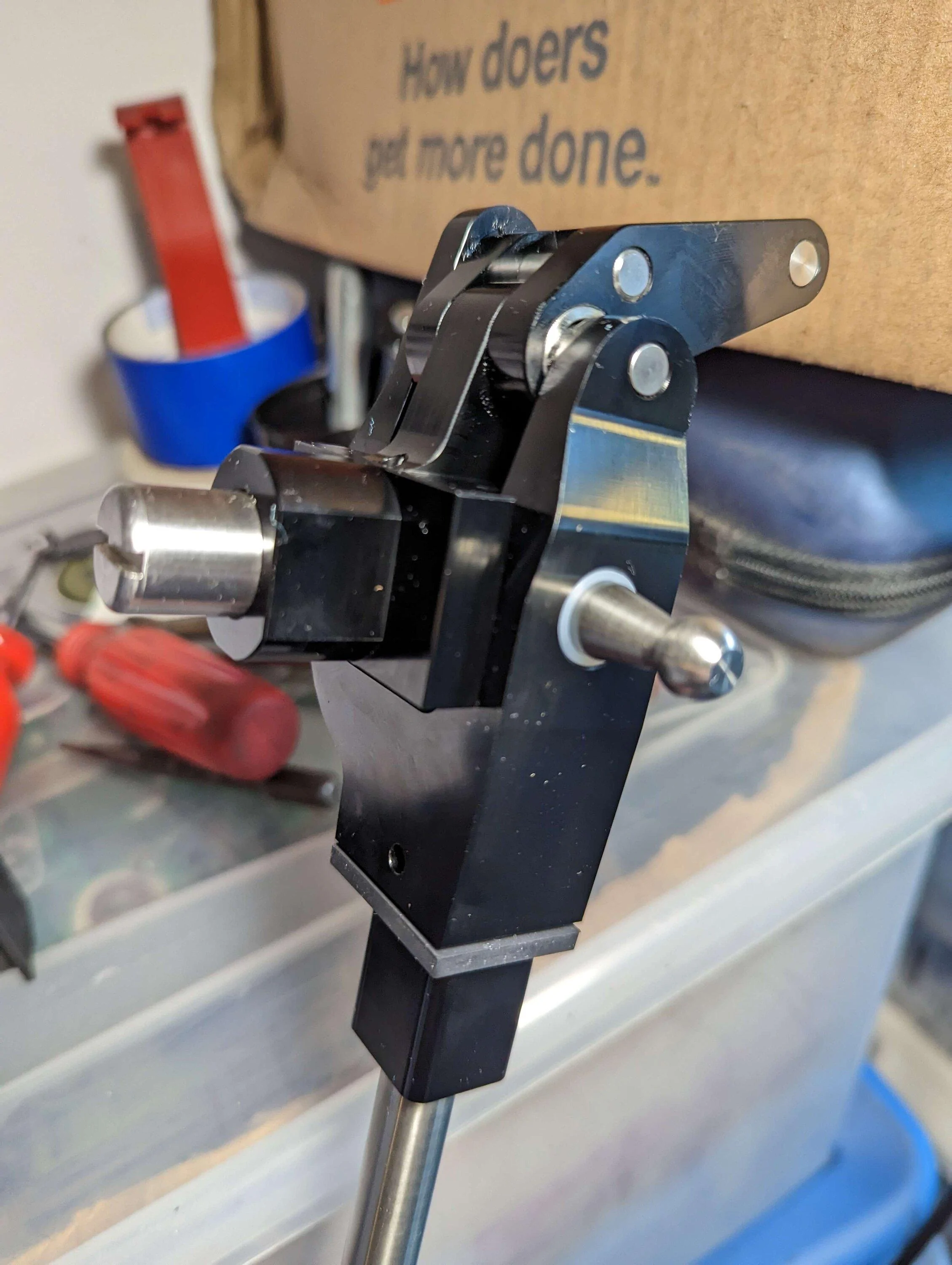

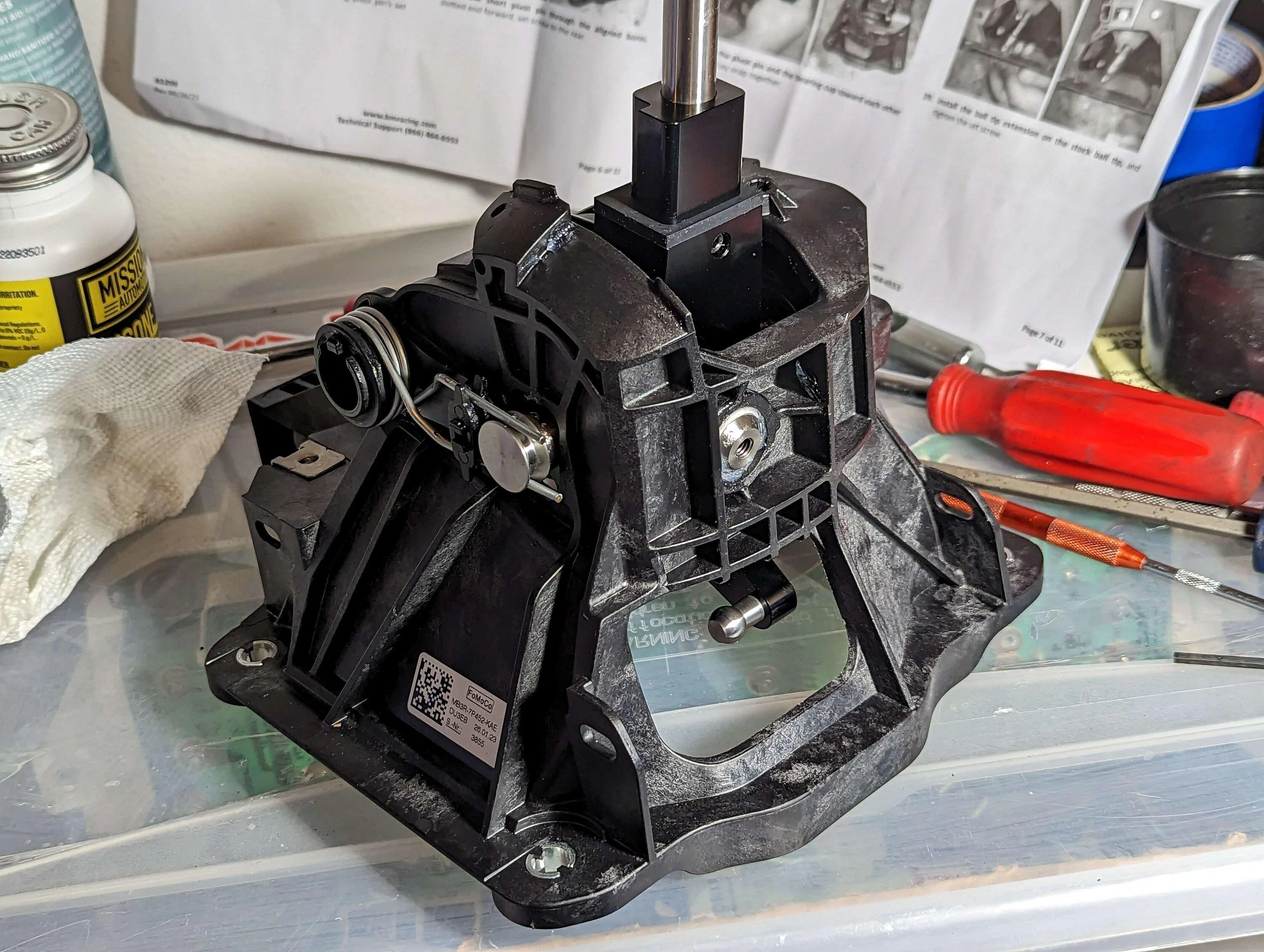

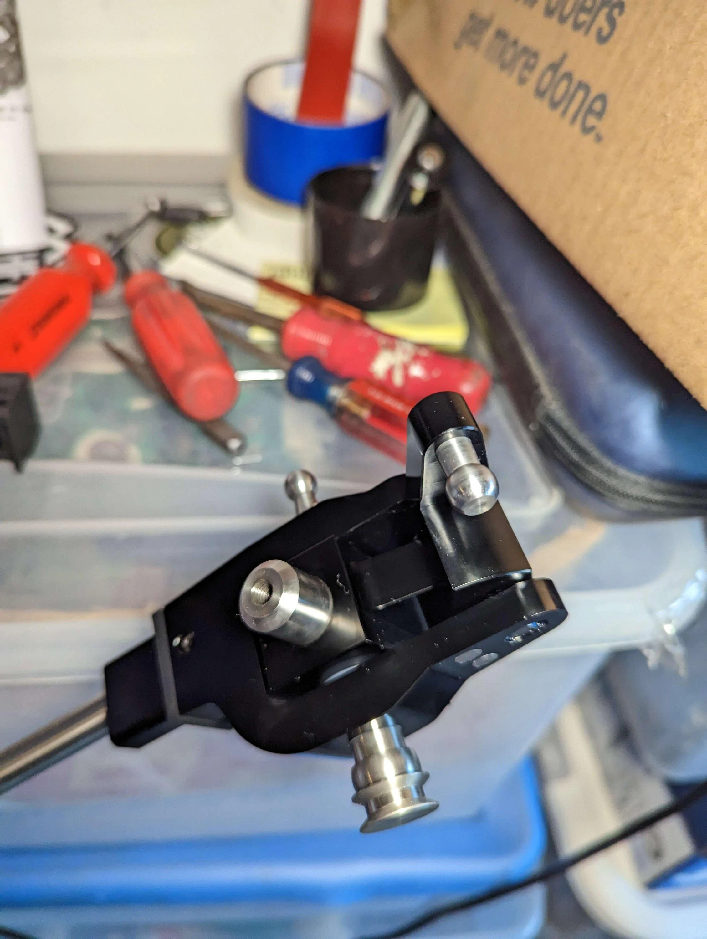

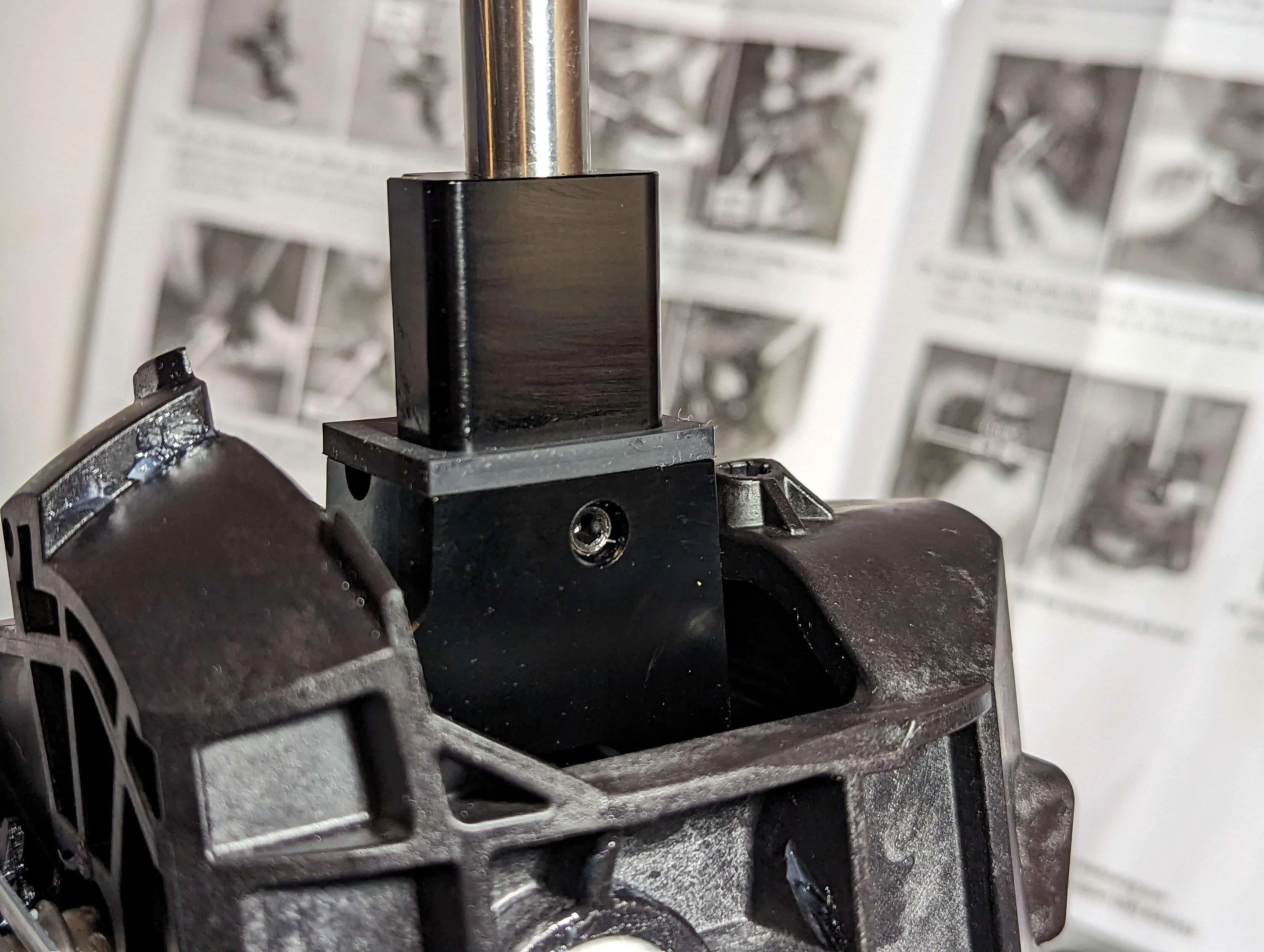

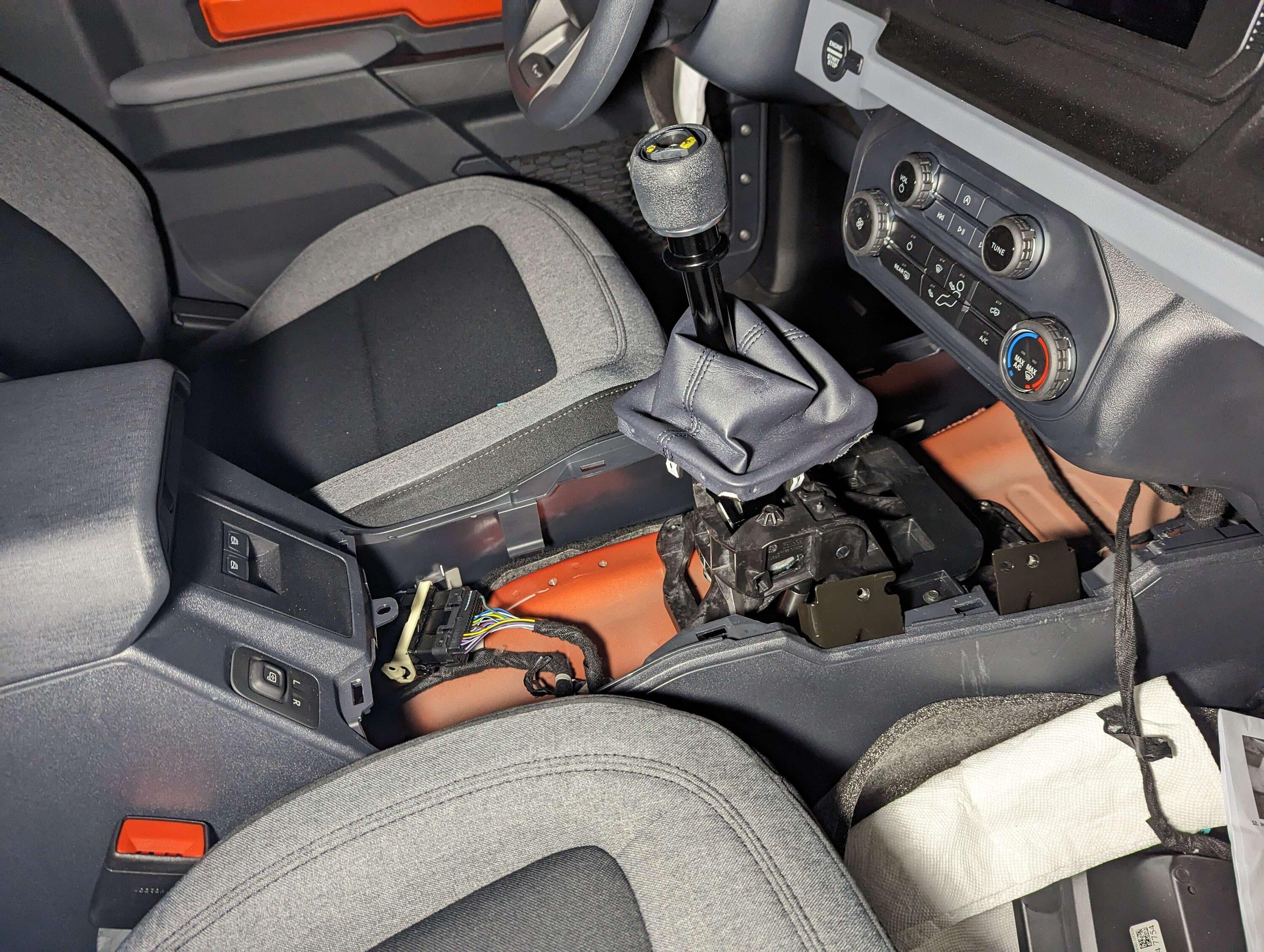

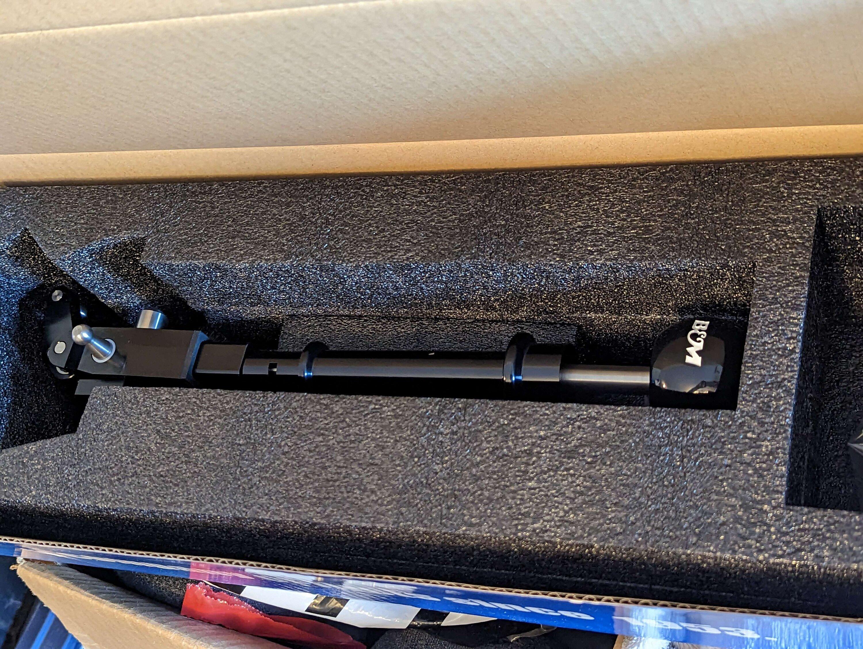

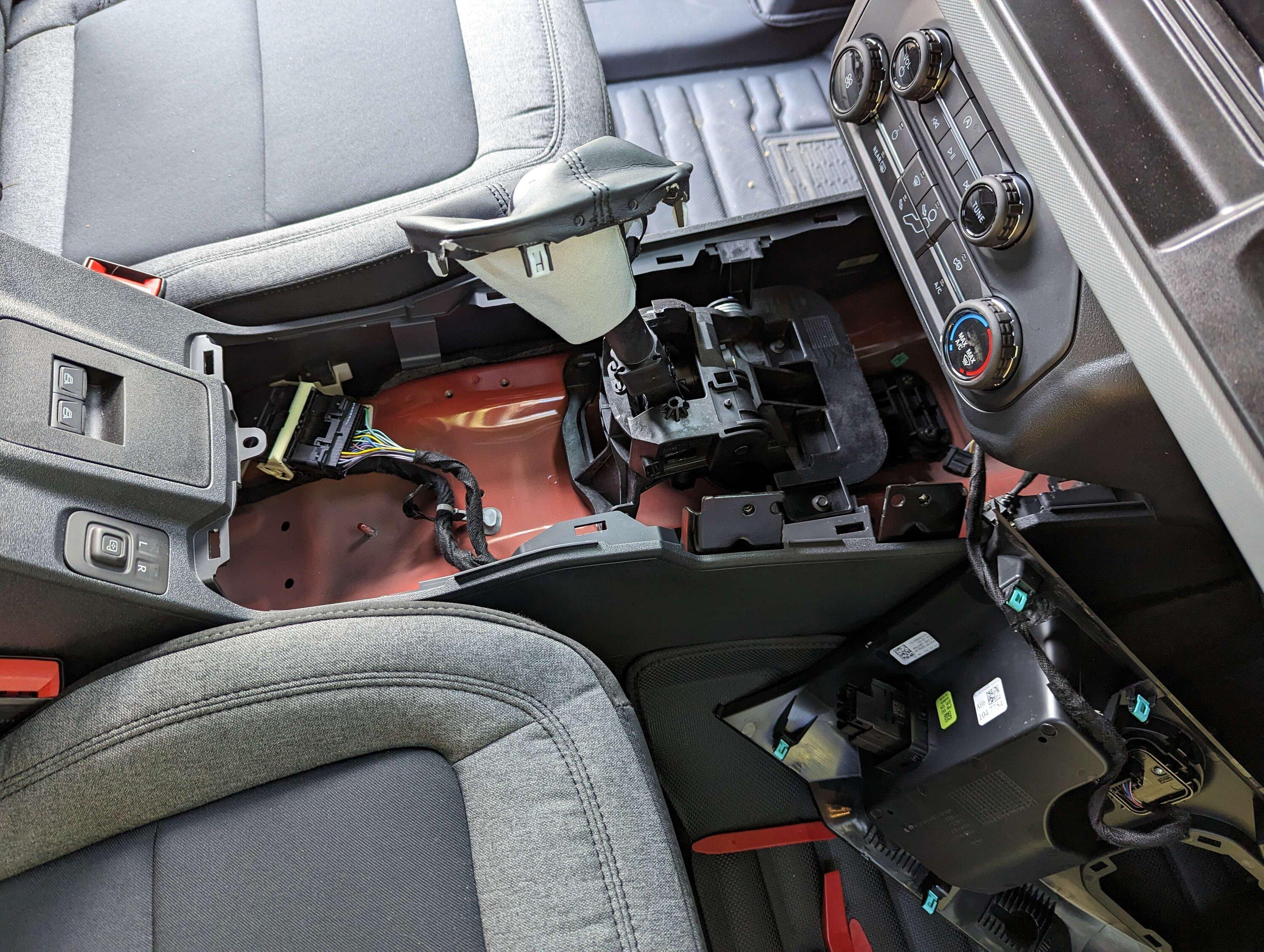

Anyway, here are some random pics, I find it so extra that B&M anodized the internals despite them being hidden but whatever, it's a really well made product!
Ford Bronco Installed the B&M sport short shifter today PXL_20230603_004441880
Ford Bronco Installed the B&M sport short shifter today PXL_20230603_012259377
Ford Bronco Installed the B&M sport short shifter today PXL_20230603_022112796
Ford Bronco Installed the B&M sport short shifter today PXL_20230603_030814429
Ford Bronco Installed the B&M sport short shifter today PXL_20230603_030817321.MP
Ford Bronco Installed the B&M sport short shifter today PXL_20230603_030824090
Ford Bronco Installed the B&M sport short shifter today PXL_20230603_034619877
Ford Bronco Installed the B&M sport short shifter today PXL_20230603_034625707
