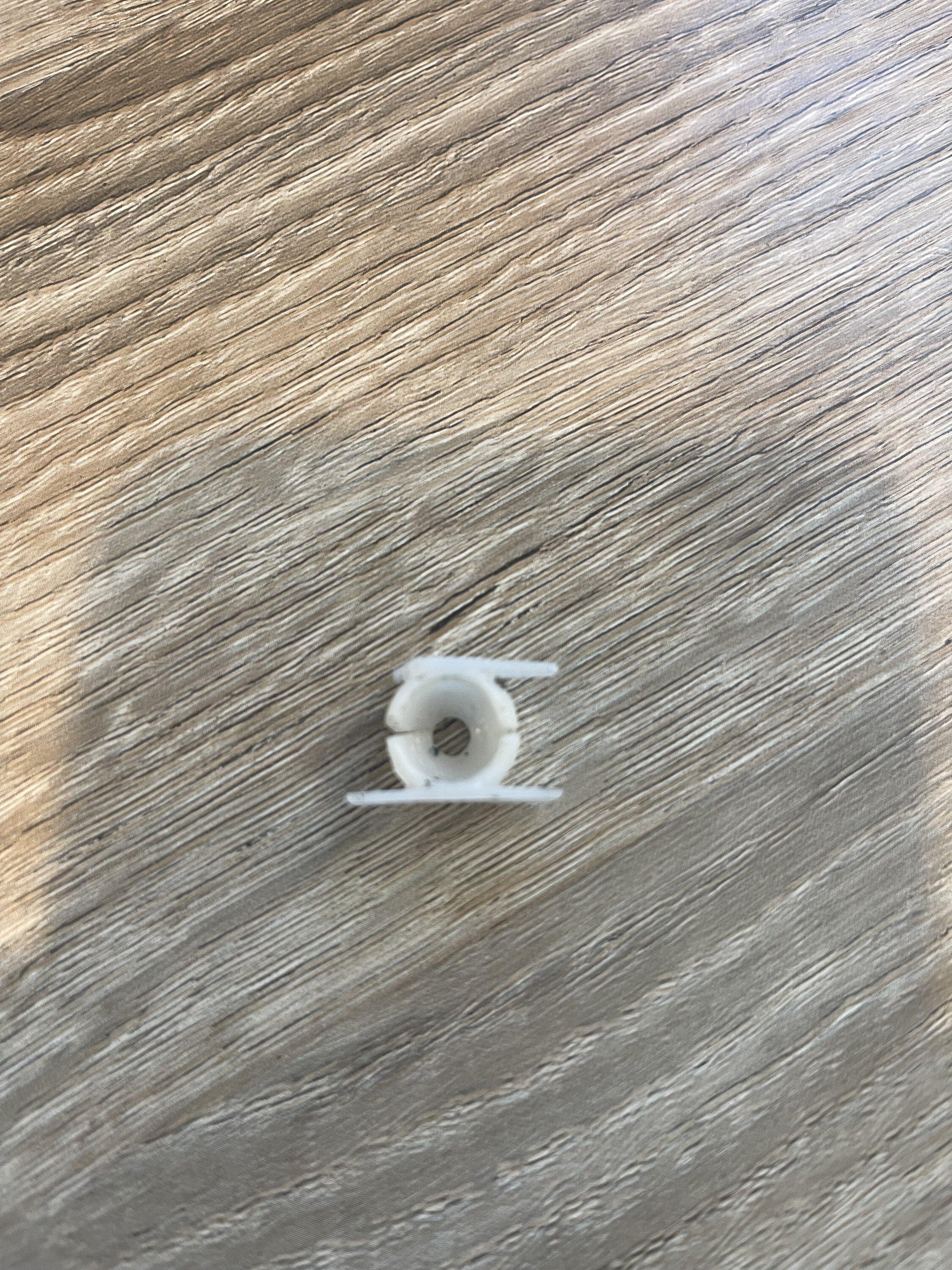

Group: Happy 2024. Installed the B&M short-throw shifter this weekend on my spouses 22' Bronco Badlands 7-sp. Mostly simple install for a DIY. Initial impressions, certainly helps creating quick, crisp, and precise shifts. Similar to the prior poster, however, shifting from 1-2 is immensely short and feels shorter/less fully 'engaged' than other gear changes. However, 2 problems I need the groups input re: 1. When I was removing the fragile plastic bearing cup - it was glued to the top and the bottom of the assembly and didn't come out fully in-tact. Still usable, but won't definitively 'snap' back into place. That said, I'm skeptical to re-insert as it's not a complete piece, and don't want it to cause other issues should it not be solidly in the housing. Does anyone know if there is a replacement part available for this, and if so, the part number? 2. I notice 6th gear does not engage while all other forward/reverse/crawl gear(s) successfully do sans issue. Is the plastic bearing cup the culprit here, or does it sound like it's a combination of readjusting the cables, and the addition of a new plastic bearing cup?
Thank you for the input and advice.
BW
It has been a while since I did this install, so I can't picture the plastic bearing cup to which you refer. However, I also had a couple of gears that didn't feel like they engaged properly. Adjusting the cables underneath the vehicle solved that issue. I did break the cable clips and had to resort to using cable ties to hold the remainder of the clip securely.

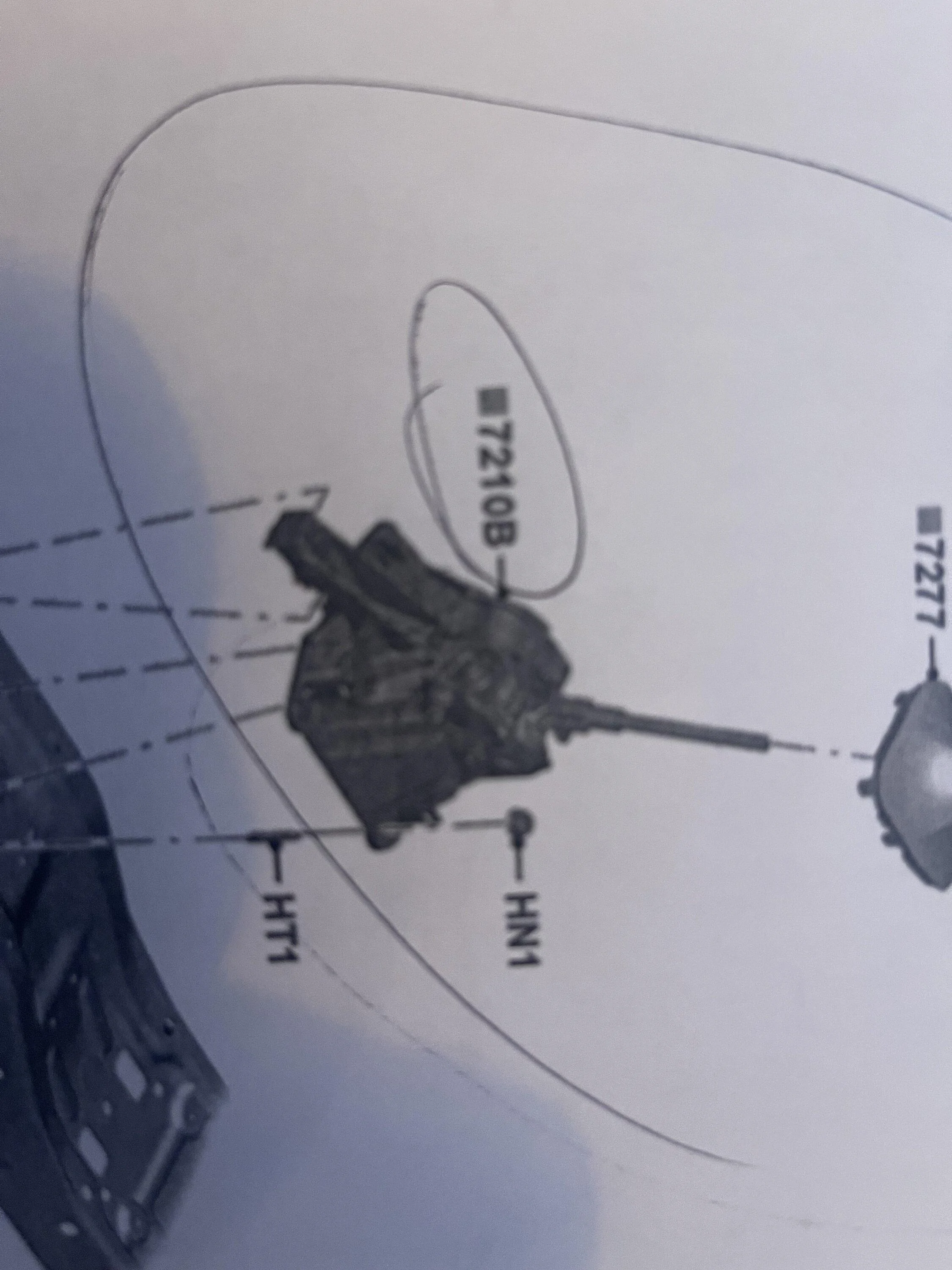

Here’s the part, pictured below. Wondering if the lack-thereof is why the transmission won’t go into 6th? Ford advised this part is only available as part of the entire assembly, circled below. Only $175, but still. Frustrating nonetheless. Any other thoughts? Last, how did you go about adjusting the shift lines underneath the vehicle? I’ve yet to get up under to take a look
Ford Bronco Installed the B&M sport short shifter today IMG_5798
Oh, now I remember that thing. I doesn't seem like the broken tab would prevent you from engaging 6th gear, but I suppose it's possible.
I would try adjusting the cables and see how that goes. It's a fairly simple procedure...just don't break the orange clips!
