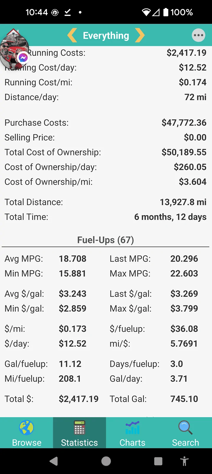

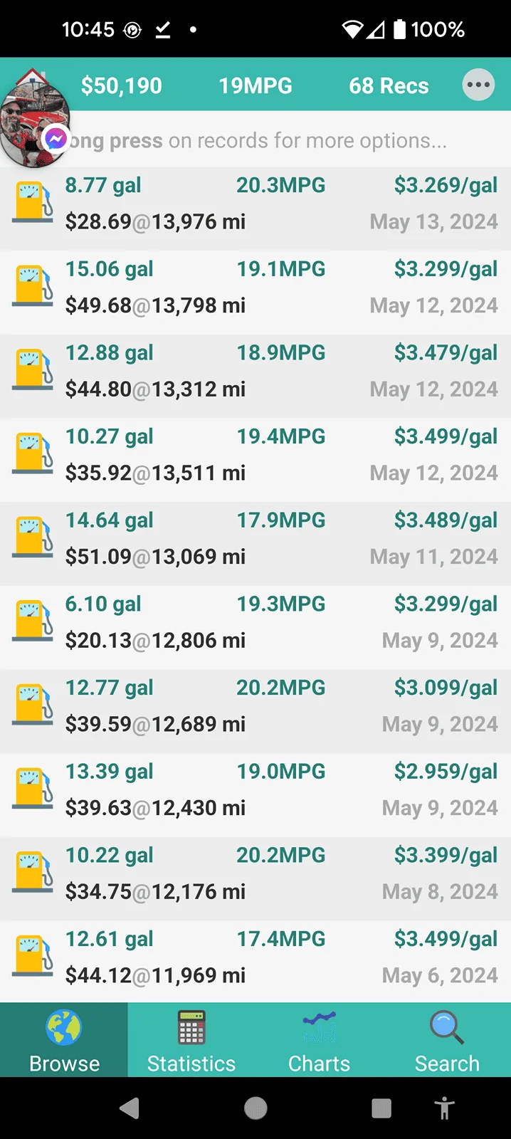

Just got back from a drive from Alabama to Texas and back.
23 2 door Heritage Edition.
Around 650 lbs of passengers and cargo.
Cruise set at 70 in 5th gear returned 19.0 mpg.
Cruise set at 70 in 6th gear returned 20.2 mpg.
Cruise set at 75 in 6th gear returned 19.3 mpg.
As recorded on my aCar app by Fully, not the built in lie-o-meter.

I'm not familiar with that app.
Nice display, but doesn't tell me anything. For example, is it an iPhone app? An Android app? Do you need a laptop? How does it connect? Bluetooth? ODBII? Does it need a special cable? That looks like a real-time display, how does it get its data?
As I said, I'm not familiar with it, as in totally ignorant.
Never mind and my appologies. I was hoping it could get real time data. It's just another phone app that replaces an old fashioned log book. Admittedly they're more convenient.
Yea, just an electronic record of fuel and maintenance.
