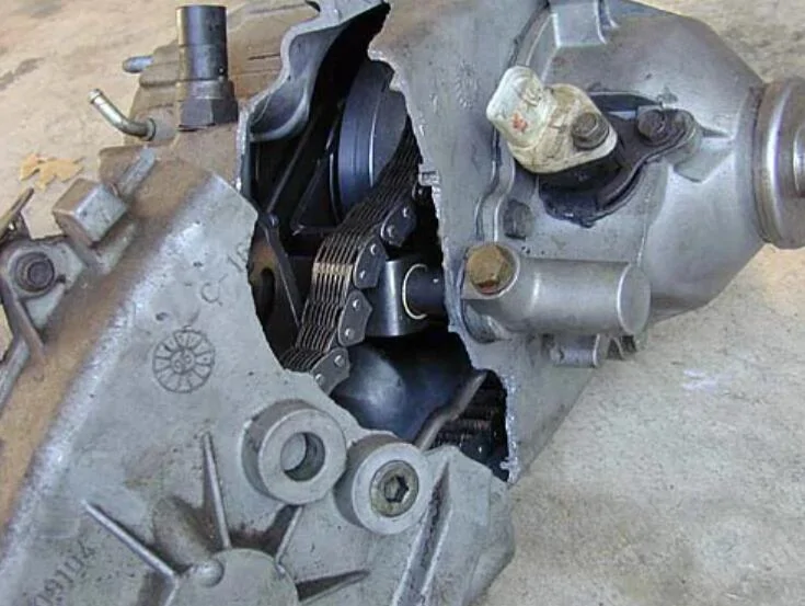

I have Auto, but I wouldn't worry about having 4HI only. Good tires (especially winter only tires with softer compound and more siping), OEM traction controls with wheelspeed and other sensors, and common sense will keep you out of trouble on the road. You as the driver will need to be aware of tire slip availability.
Dry pavement used to grenade transfer cases, and occasionally still can, as the grippy offroad tires cannot slip on dry hot pavement enough to prevent binding:
Ford Bronco 4A necessary for Iowa? 1721844948369-wo
Hence the recommendation to use it only in snowy or icy conditions, where wheel slip is a normal occurrence. I don't know where using 4x4 in the rain came from, apparently some place with trash road construction and maintenance or straight up monsoons, because good tires and reasonable speed will nearly always prevent any need for 4HI in the rain.
Alaskans have run a plethora of modern, old and clapped out rigs in 4HI all winter forever, so if there were going to be a concentration of exploded or damaged transfer cases from 4HI continuously on on snow and icy pavement or at speeds (often much) higher than 55 on that same snow and icy pavement being dangerous, we would have seen it long ago.
Use the BCM between your ears, you'll be fine, and so will the Bronco.
