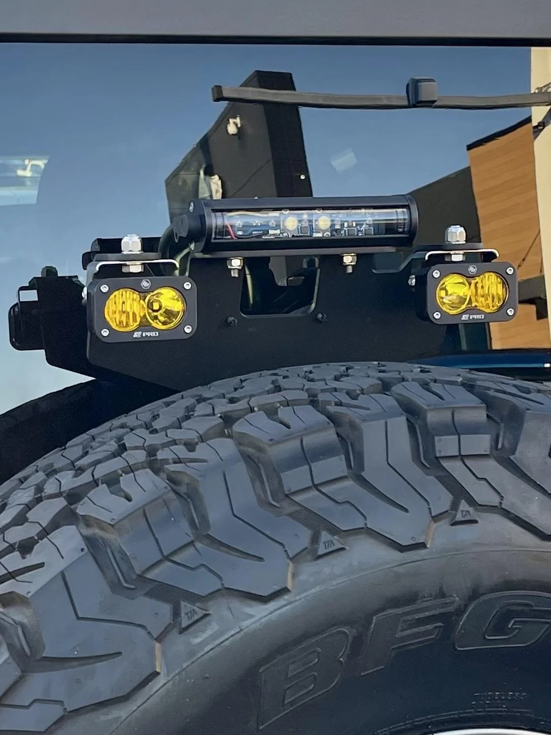

The light is this Morimoto 5-stop: https://www.morimotohid.com/morimoto-5-stop-brake-light
I needed to cut the OEM third brake light wire connector because there’s not aftermarket connectors to mate with it. I used the deutsch connectors for my wire extension up. Example: https://a.co/d/1bk3gTn
Draw back here is those connectors are much larger than necessary, and I used two for a removable section - hard to hide them that big.
not sure what your plan is for mounting, but mine was on the Trailrax channels, which are compatible with the 25-series channel accessories from 80/20. I used the 90-degree brackets (25-4132) here’s a link: https://a.co/d/85Kpvrv
I used some M5 bolts to fasten light to bracket.
I hid the wires in the crossbar channel using the T-slot dust cover, like:
https://www.zoro.com/8020-black-economy-t-slot-cover-25-s-25-2820/i/G0823510/

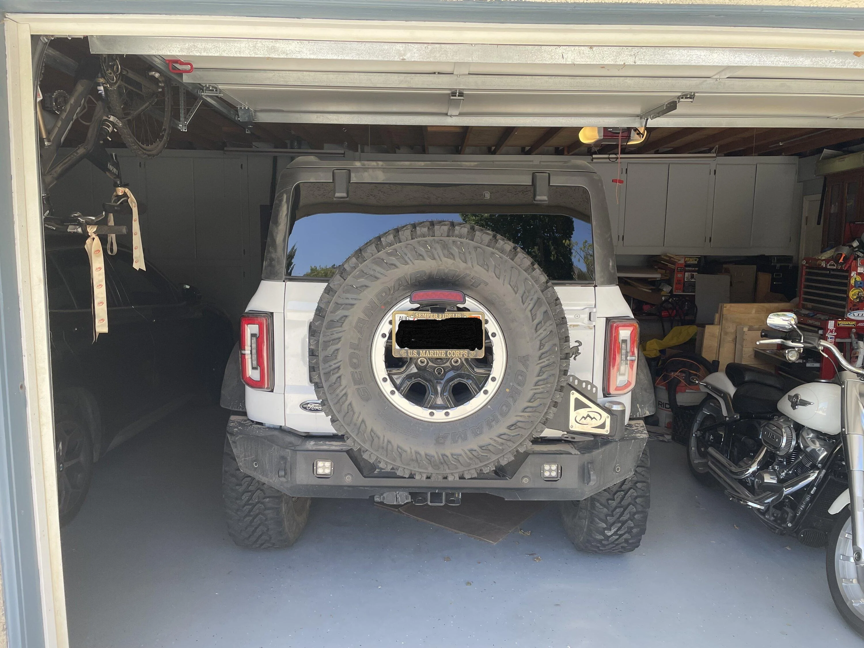

there’s enough adjustability in the AAL STP to permit the OEM third brake light mounted on an extension with the AAL STP probably, but you really wouldn’t be able to see it from the drivers seat in the vehicle behind - too low and close to the STP that the angle makes it obstructed. Mounting on the STP rearmost edge, itself, or up high is a solution for that visibility.
or just rip the stock one off without a replacement and blast Judas Priest down the road like I did for awhile

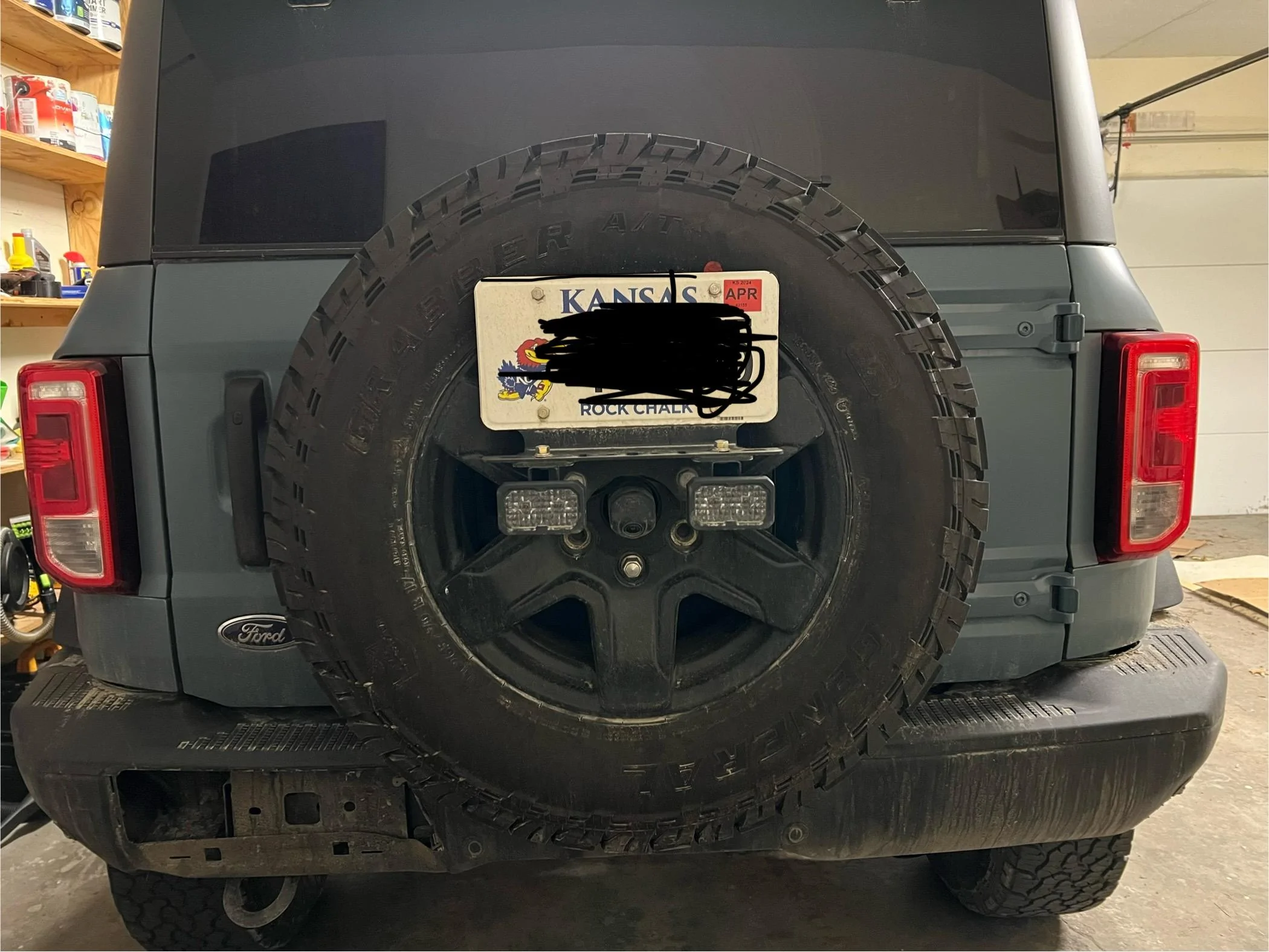

I am running the Diode Dynamics SS Reverse Light Kit (https://www.4x4truckleds.com/diode-dynamics-stage-series-reverse-light-kit-for-2021-ford-bronco/) w/ SSC2 Sports & Baja Designs Universal Lighting License Plate Mount (https://www.4x4truckleds.com/baja-designs-universal-lighting-license-plate-mount-us-plate/)

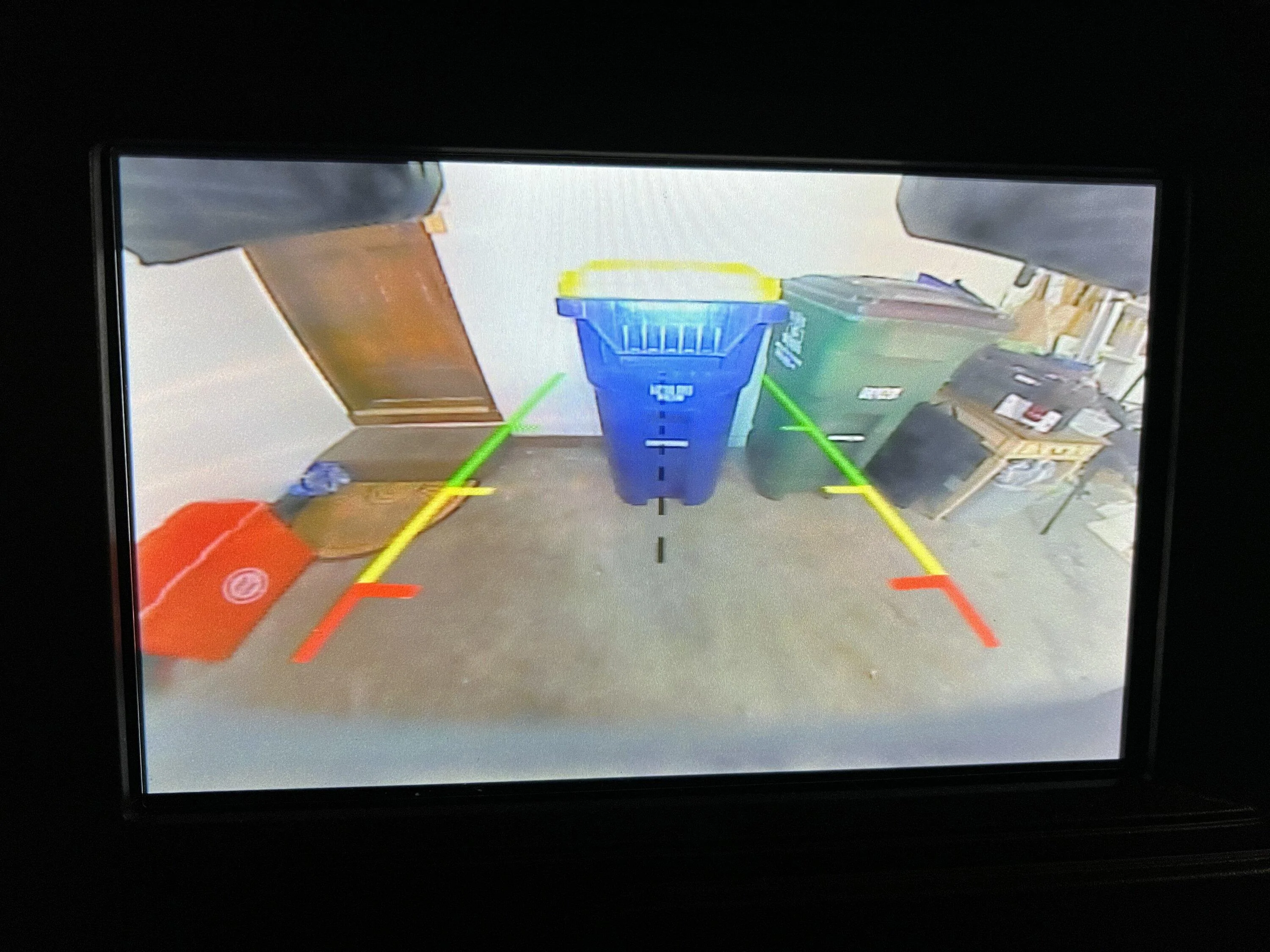

I have the lights on the bottom, on both sides of the reverse camera (barely any of the camera view is blocked) and the license plate mount on top
my only complaint is the Baja Designs license plate mount is way beefier than it needs to be, but not 5 pounds or anything like that
if I were to do it again, I’d get SSC2 Pros instead
