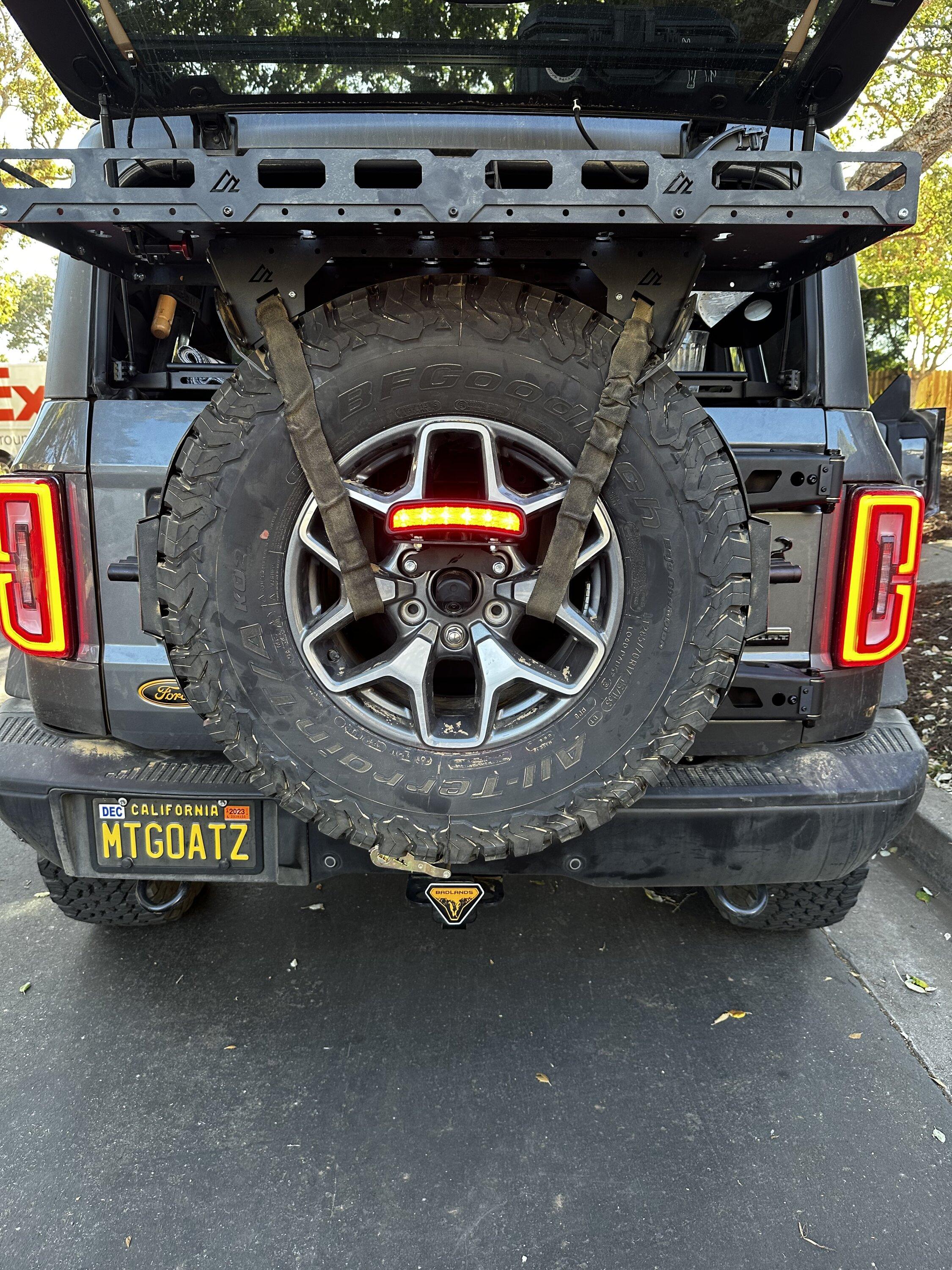

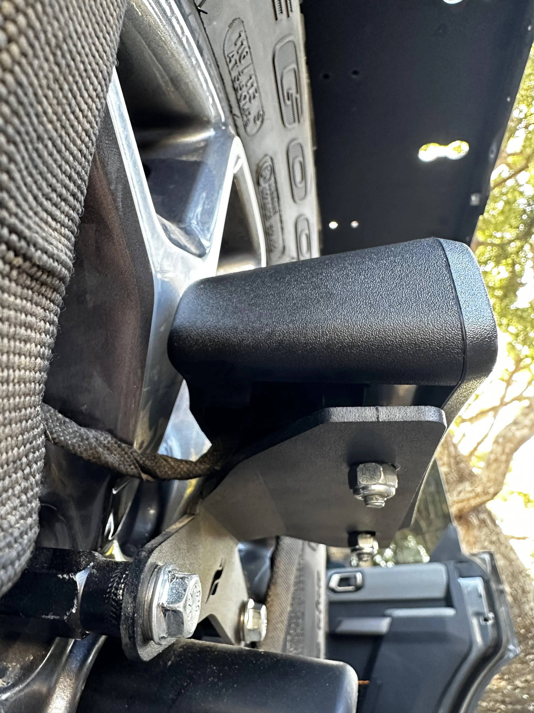

Had to relocate my 3rd brake light after installing the American Adventure Labs spare tire mount. Researched all the possible 3rd brake light relocations and didn’t find one I loved. So I started searching for chase lights to potentially re-mount the OEM brake light and found Fast Intentions’ chase light bracket.

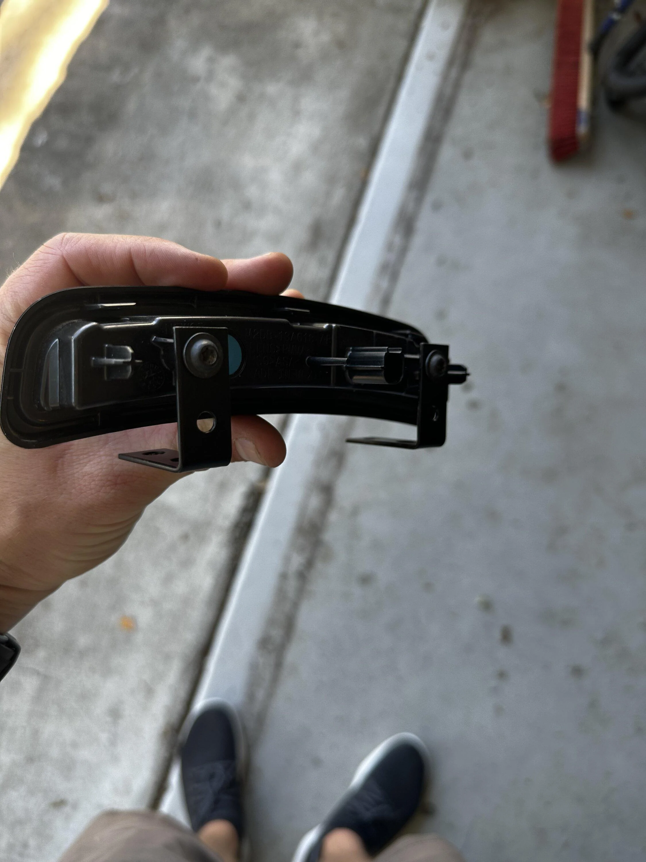

Cut some L Brackets from Home Depot, and mounted the OEM brake light. Then cut the OEM brake light housing to cover it up and make it look clean! Love how it turned out.

Nice job! Came out clean.

WOW! So glad I did a search before asking my question! I'm about to get the same basket and was looking at a different brake light mount/extension. What you did is perfect. Hope you don't mind me copying your idea! Thanks for sharing.
