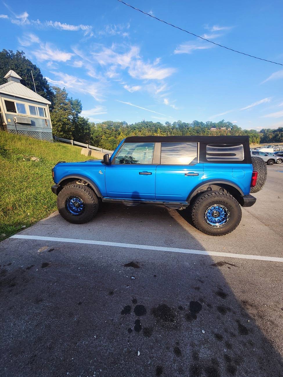

Ford Bronco 37” Tire Regrets? 1000000873

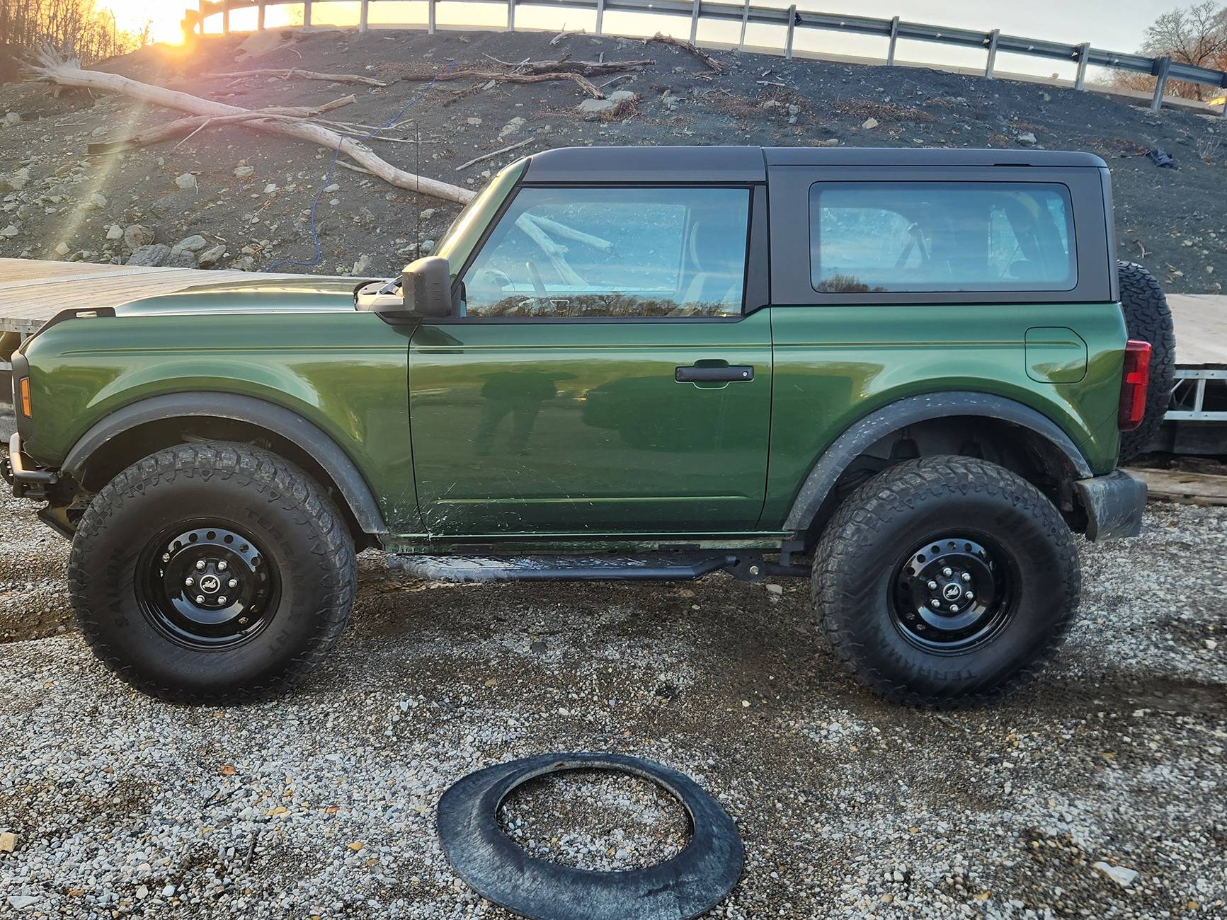

my base on 37s on steely and a 1.5 wheel tires are terramax rt d rate 59 pound the run skinny tread 9 in wide
Ford Bronco 37” Tire Regrets? 1000000804
same tire on a 8.5 wheel its a - 12 no rubbing on both broncos ifyou look aroind you can find the terramax rt for under 300 dollars a peice make sure you get the d rate not the e rate they are 67 pounds
Ford Bronco 37” Tire Regrets? 1000000790

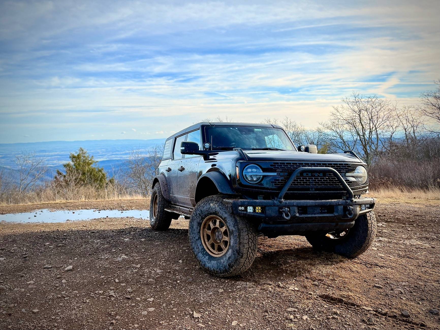

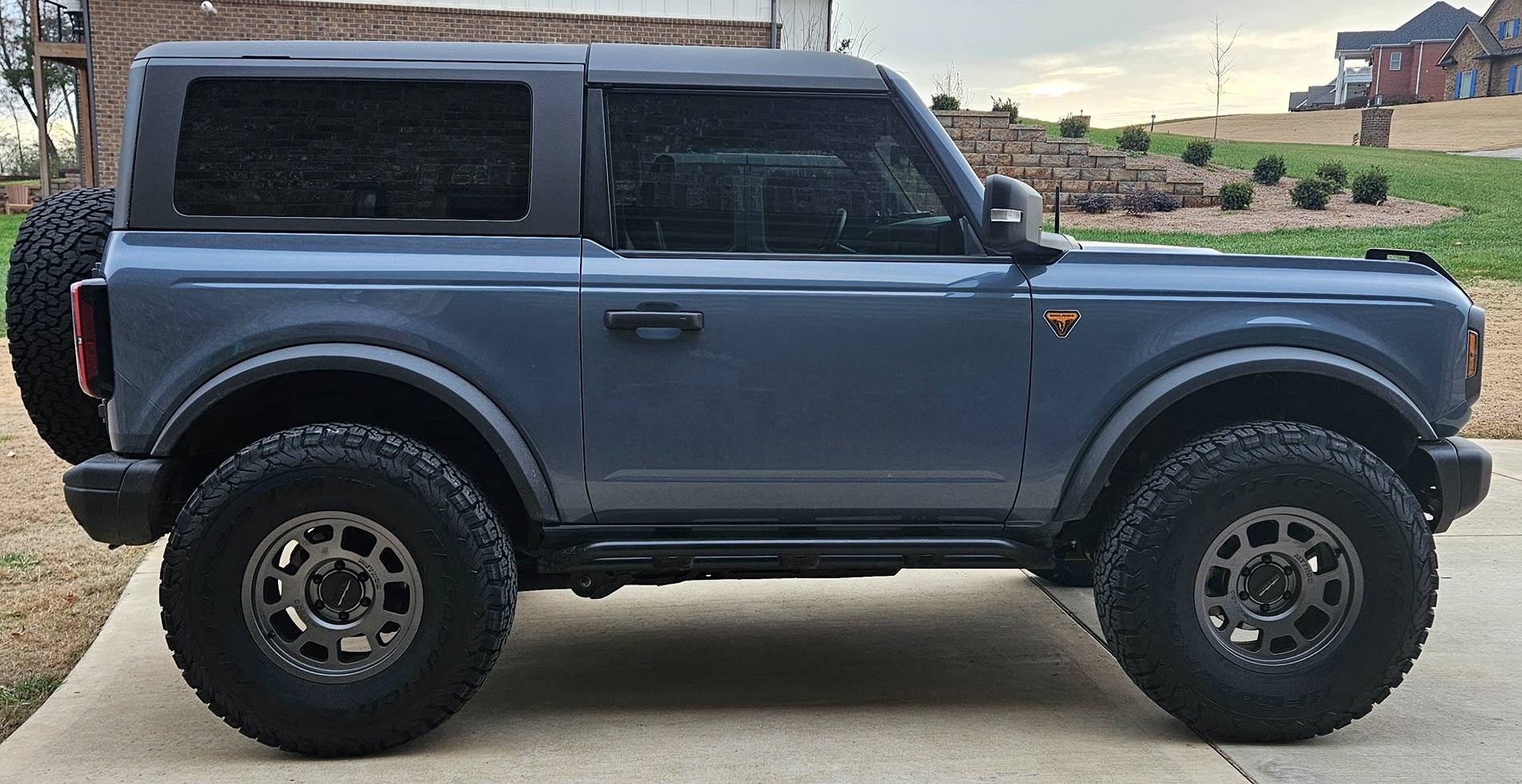

I wouldn’t call them regrets, but it took so much more effort than I anticipated. I started with new wheels (0 offset), and Stage 6 ICON suspension. Thought I would be okay. But I was rubbing pretty hard. So I had to (in order):
The first three were before leaving the shop that installed suspension/wheels:
- Modify the OEM running boards, cutting back about 2” on the front, then a lot more finagling to get the cap back on
- Cut off the crash bar behind the front tires
- Remove mudflaps
Then it was still rubbing in many on-road scenarios that lead to:
- JKS Max Tire Clearance kit was the big unexpected one
- 1” Body lift to prevent stuffing the front tires
Soon enough I removed the OEM steps and replaced with IAG rock rails…and even those rubbed, so back to the grinder to trim those back.
After all that, it still rubs a bit in the back at full articulation on the trails. That one I can live with for now.
On top of that, my gas mileage went from about 15.5 to 13.5. I haven’t recalibrated the speedo so maybe that would increase slightly but wouldn’t top 14.
Sure looks good and works great on the trails.

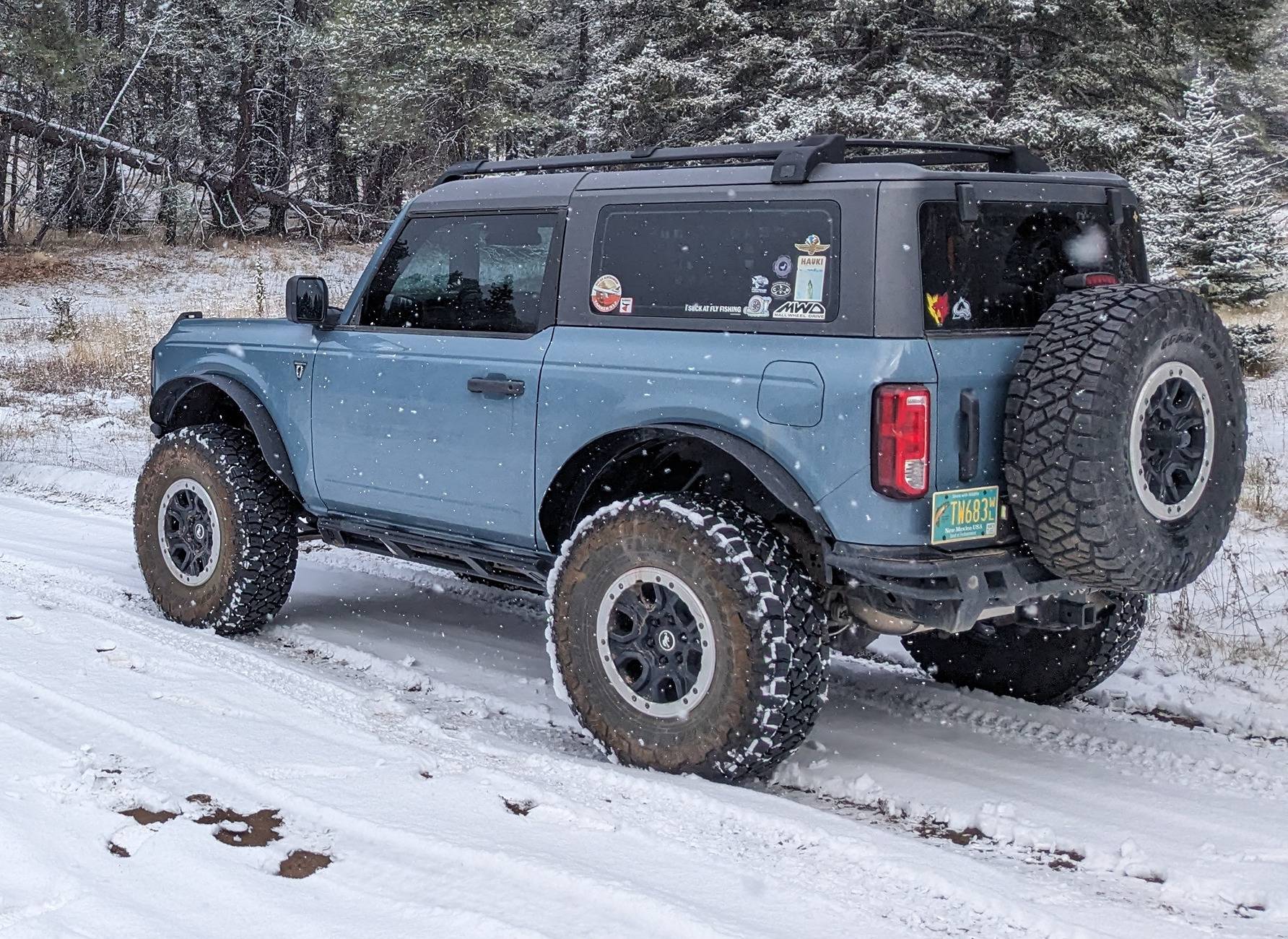

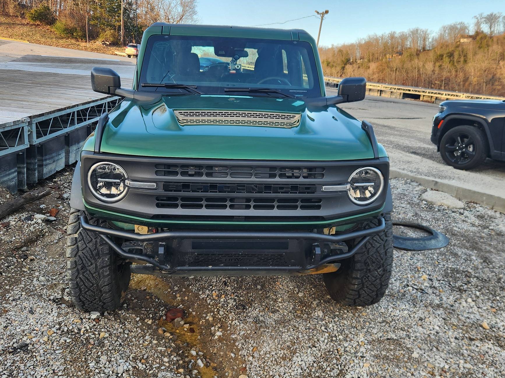

Nope I love mine. Added a Pulsar XT piggyback tune for more power to turn heavy tires and also correct the speedometer. I lost about 1-1.5 mpg with 37s, but I can live with that.

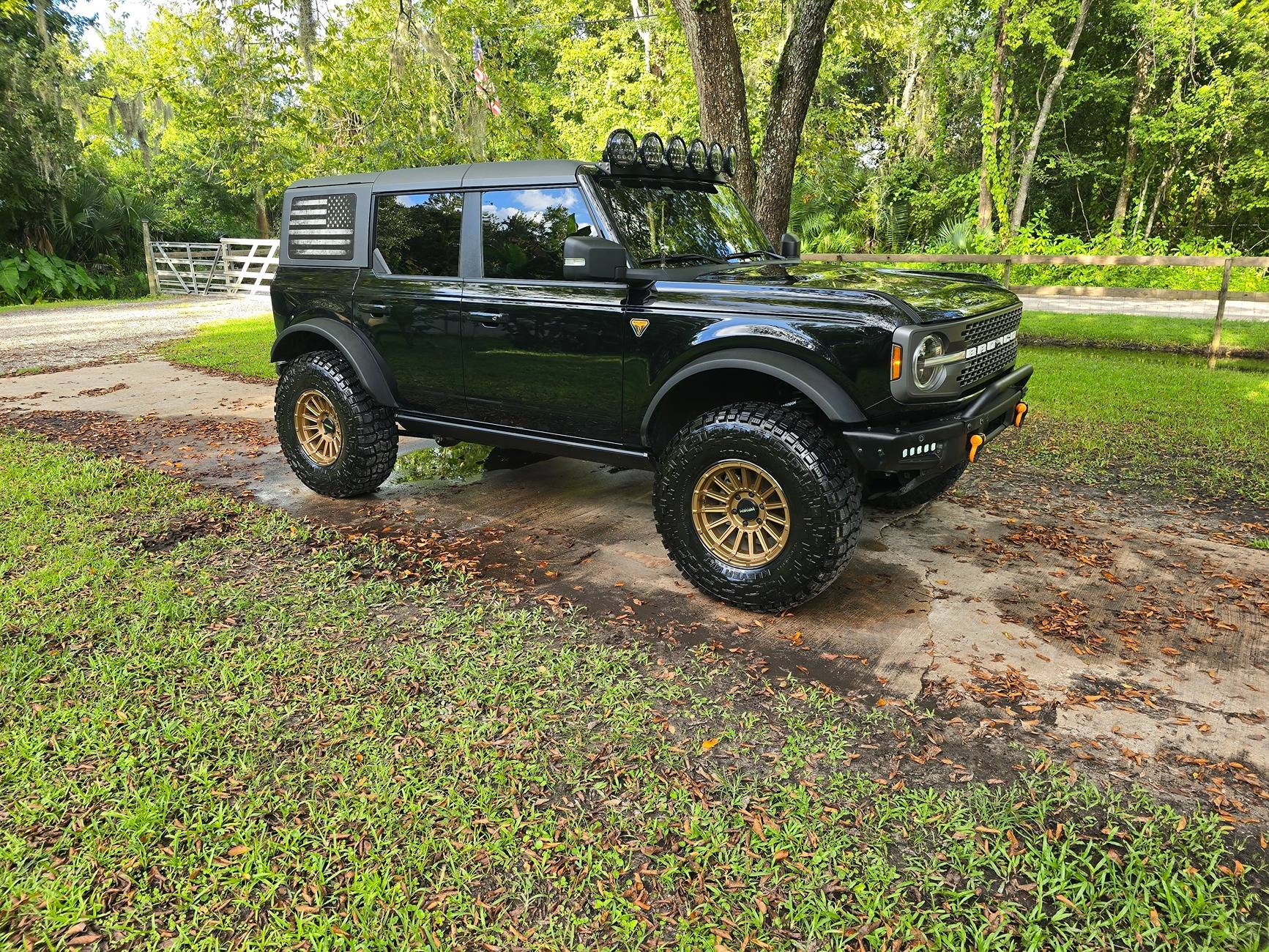

I knew what I was in for so no regrets but be aware gas mileage, handling and power will suffer plus rubbing will be a issue (depends on how much you can put up with) so more mods may/will be issue. Then of course there is the steering rack issue. For me Sasquatch coilovers with 3” zone lift became “overwhelmed” so I went with 4wp/procomp coilovers. Rubbing lead to JKS kit, and future 3/4” body lift. Hoss 3 steering rack was a no brainer…good luck
