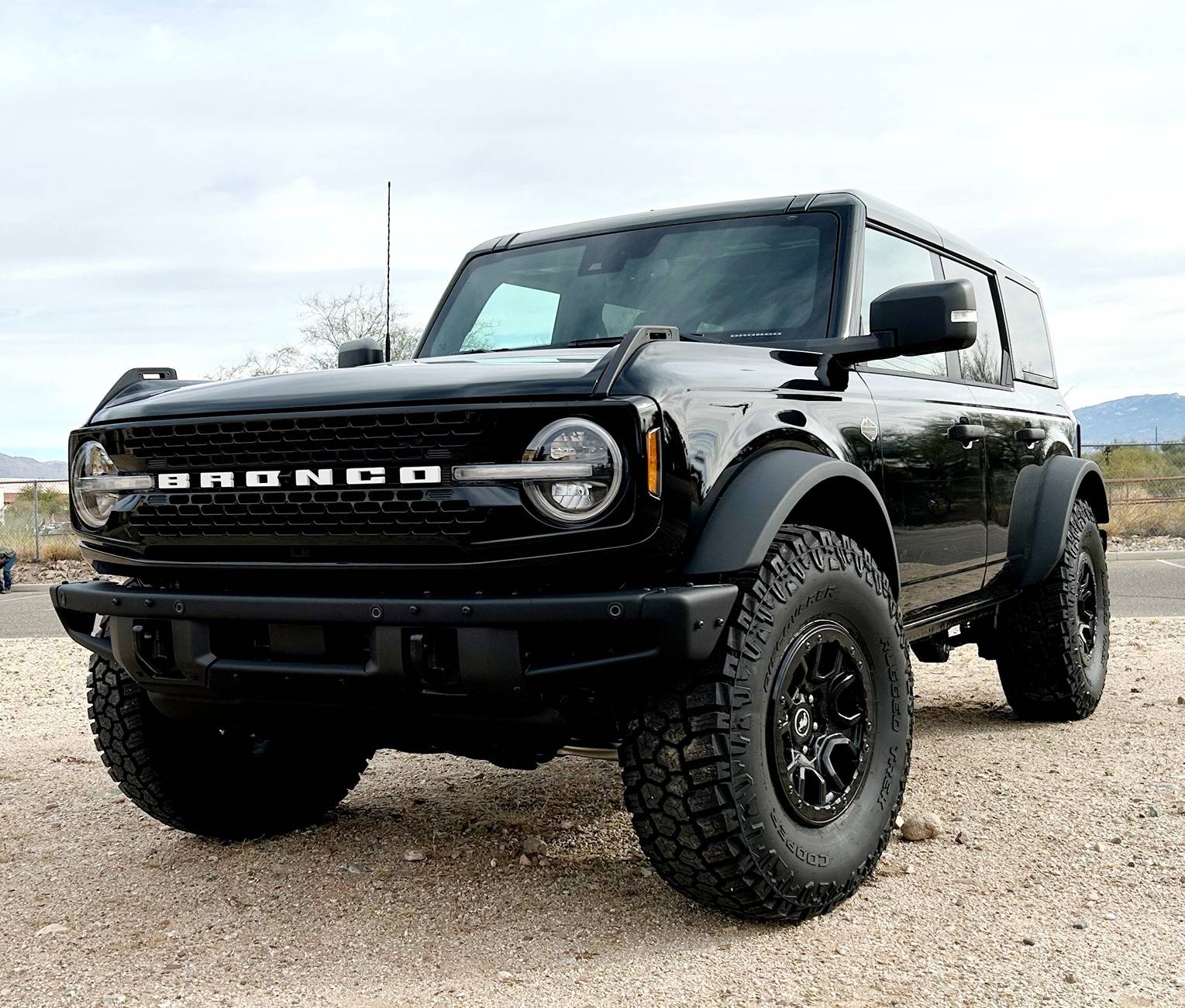

Nope I love mine. Added a Pulsar XT piggyback tune for more power to turn heavy tires and also correct the speedometer. I lost about 1-1.5 mpg with 37s, but I can live with that.
Nice looking 2dr! :cool:
It's funny about the mpg loss; I went to Maxxis Razr M/T's at 35" (34.8" new), which are also wider in reality than the stock Sas tire. Weighs (I think) 72lbs? And at 38psi, I lose about 1.5-2mpg, kind've a wash without messing with the speedo setting. At 32psi, I lose about 3-3.5mpg. I feel less of the loss was the tire weight and instead is due to the road grip/wider tire.
Not that there isn't loss from weight (I can feel the engine needs more oomph to get them going), but that these grippier tires can make a bigger difference. Maybe I'll get the Razr A/T's next and see if that holds up or not (they are like 65lbs).
